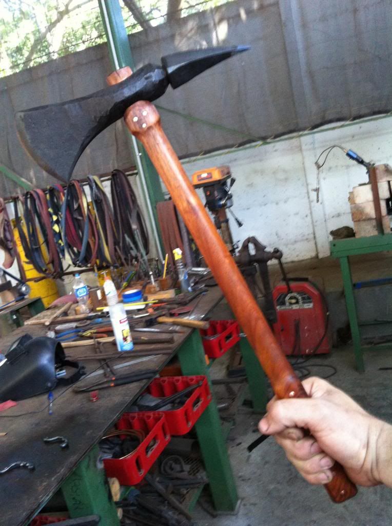

This first started as a "zombie killer" project. Initially I just wanted to demonstrate to my students how to punch a hole in large round stock. After the hole was punched I just went ahead and forged out a cutting edge and then a skull-puncturing spike on the other side (perfect for killing zombies) This was forged from 4140 so it's not super hard but I guarantee that if you use this on a zombie it will do what it's intended to do.
The wooden handle is made from some indigenous wood from here in Nicaragua. It's called Guapinol.

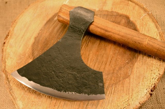

The next is a viking axe that I made with my students. They are a lot of fun but lots of work too. It started out as a block of mild steel 1"x 2"x4". There is a piece of carbon steel forge-welded in as the cutting edge.

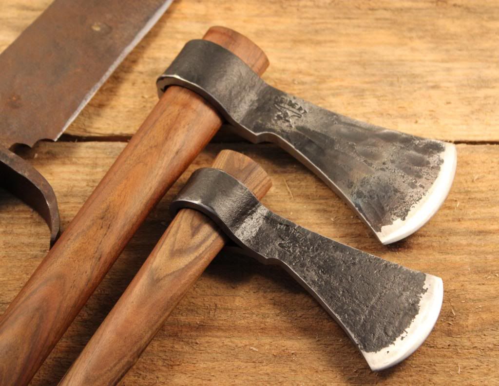

The last pic is of a set of hawks that we make. We call this set a "Father and Son". One is a regular sized throwing hawk and the other is just a little smaller.
