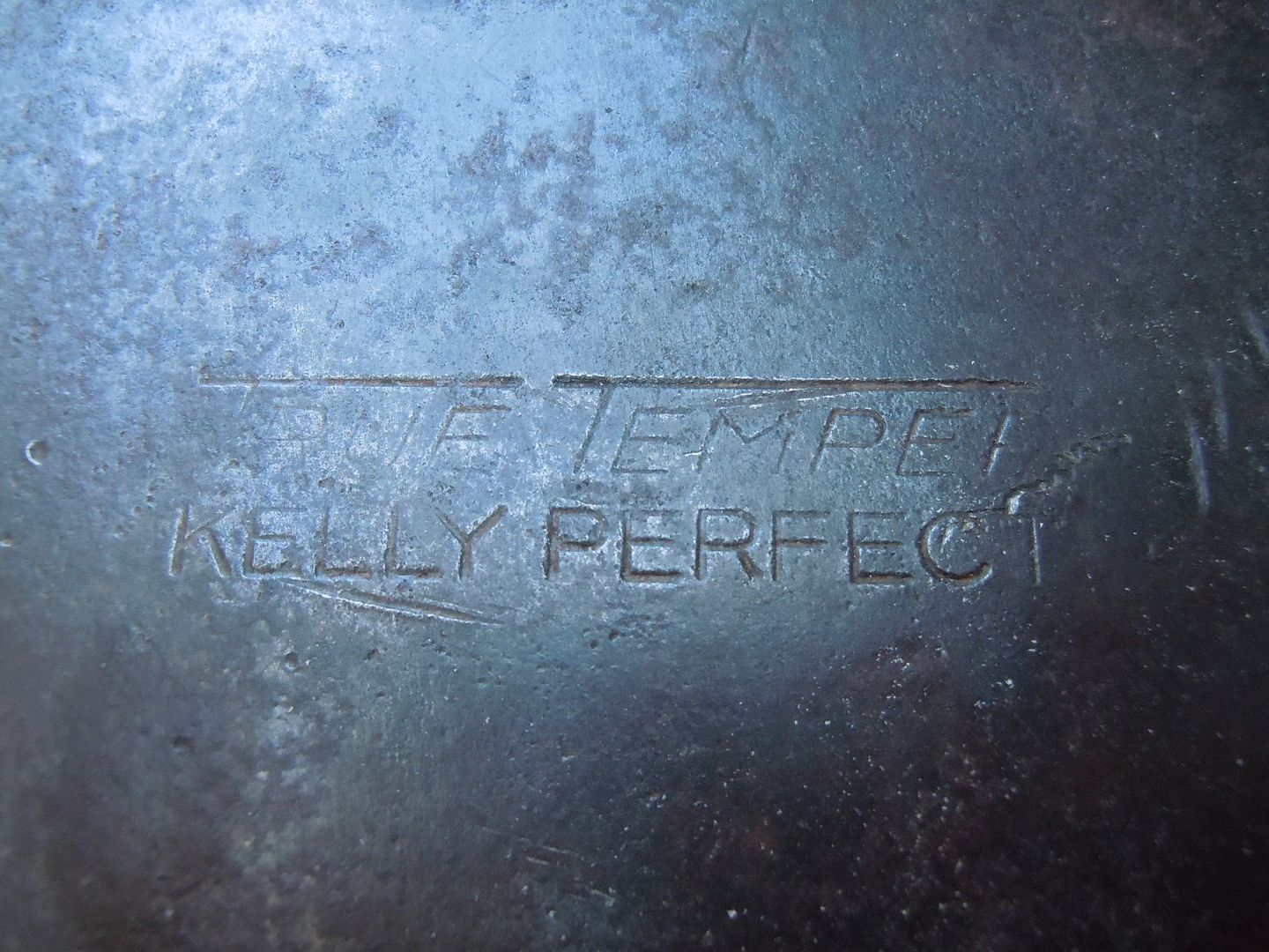

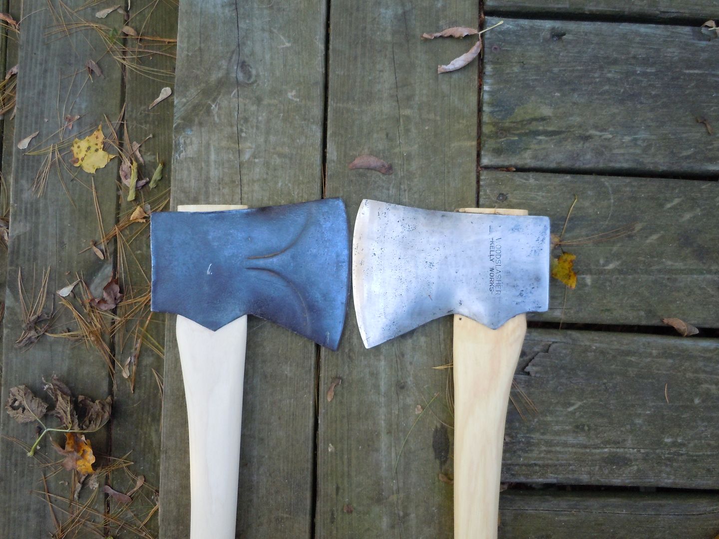

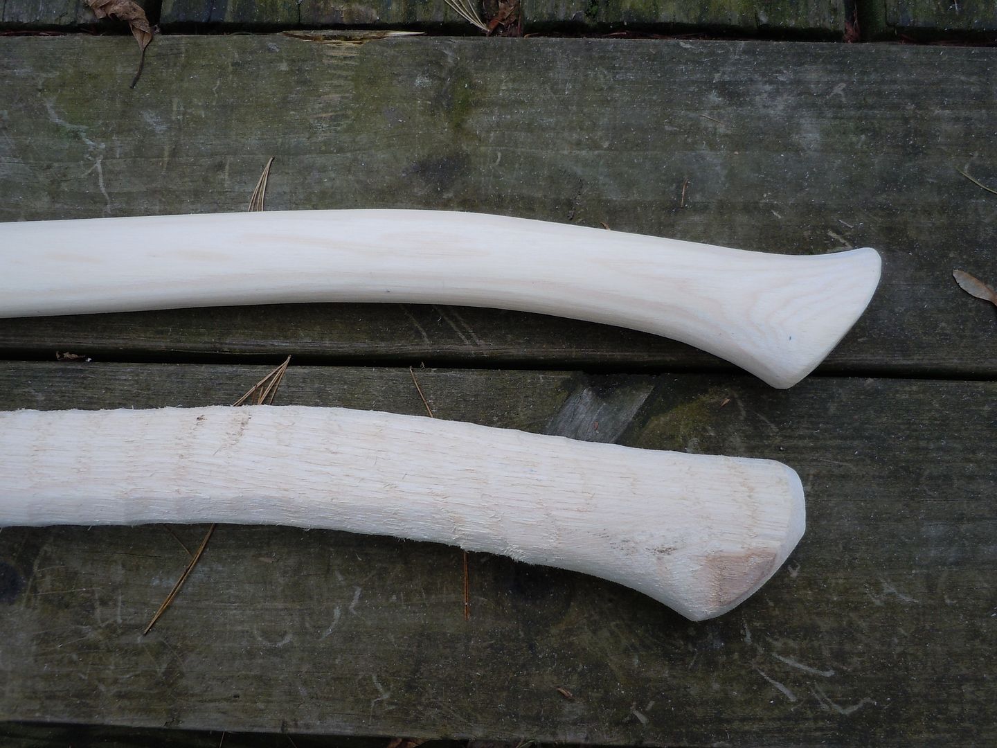

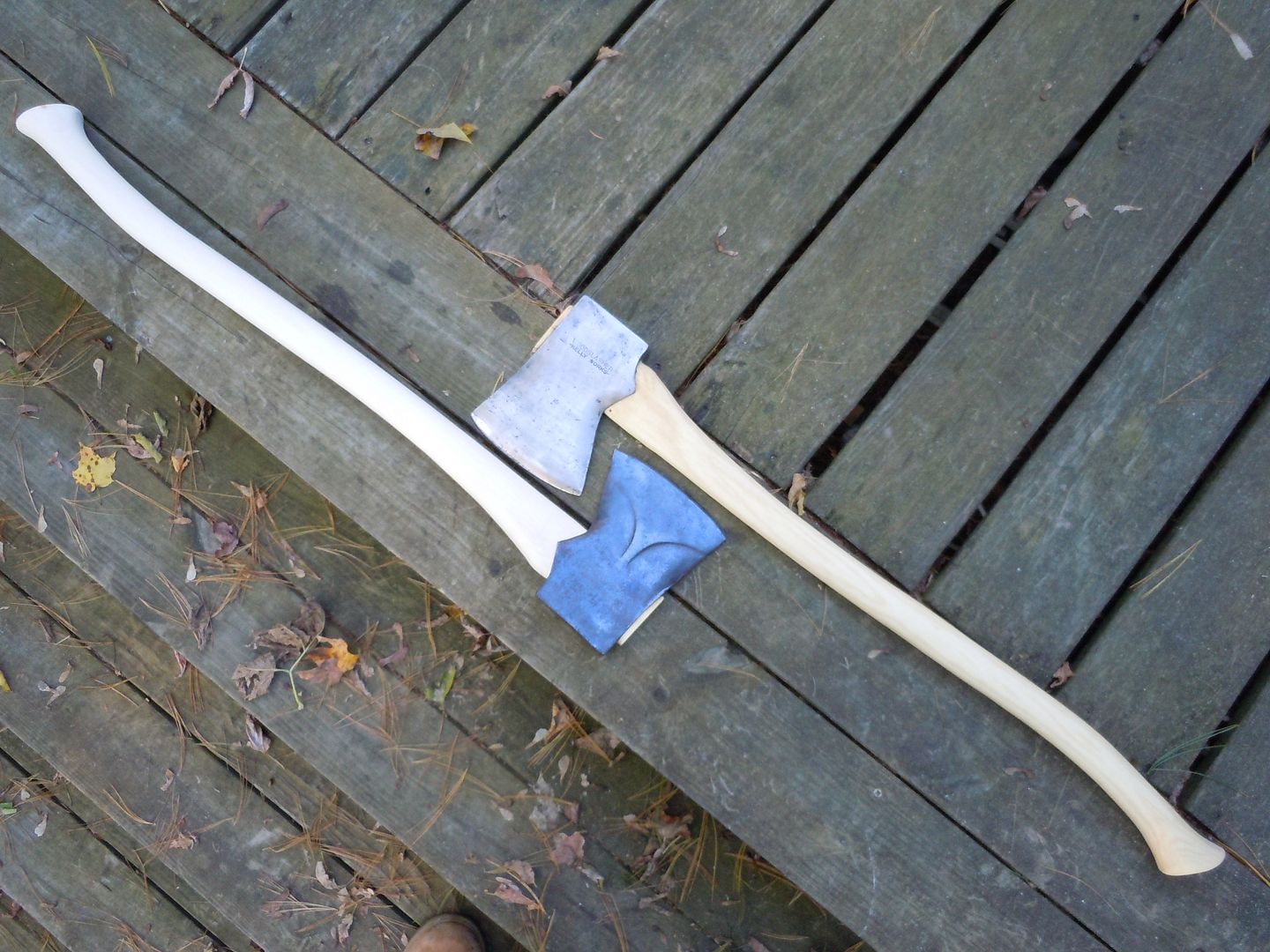

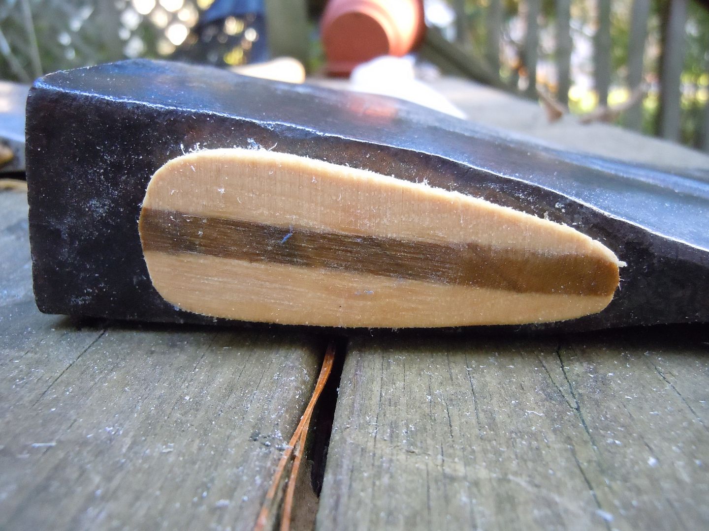

Both True Tempers. Both Jersey Patterns. One is beveled, one is not.

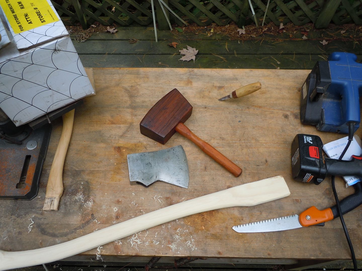

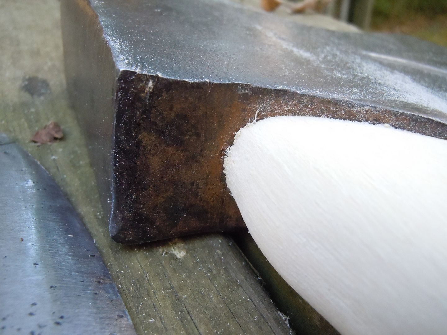

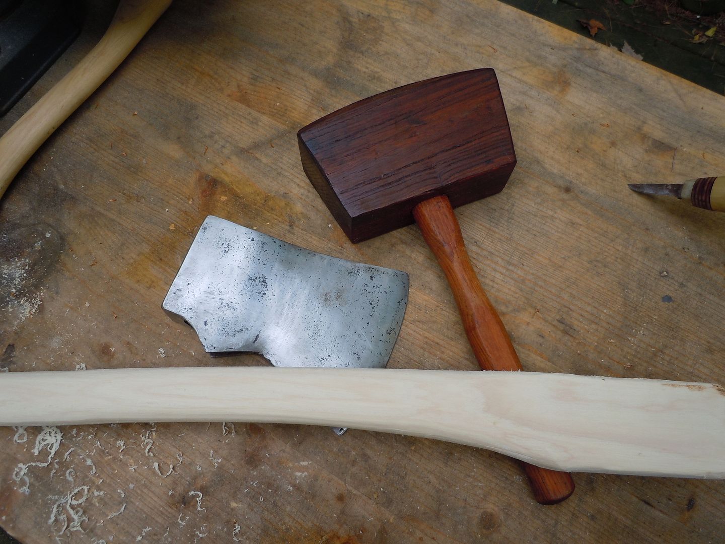

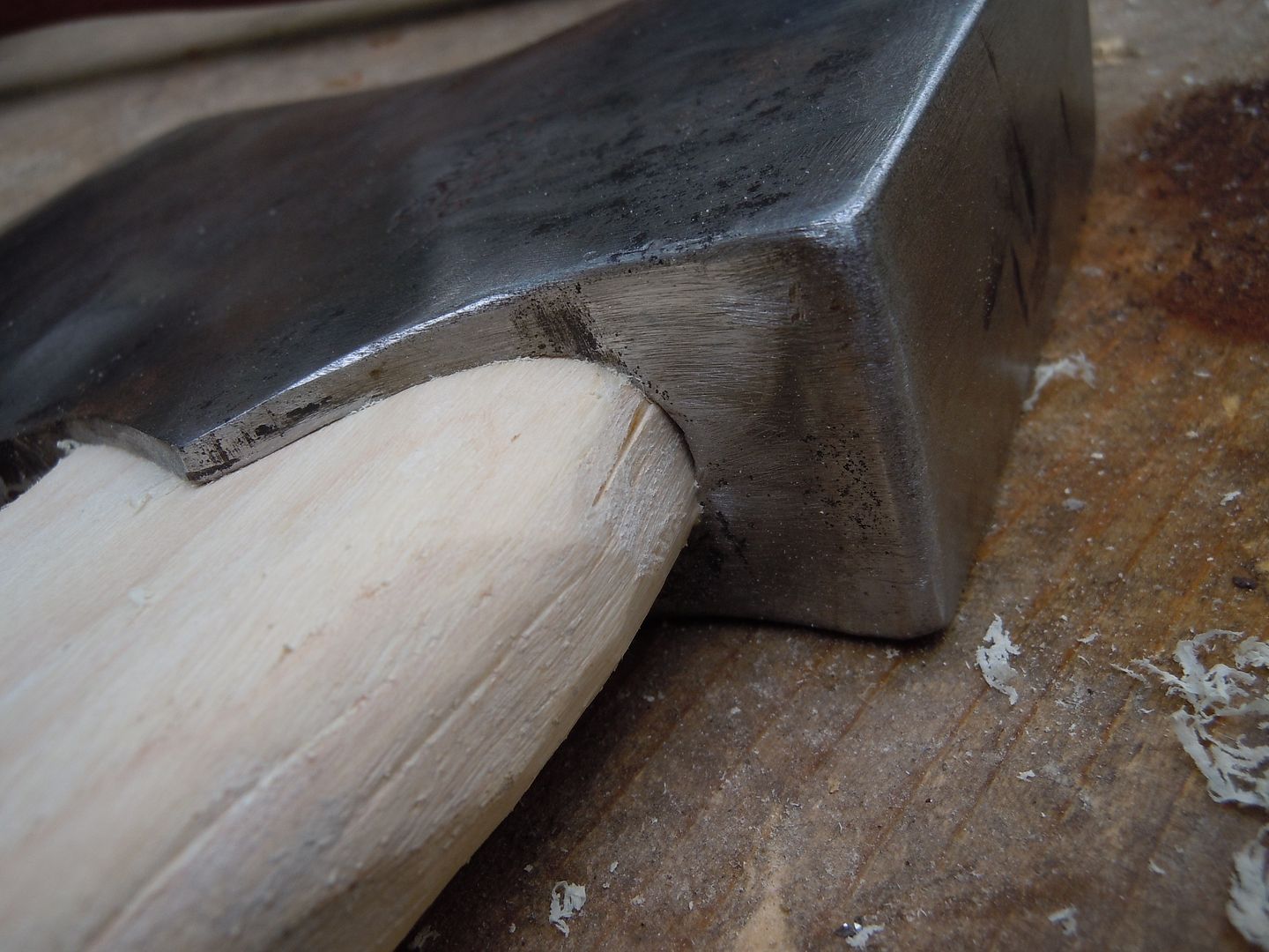

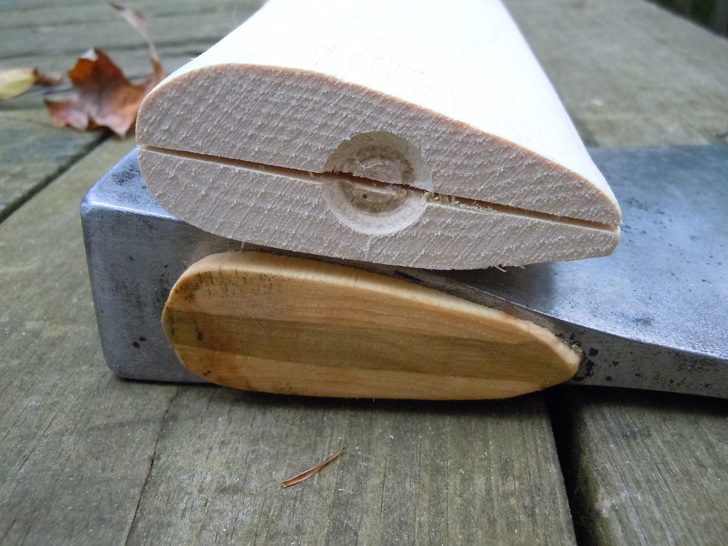

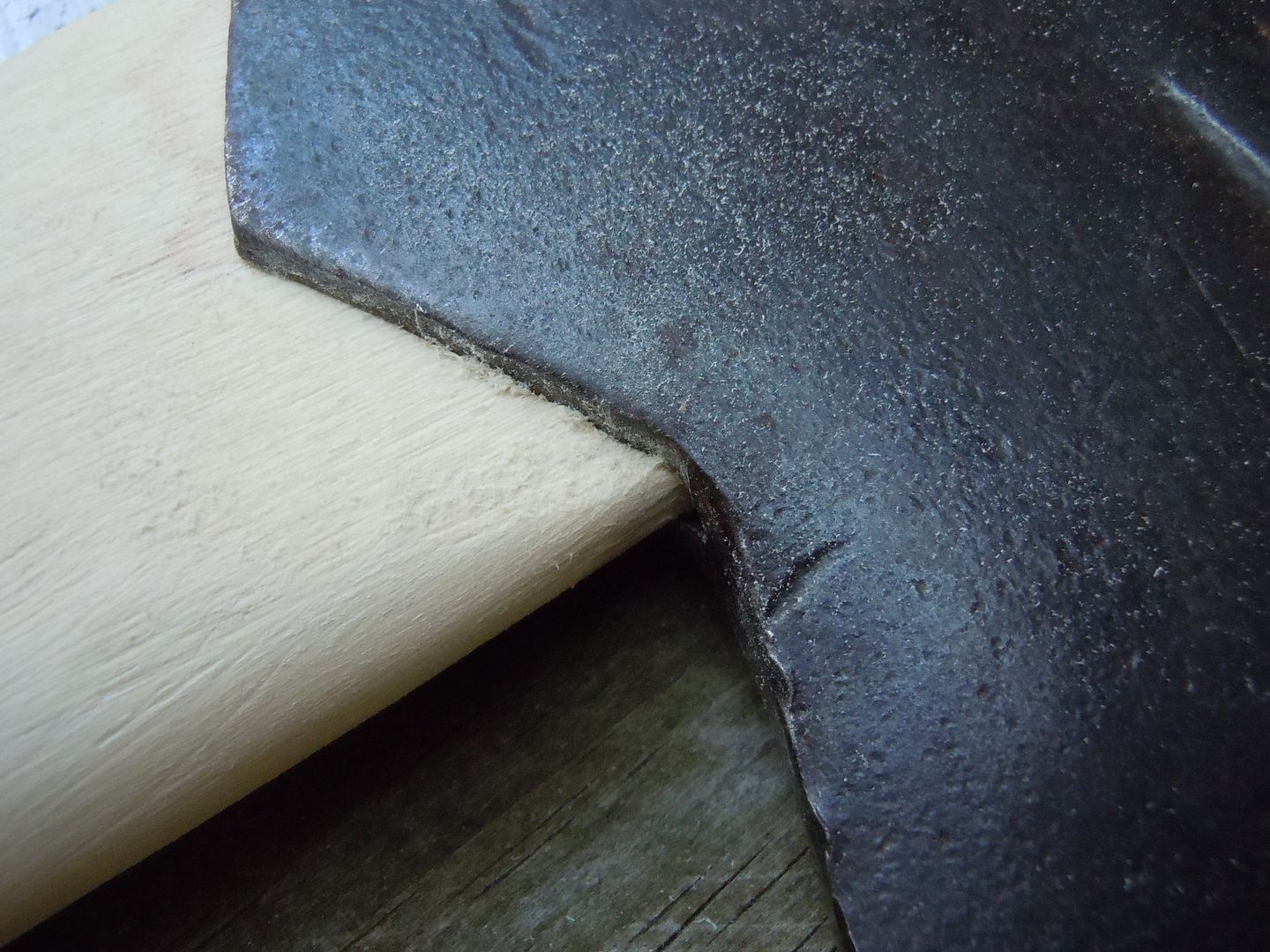

Had to buy a racing axe handle to get a proper fit. Took some sanding down, but I got it in there.

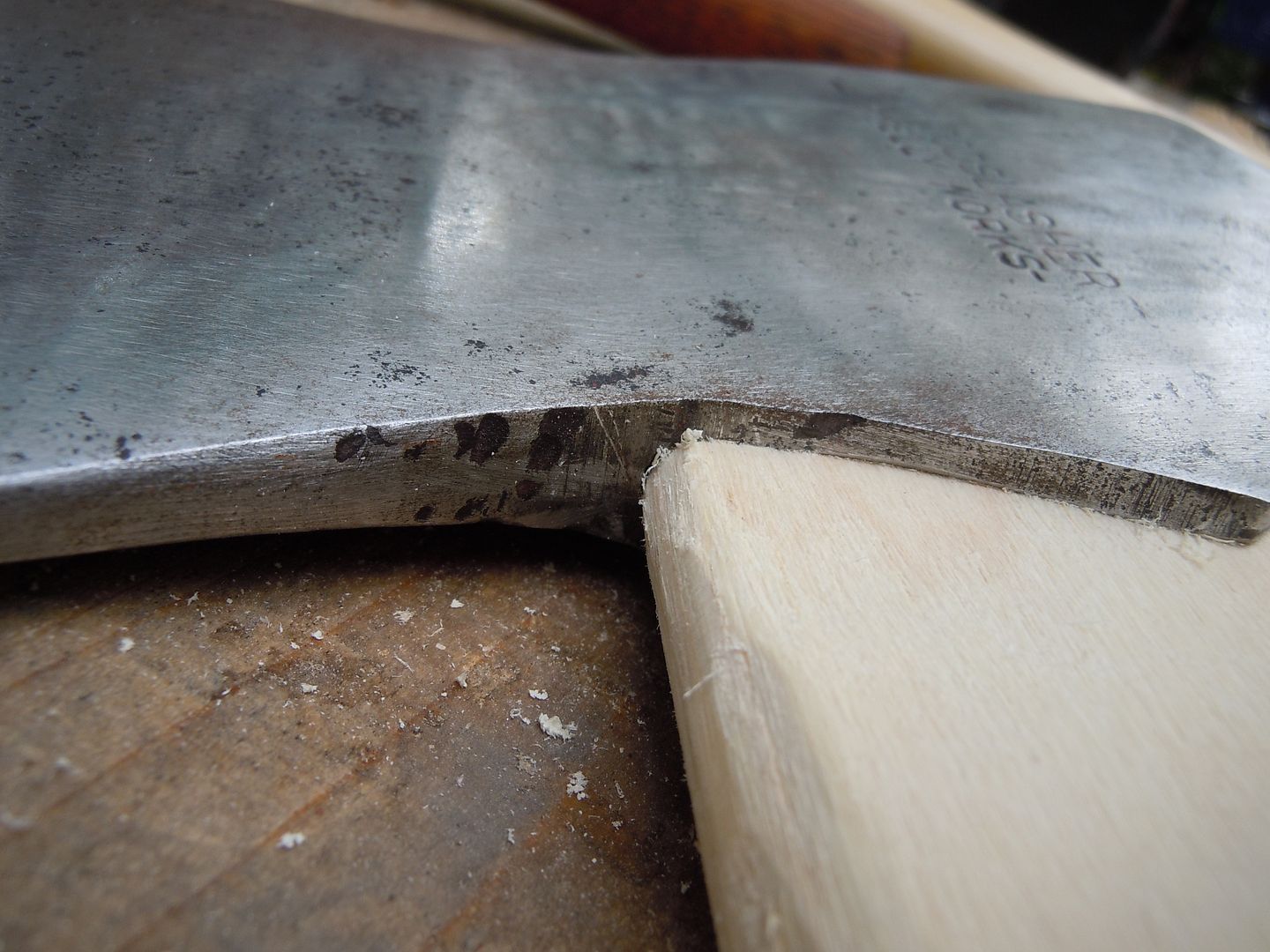

After some serious sanding, I got it down to true up. The new mallet really drives the neck into the eye hard. Makes for good fitting.

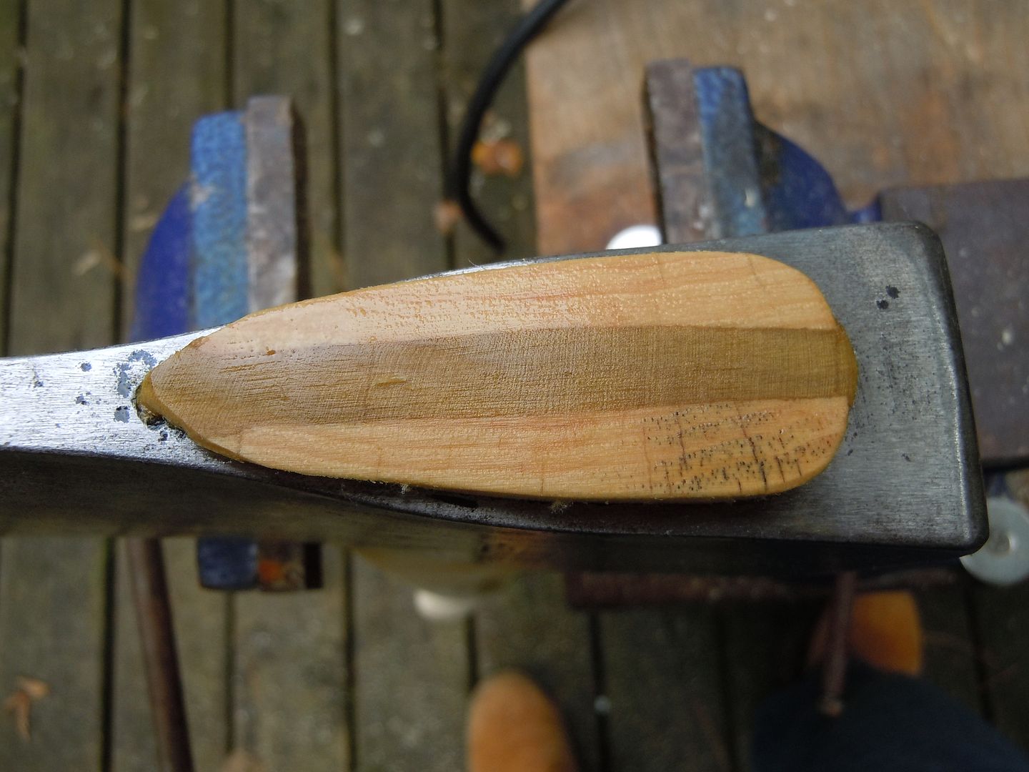

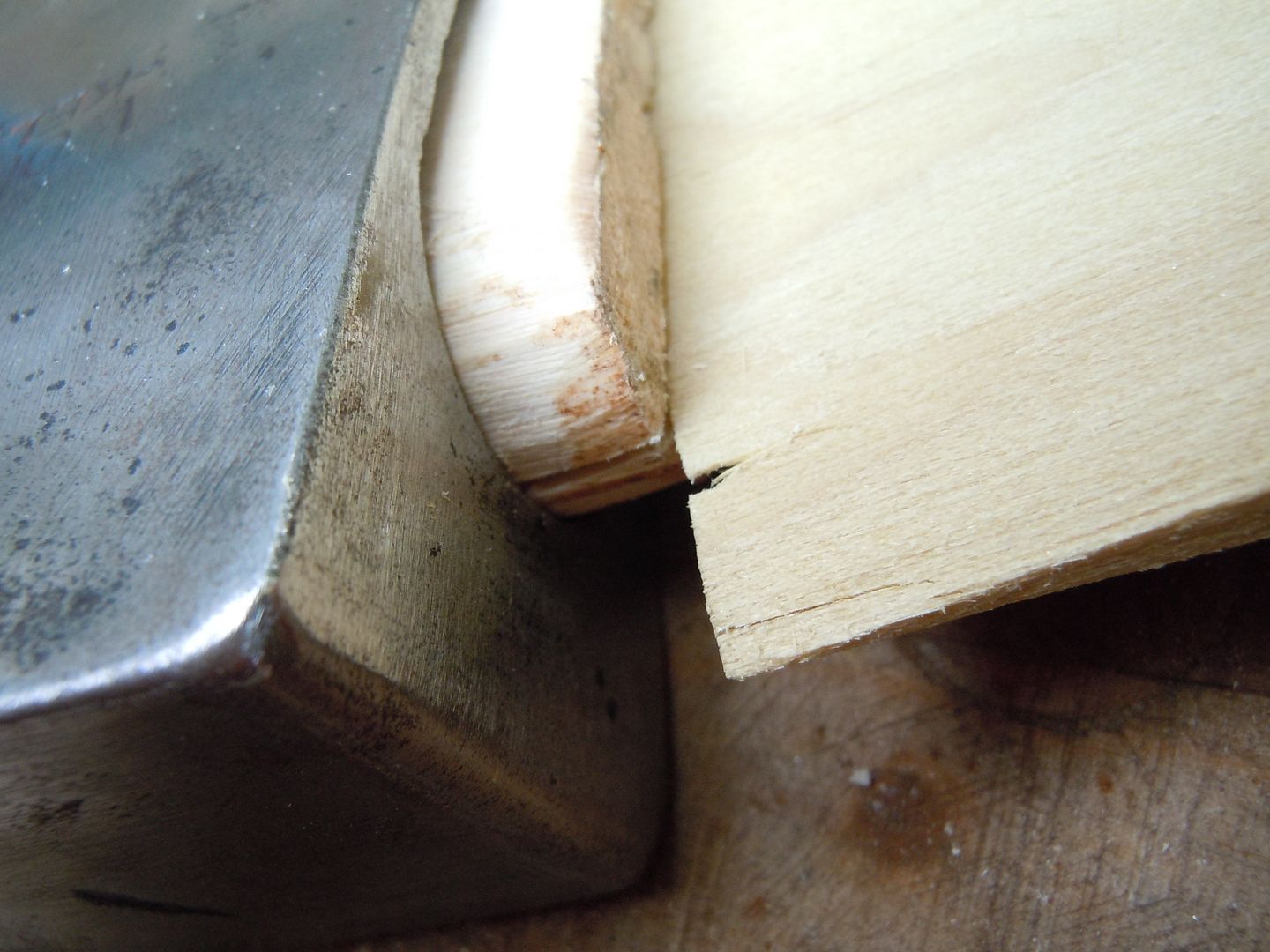

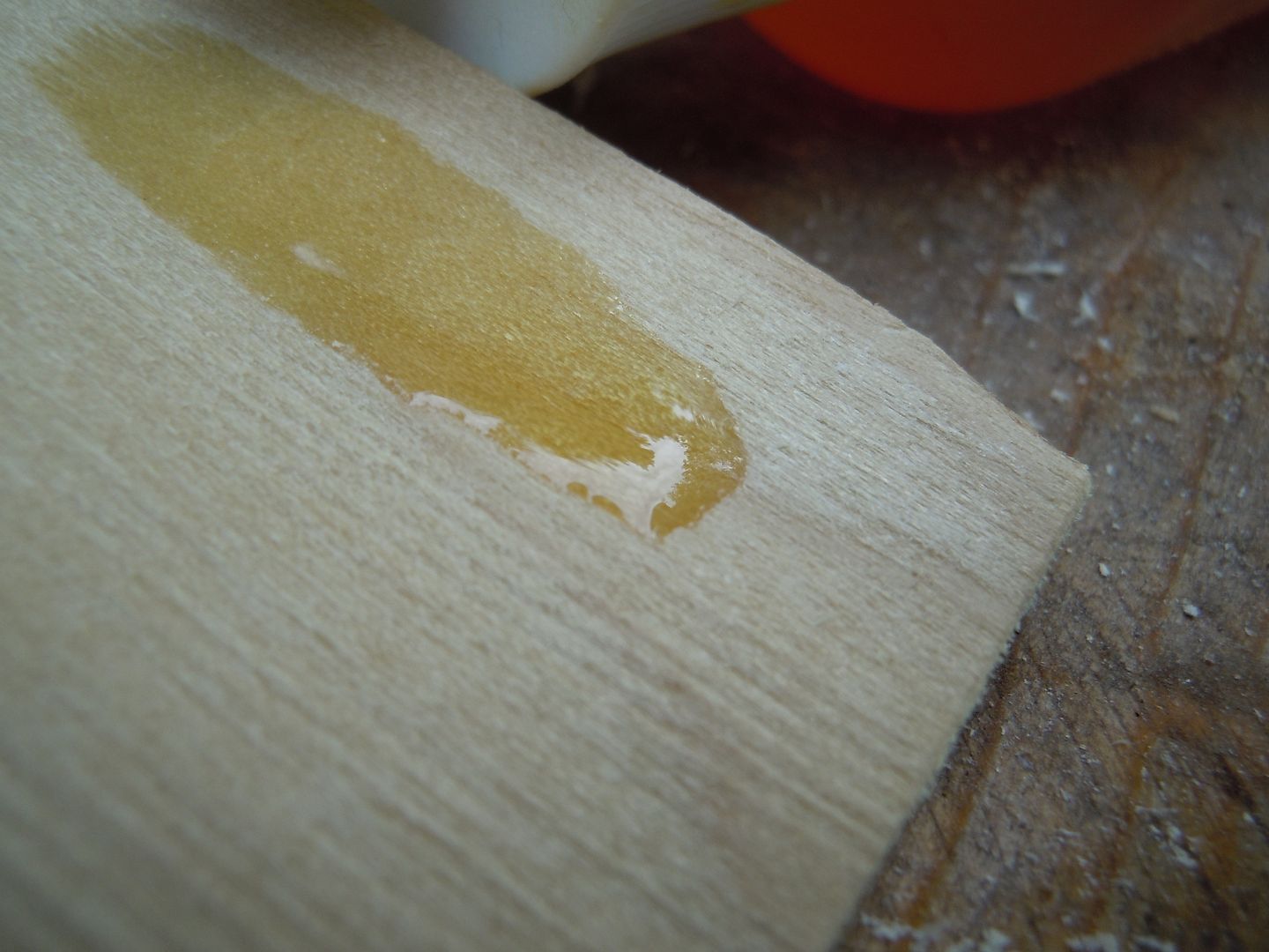

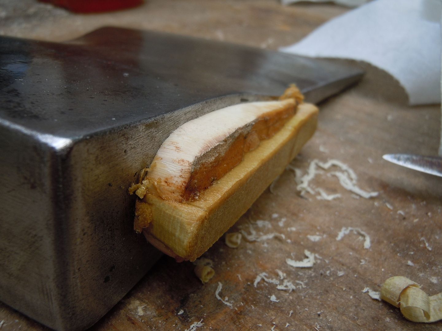

Sizing up the wedge.

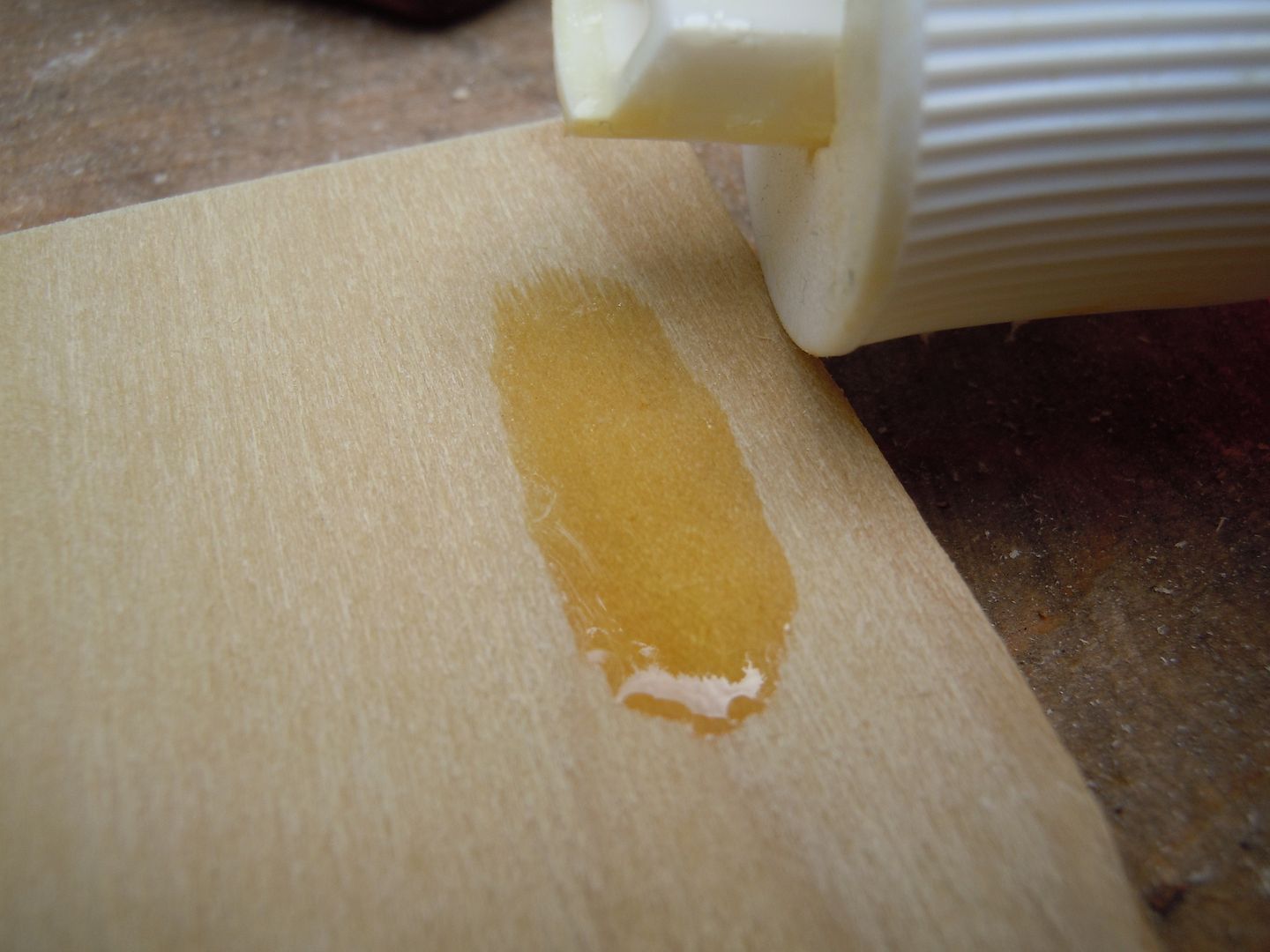

Lets get some oil on that wedge, the way you like it, then drive it home ;)
Went it real tight ;)
Cleaned it up.

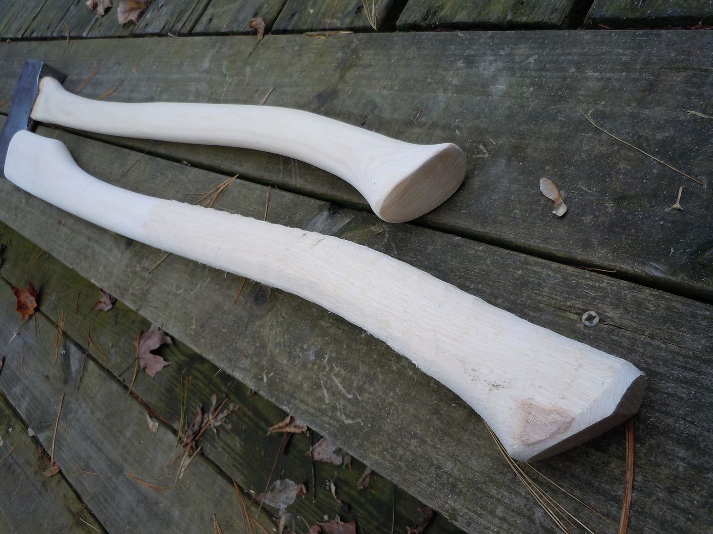

I like scraping now more than sanding, works much faster.

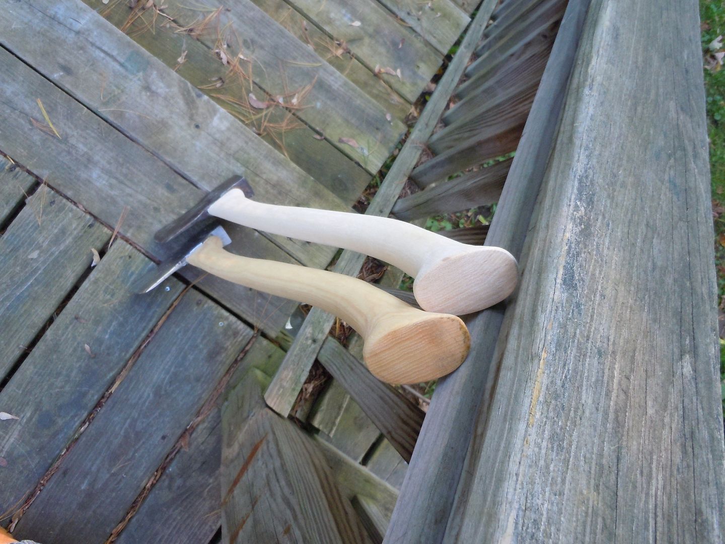

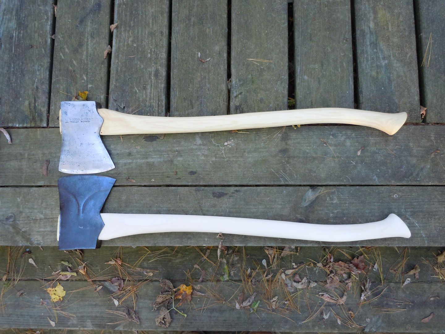

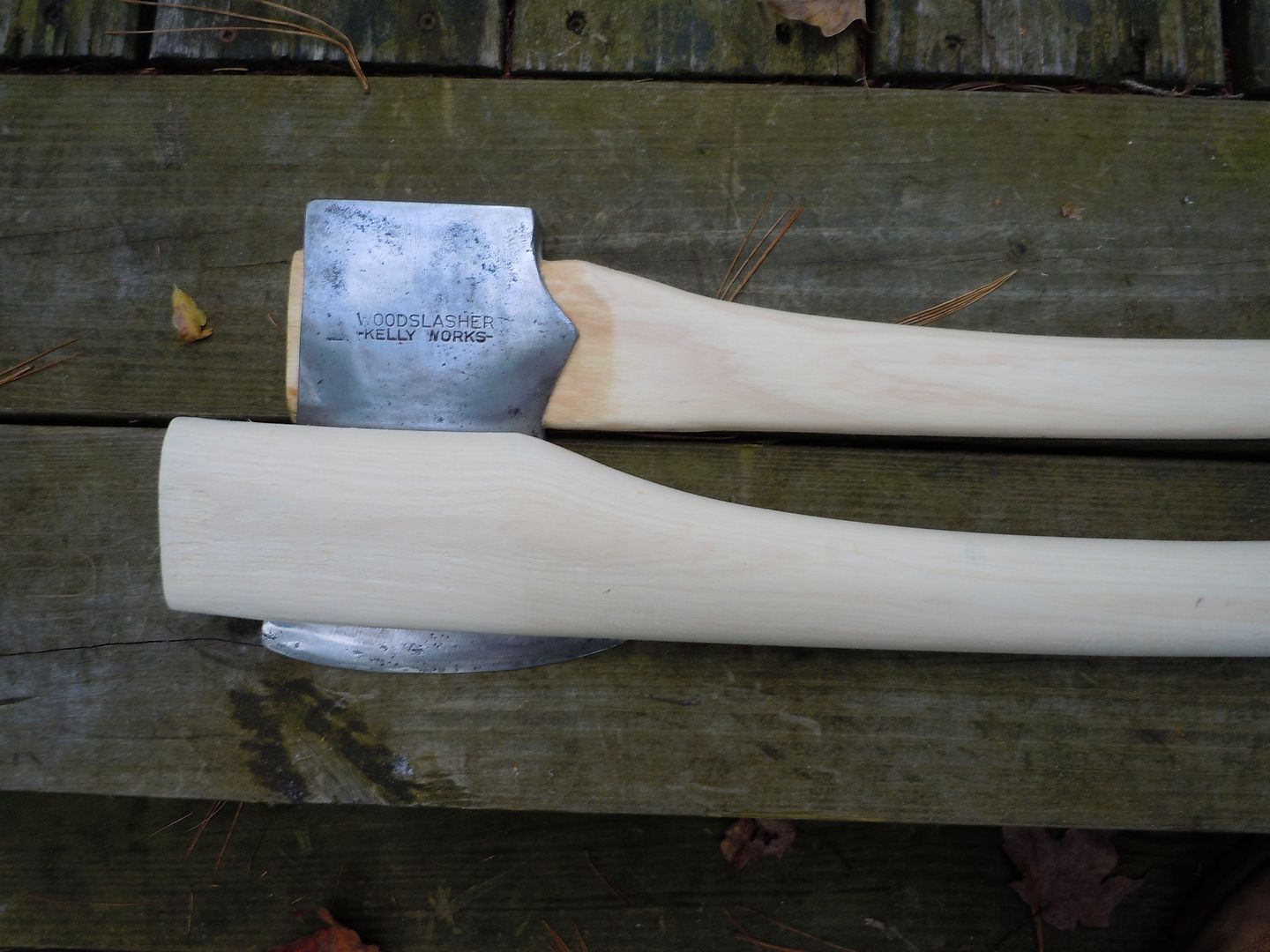

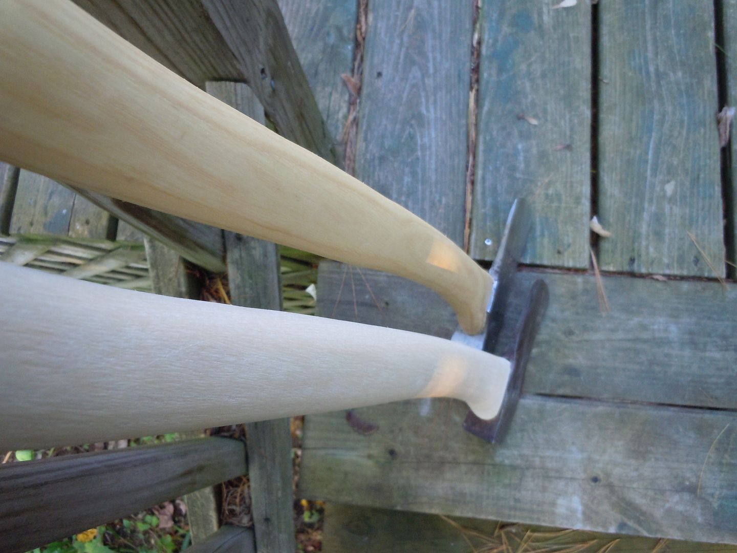

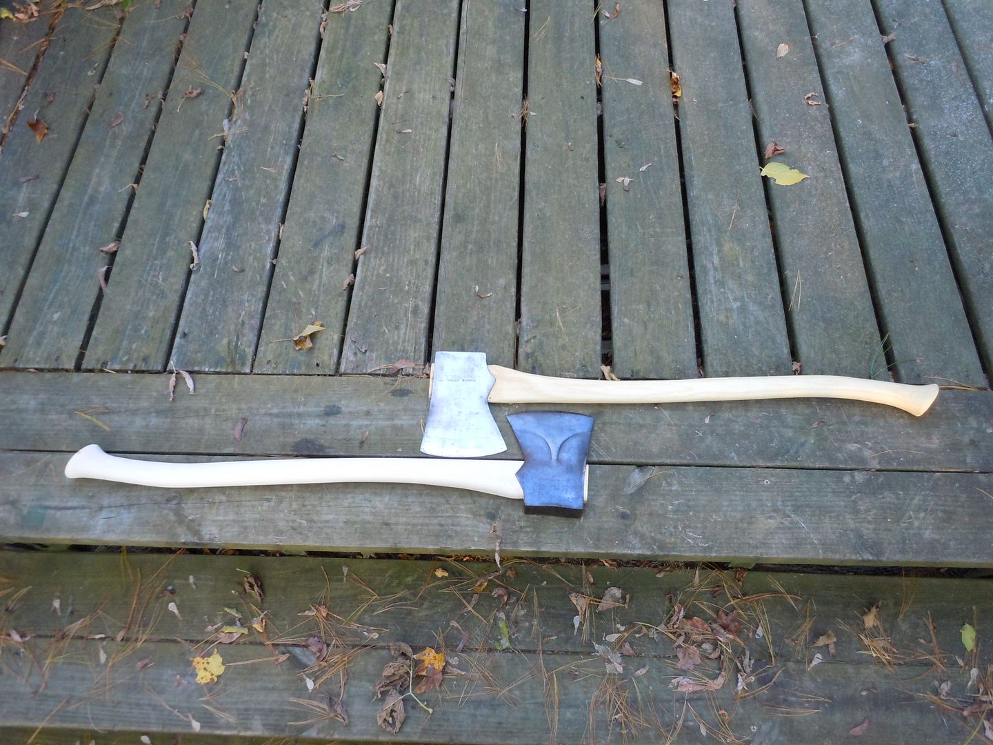

Some finished shots compared to how the handle looked when we started. It has a new shape now.

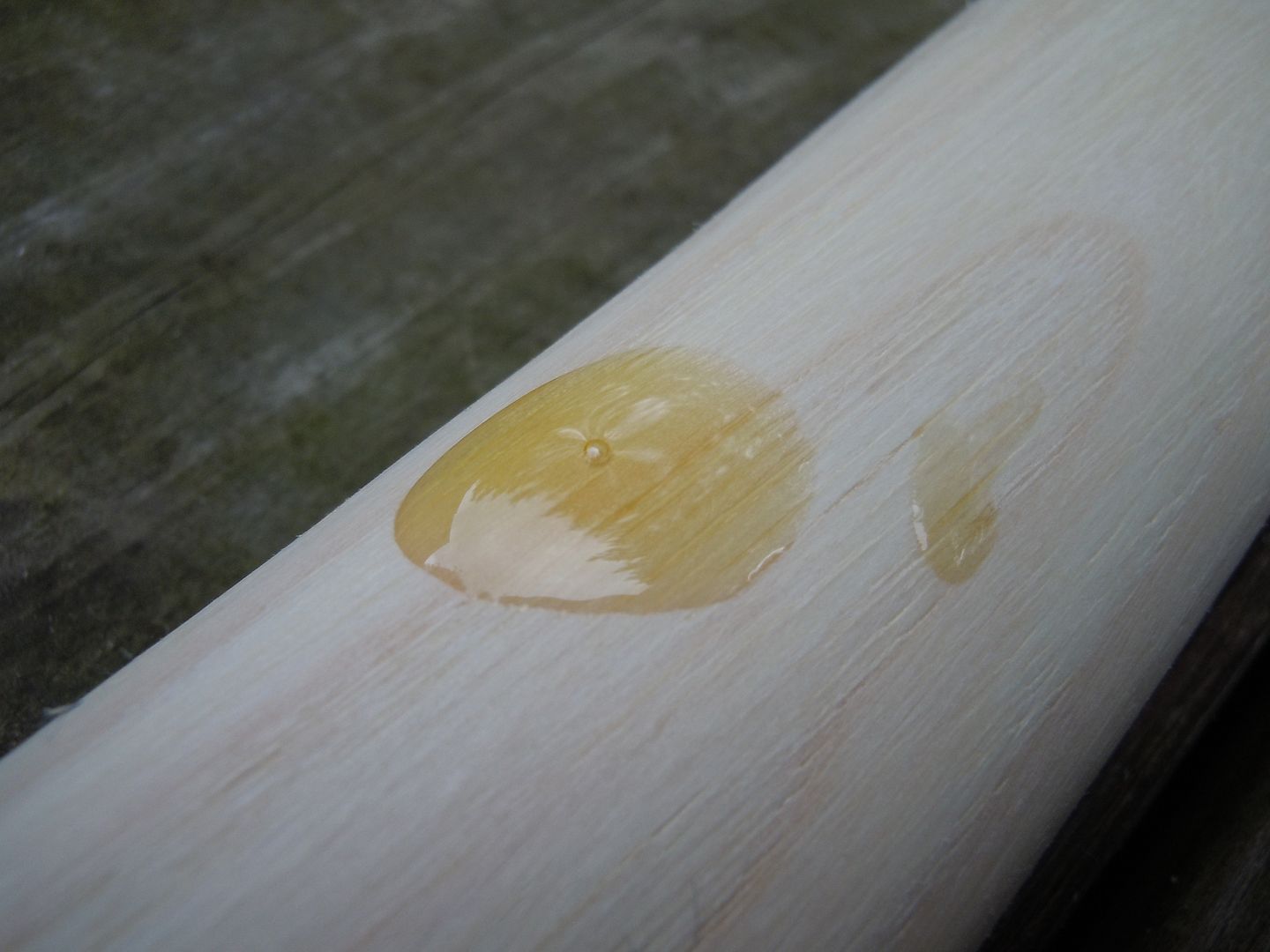

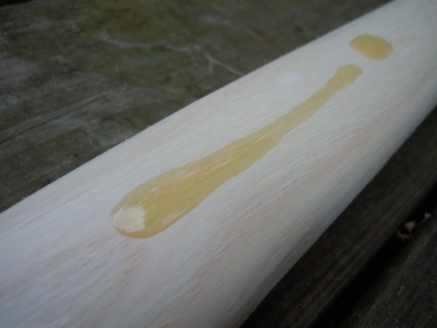

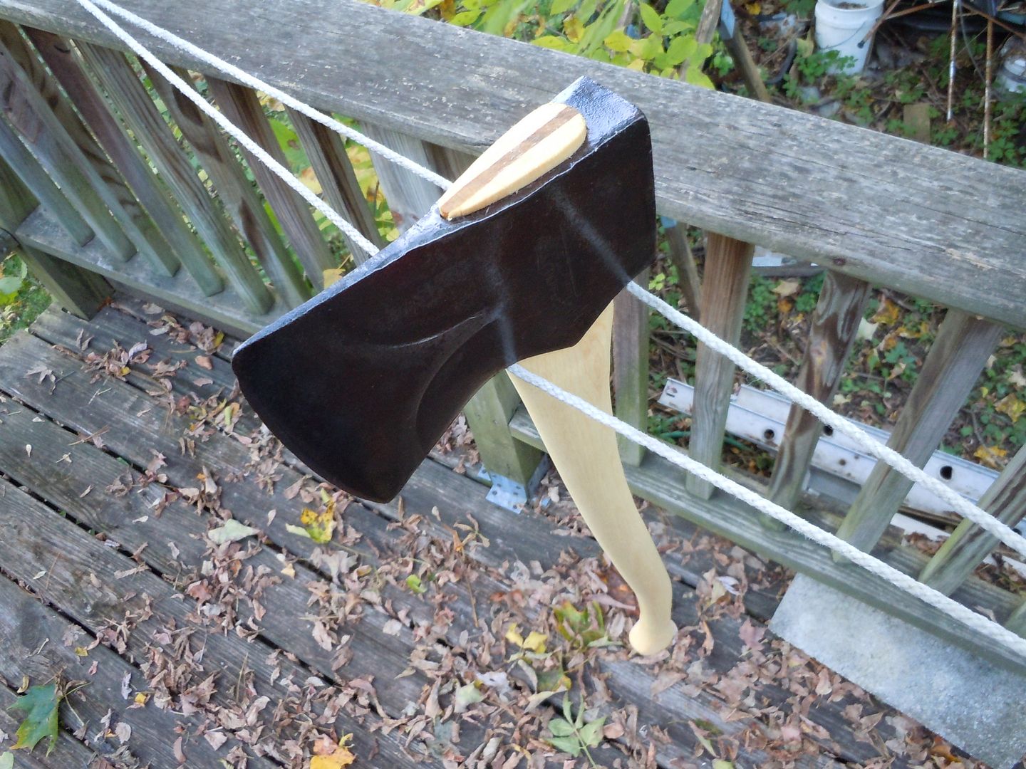

Oiling her leg up.
Out to dry.

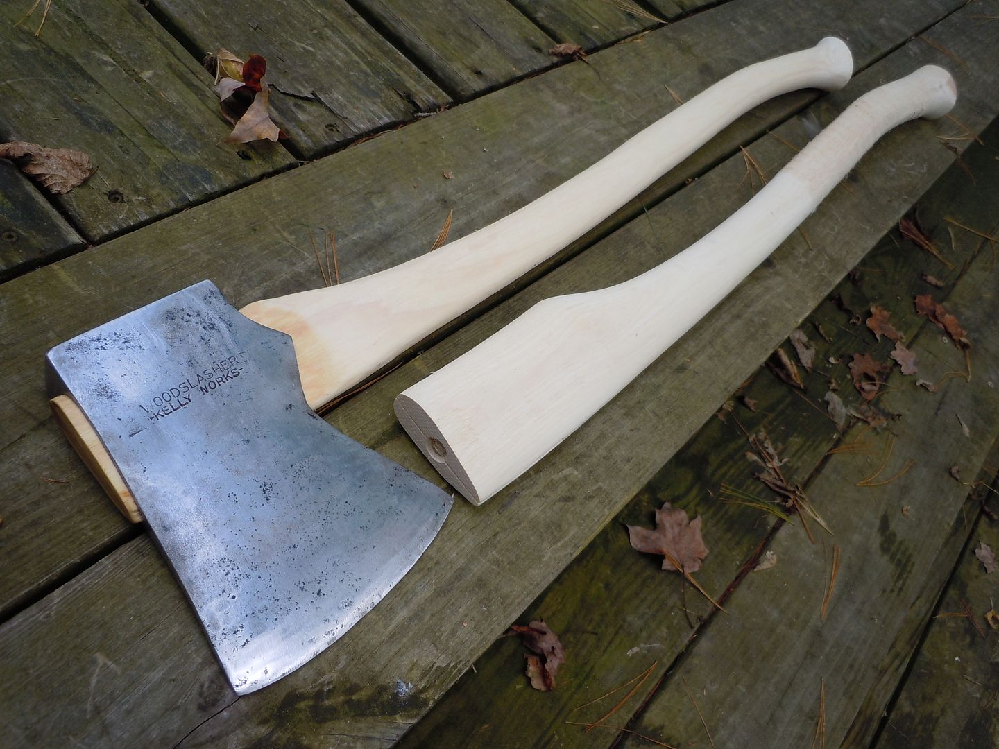

Once again the handle took a lot of working on the sander to get to shape.

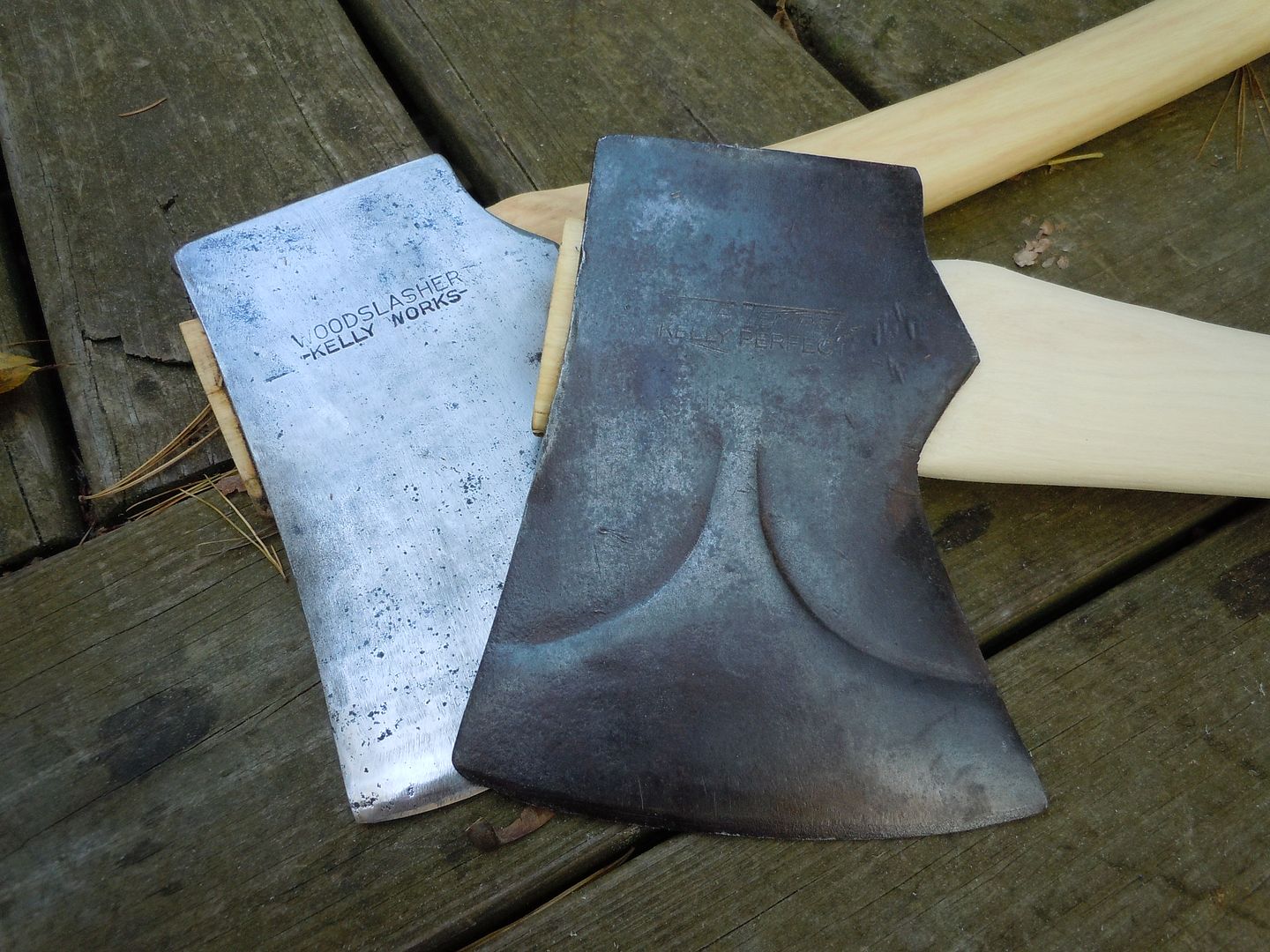

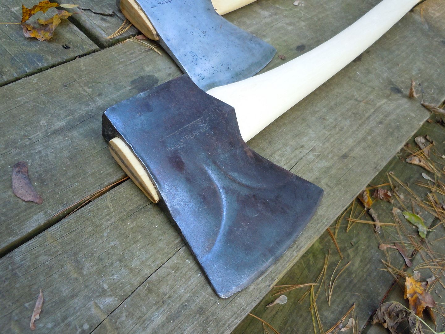

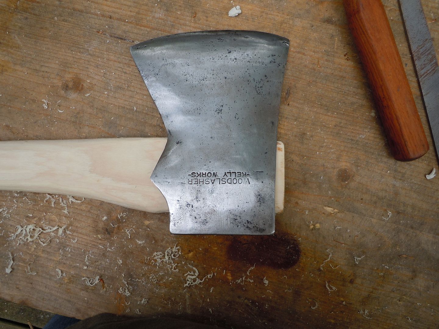

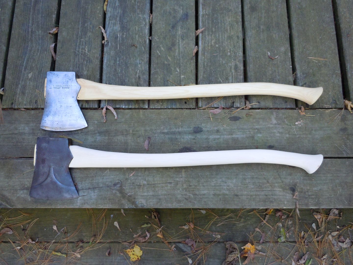

I left the head with this beautiful patina on it. Going to need some edge work though.
Adventure Sworn came over to see the wedge drove home and finishing touches on this one.
Oiled and out to dry,
What type of sander do you use to shape your handles? Orbital?

Thanks everyone for the compliments! I think I finally have handling down pretty good now. Certainly lots of fun.
To answer your question above, I use a SKILL 4x36" belt sander for most of the shaping I do. Sometimes I will get a handle that needs little work on the neck, so I use the four in hand.
