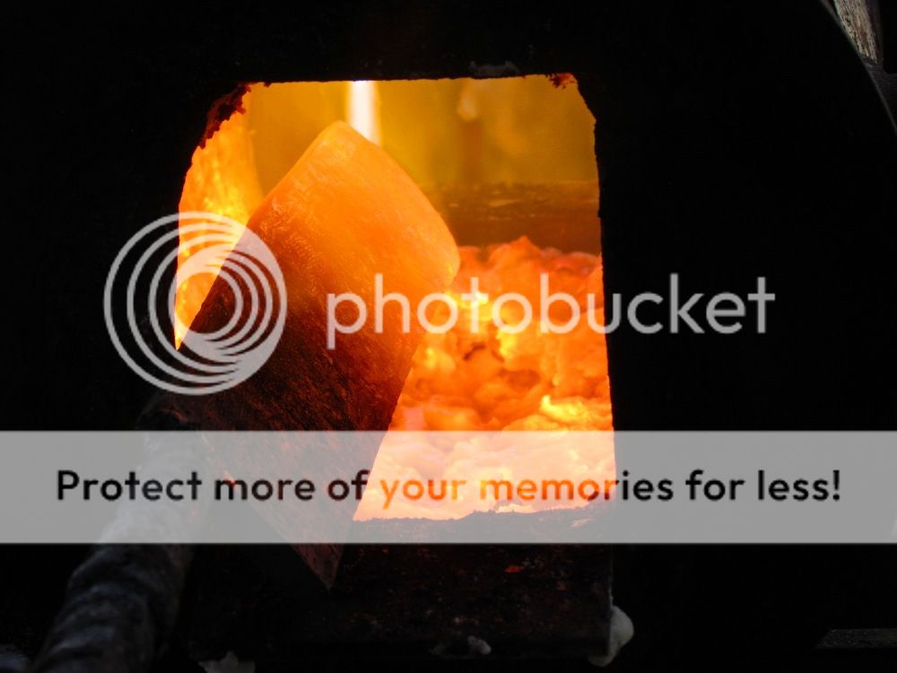

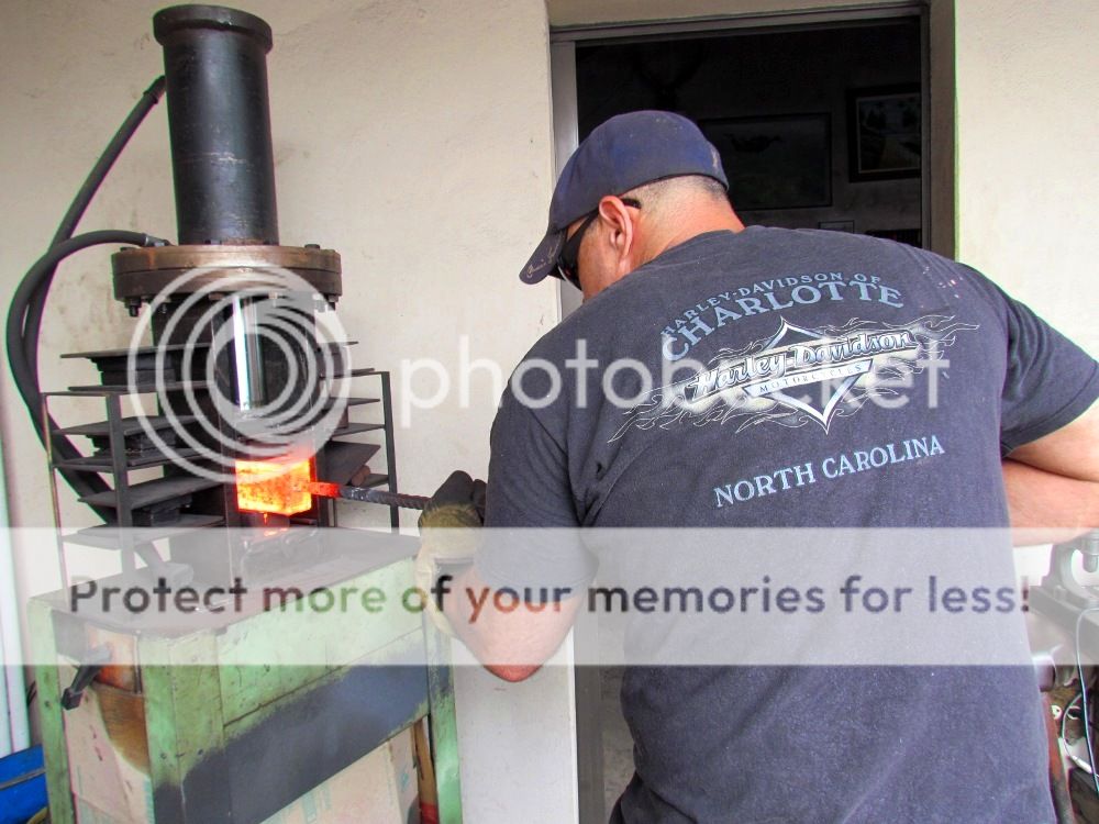

Ready to start the forging
Heating the billet and tinking of my life!

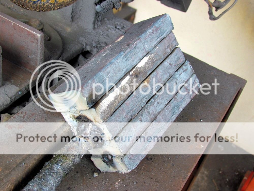

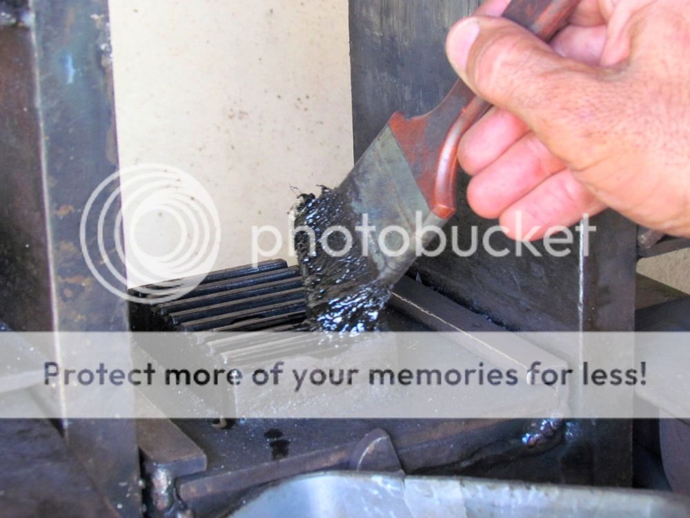

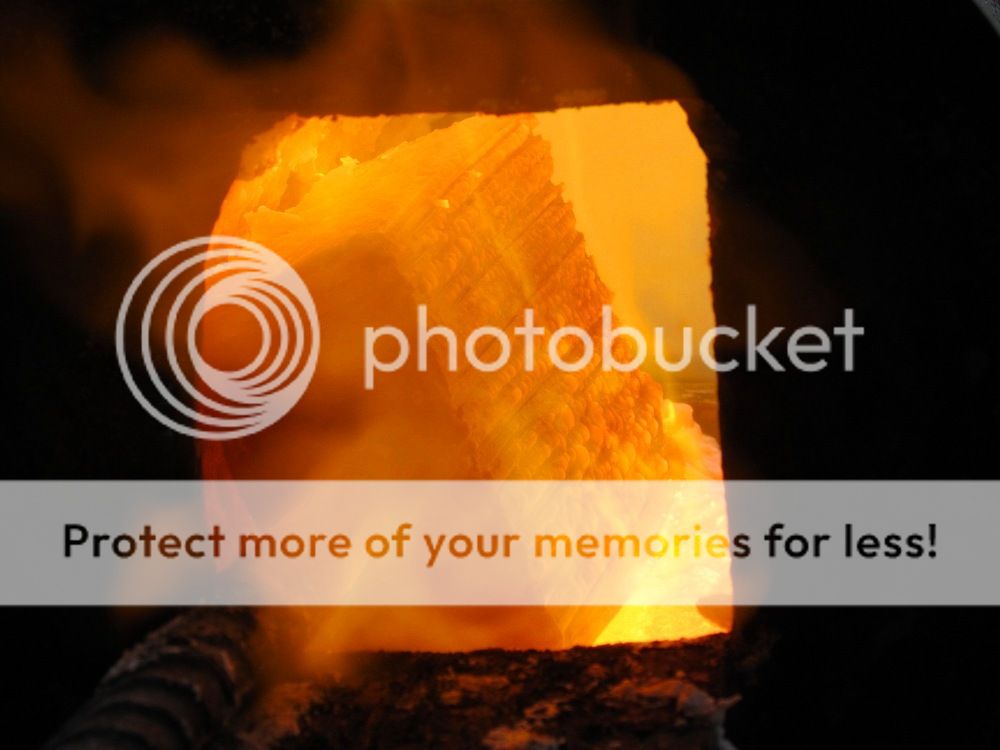

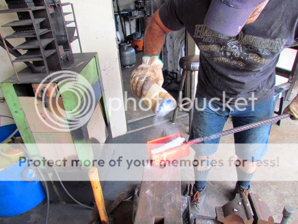

Adding borax (sodium tetraborate). It should be placed before the steel acquires color. Pictured is the second time I had added.

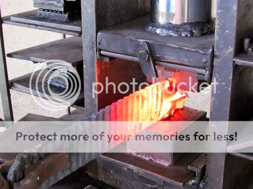

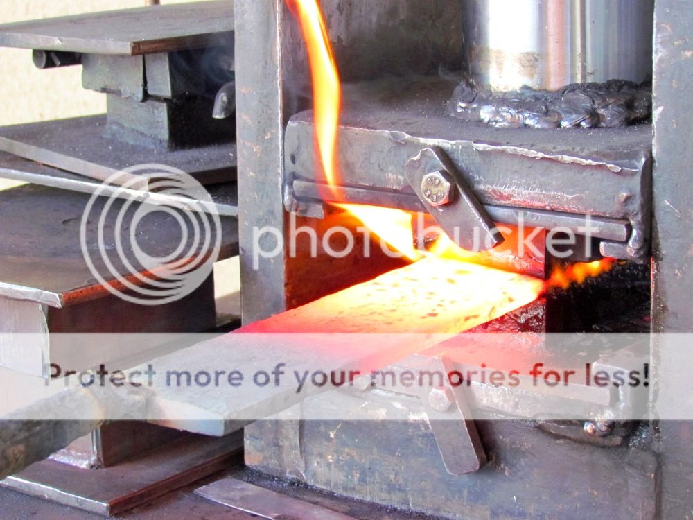

Billet to 1100 ° C (2012 ºF), ideal temperature welding, evidenced by boiling of liquid borax.
Compressing without excessive force and gradually, so that the layers do not slide each other and makes the molecular exchange that results in fusion.
Welding layers.
42 tons press power!

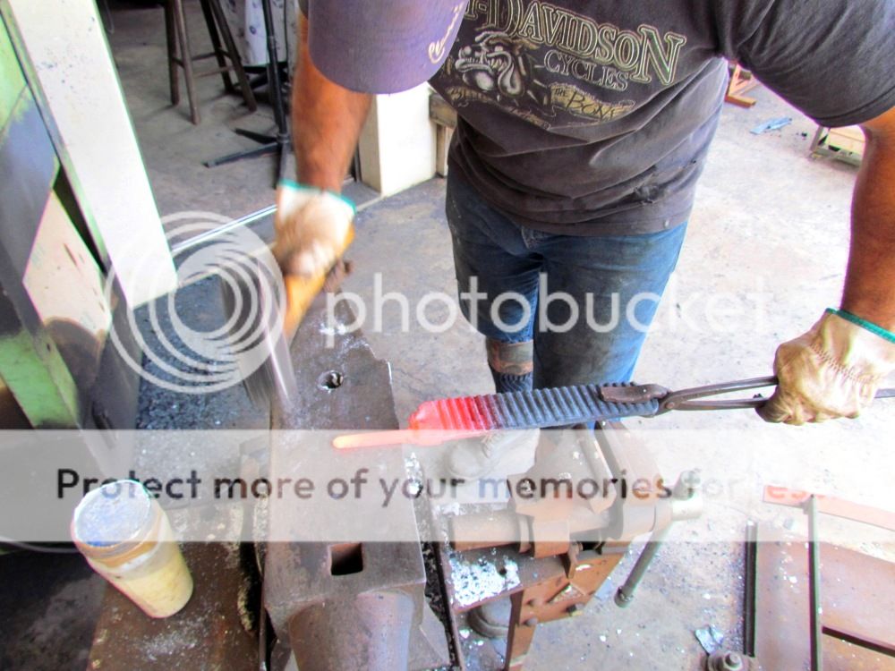

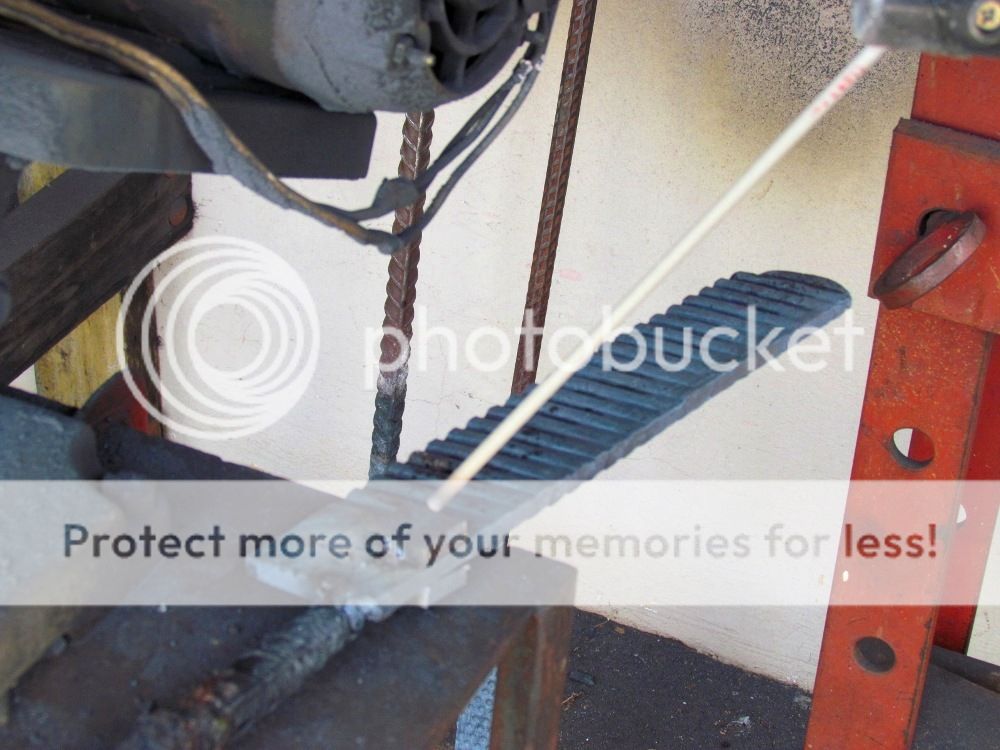

After welded and stretched, I discard the tip of the billet. This eliminates contamination of electric welding between steels layers.
On the other side.

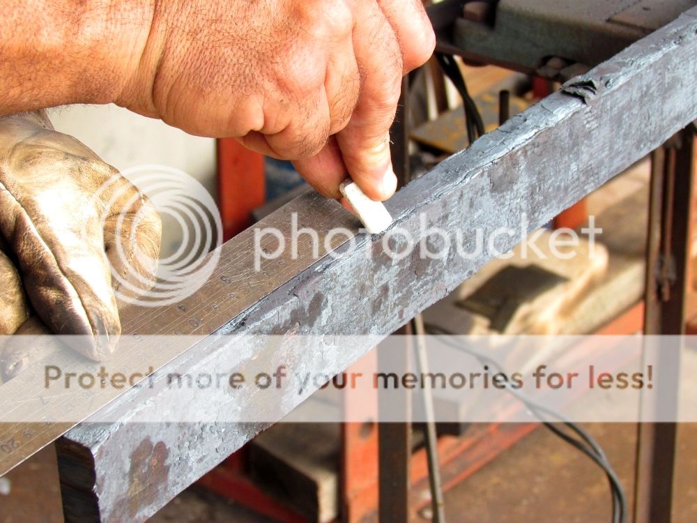

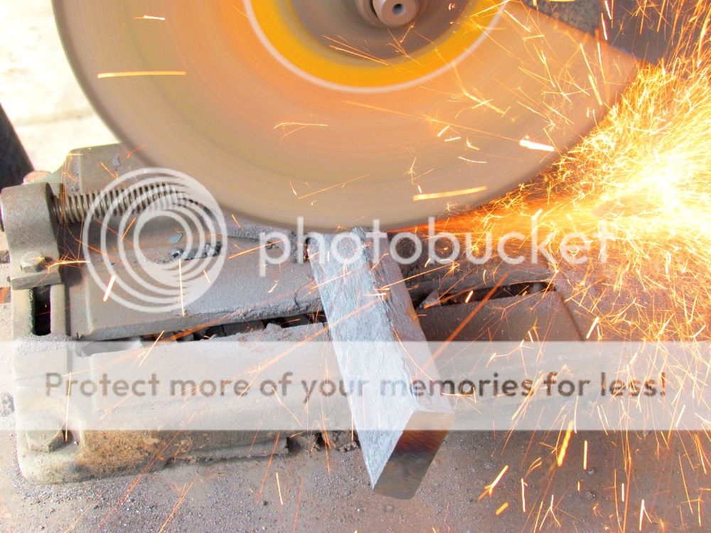

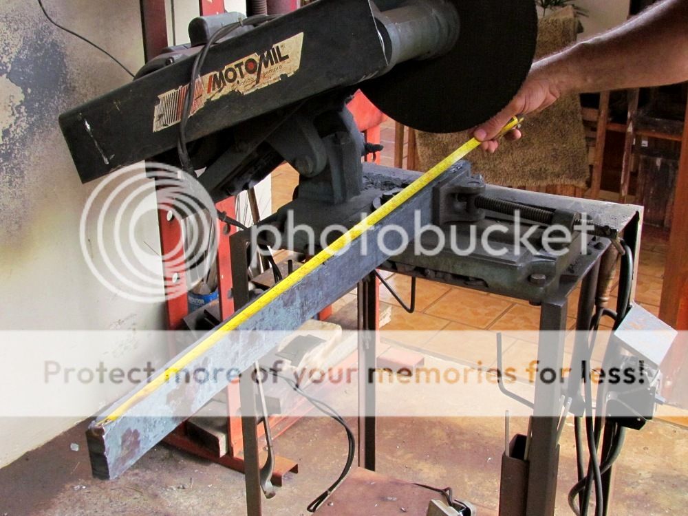

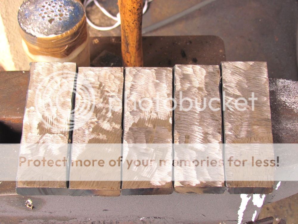

Measuring the total lenght of the billet.
Dividing the billet into five equal parts.

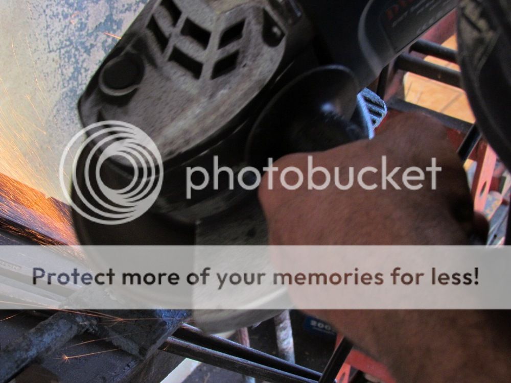

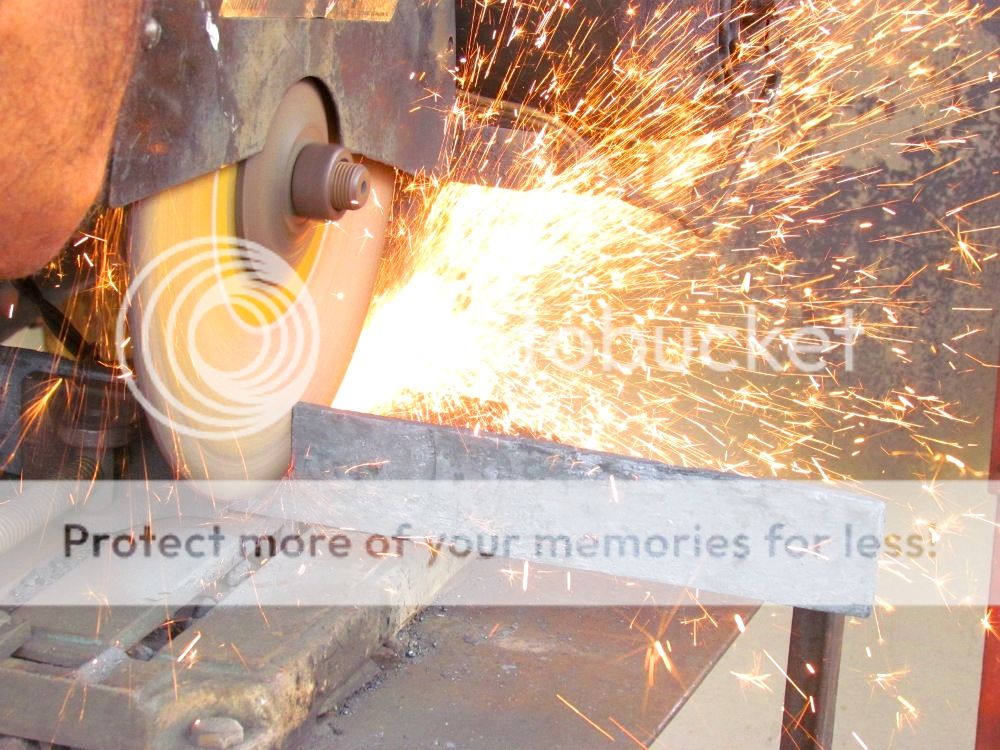

Don't forget to use ever protection equipment!!!

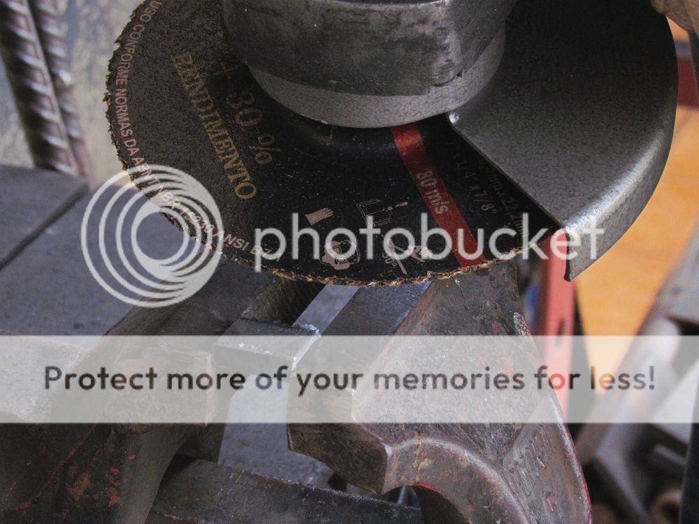

Cutting the billet.

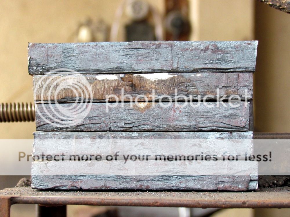

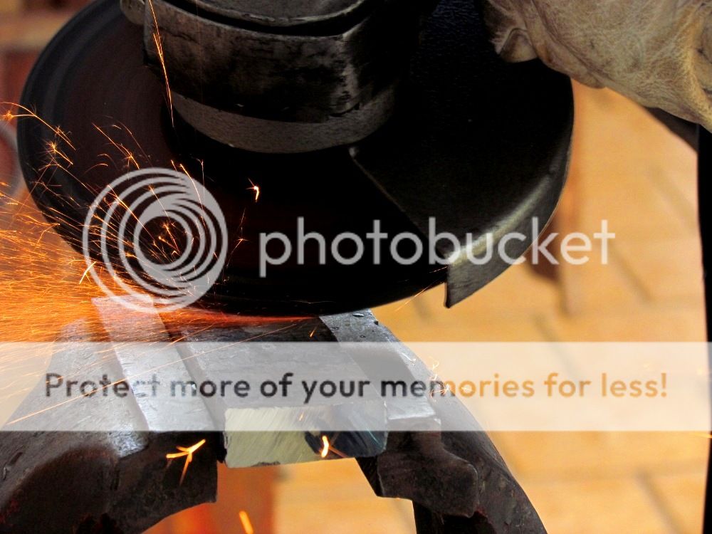

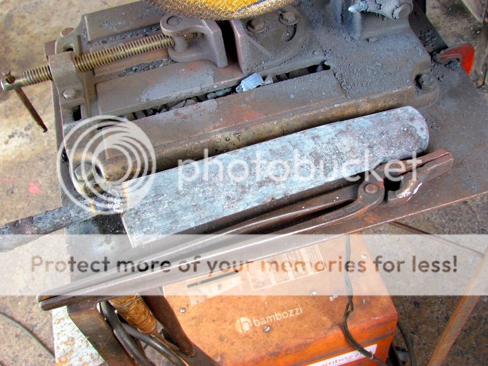

Grinding the contact surfaces.

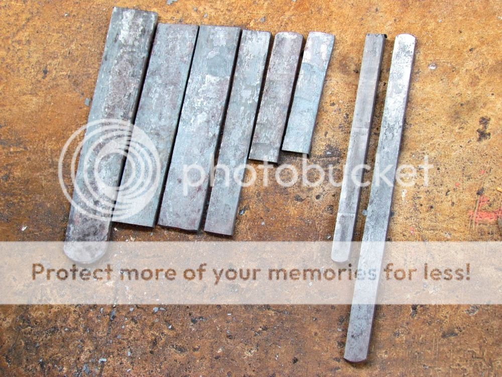

Clean surfaces.

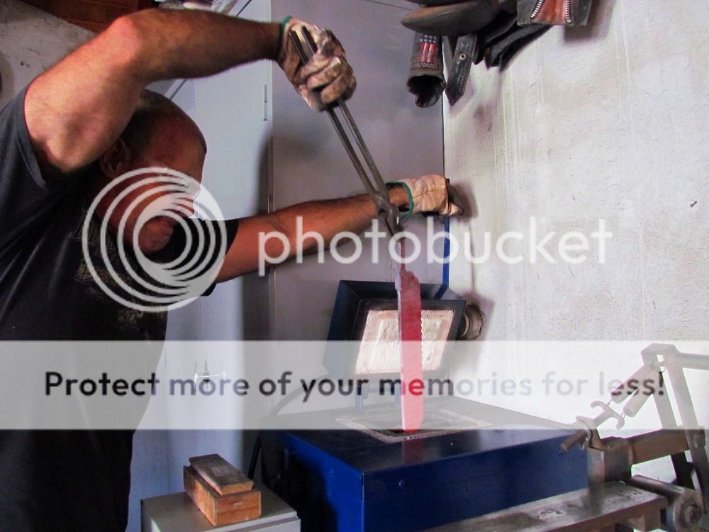

Typically the resulting bars do not have all the same length. If you are forging in hydraulic press, place the smallest in the center and divide differences at the ends. The presses tend to further compress the central bar and consequently the more elongated than the outer. On the power hammer this effect is the opposite.

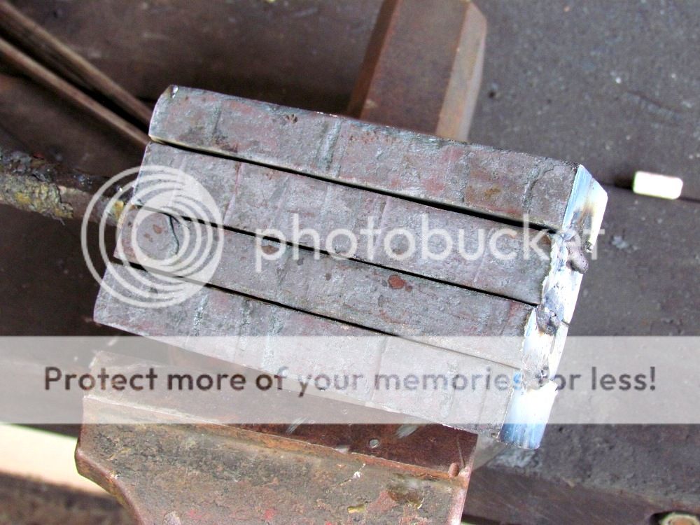

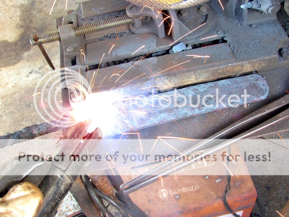

Welding, always use solder mask and gloves. Avoid using synthetic clothing. It's burn quickly with the slightest spark.
Remounted billet. 42 X 5 = 210 layers.

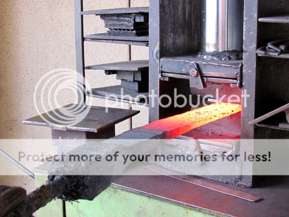

Heating the extremity will be press.
Printing the pattern.

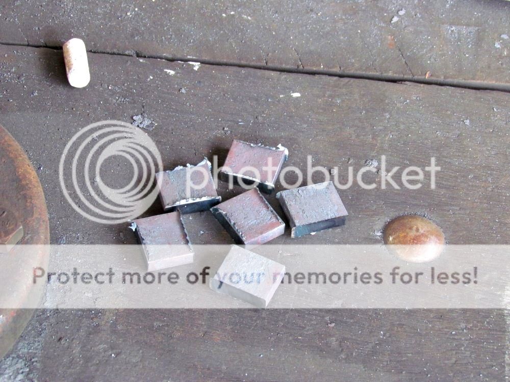

Six tablets for three knives.
Grinding the suface.
Welding the tablets on the position.

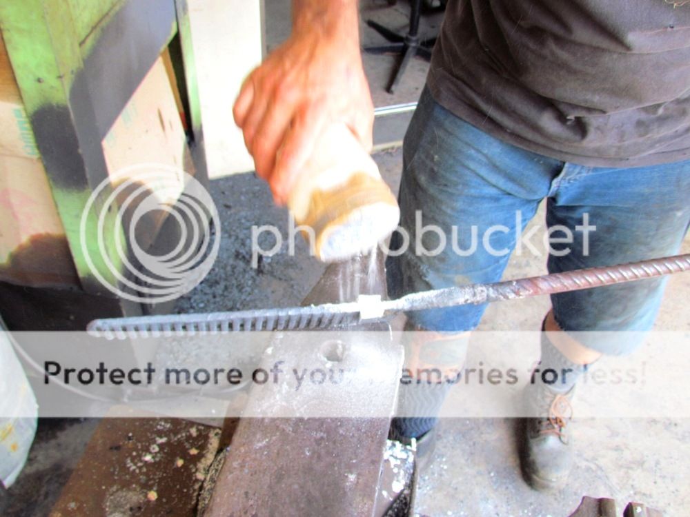

Adding borax.

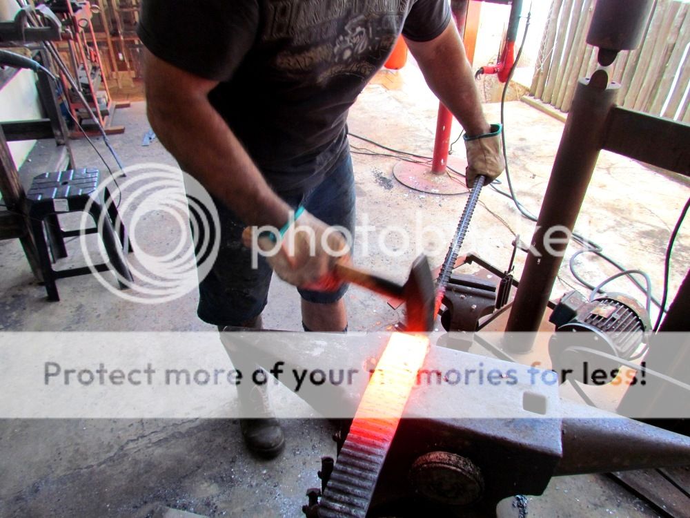

Welding by hummer. It can be done in the press or power hammer, but I always got better results with the hammer.
Forging the tang.
Finishing by hummer.

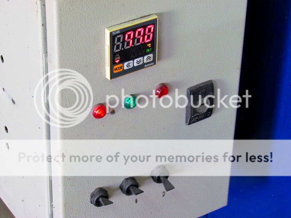

For this alloy, which is very hard and usually produces hardening (hardening resulting internal stresses from the forging) I suggest you do the annealing. The hardening creates problems especially when the stamp mark on the blade to be hard, usually gable. The ideal temperature range is 770º C (1420 °F). Remember that annealing produces grain growth and consequent problems of mechanical weakness and deficiency in edge retention. Make a normalization before quenching is required.
The knife at 770°C (1420 °F). The oven is an excellent tool to have fidelity in heat treatment. It can be made at the forge.
