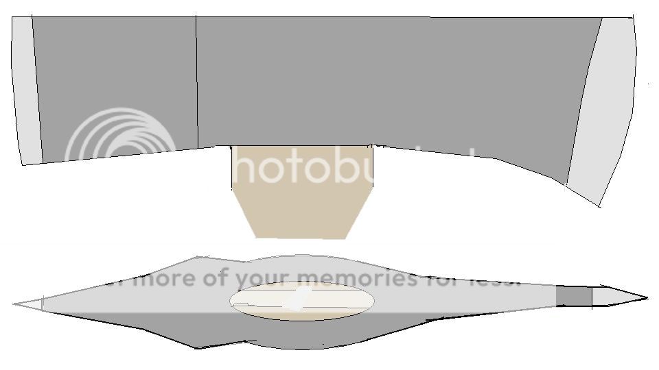

Not really, I guess I'm not being very clear. I mean that the one side would be completely different, not just a fatter final grind. It would look like some kind of splitter and a felling axe just put together.
EDIT: I made an awful trackpad MS paint sketch to help
That's a pretty dang good sketch. I understand now. I've never seen one like it nor heard of it before Trailmaker's 'chopper one' post above.
I do believe that would be WAY off balance.
You could balance it by moving the eye toward the splitting side - assuming someone actually was going to make one.
Right. My point is that you could design it to be balanced. The sketch is meant to illustrate that the priority would be on balance and function rather than symmetry as in most DBs.
