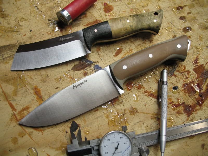

One of my Modern Nessmuks (upper) with carbon fiber and Buckeye with .125 copper pins. The lower is a test knife. I am a fan of WinklerII knives and and after seeing the Snody/Lorien Millbrook project I semi-married the two. A tall full grind with the exposed tang.
Both out of A2 and hollow ground. No flat grinds here; one of Nathan's 36" radius platens.

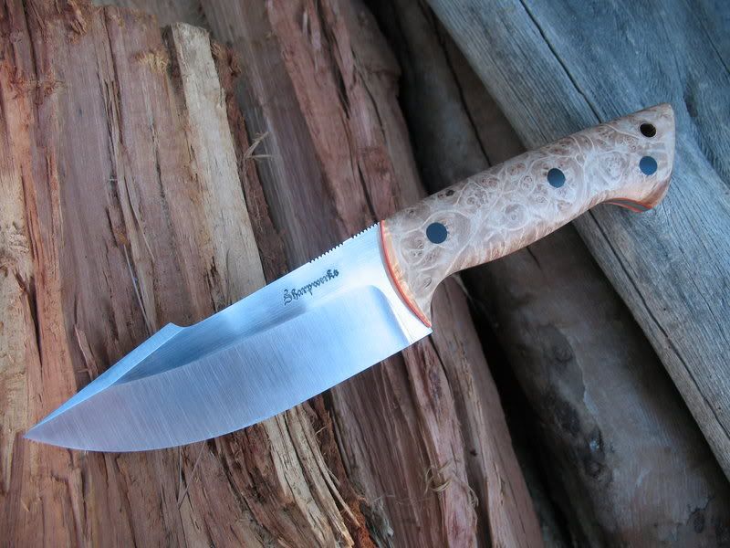

The second also a "see if I can do it" knife. A raised clip (cuz I can't stand the term "harpoon grind") with Maple/G10 and Micarta pins also A2.

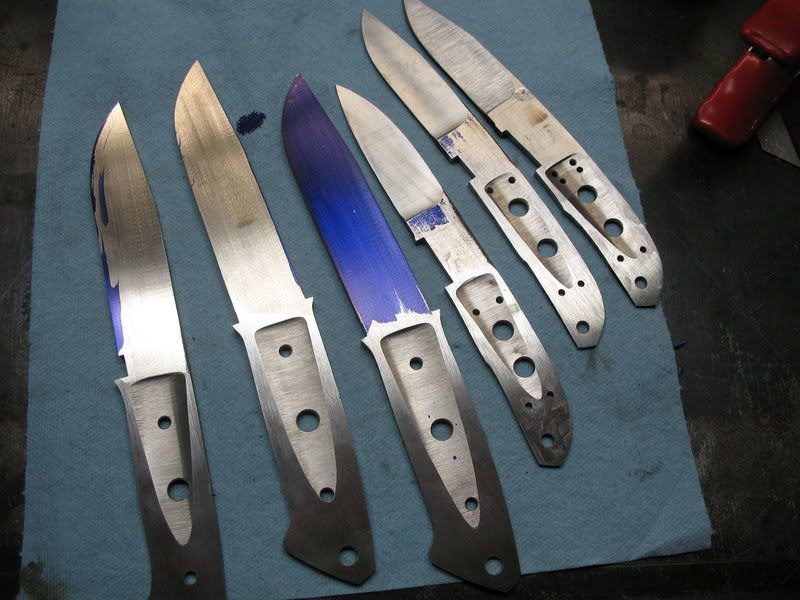

And finally 6 Loveless patterns in the works. From L-R a 4.5 Utility Hunter, Mini Wilderness, Chute, traditional Stiffhorn, 2 Utility bladed Stiffhorns (both OG Loveless designs but both different) the three larger in CPM154 the 3 smaller in 154CM
