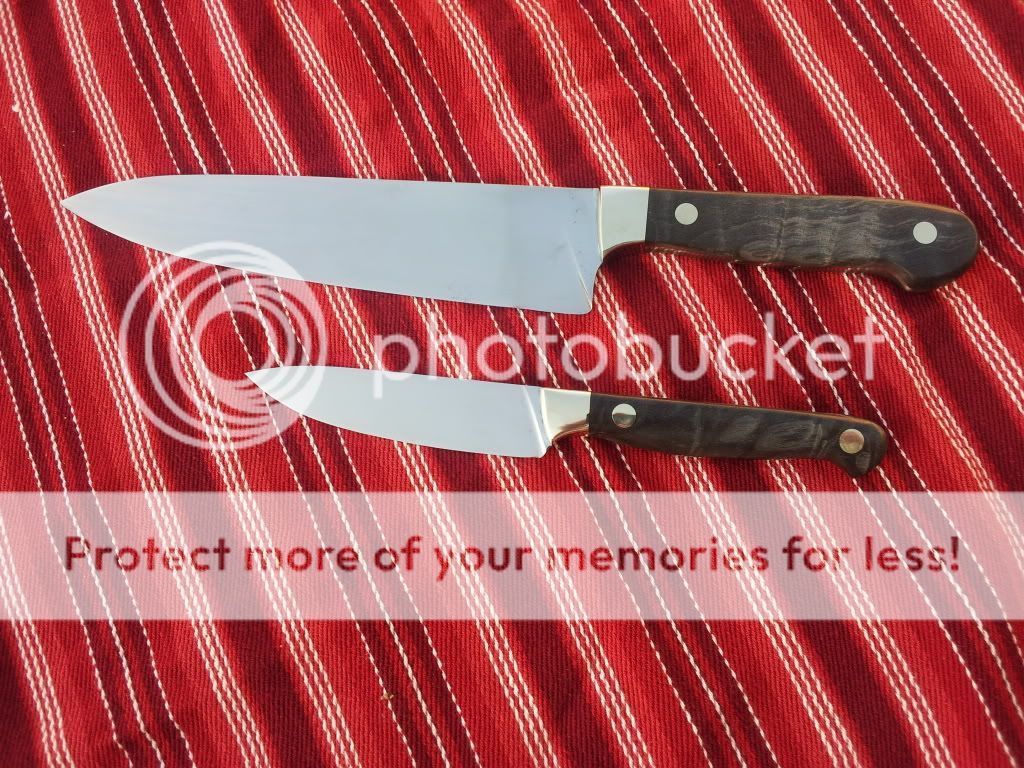

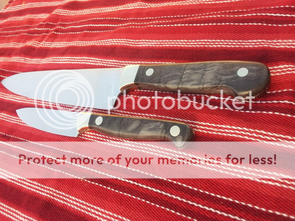

Chef knife is 8.25" long, 2" wide, and 3/32" at the thickest part with a full distil taper
Pearing knife is 4" long, 1" wide, and also 3/32" with distil taper
Both have O1 steel hardened to 60/61
Wood is Smokey Quilted Maple
Bolsters and corby bolts are all Nickel Silver
Both have full flat grind.
Thanks for looking.
Comments, critique, and criticism welcome
Jason
