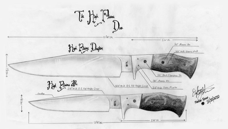

I don't know about other knifemakers, but I stay up all night just about every night drawing knives. I'll have designs floating around in my head all night and if I don't put them on paper, it drives me crazy. I seriously just lay in the bed, staring at the ceiling visualizing designs and why they work or don't work. Some nights I get pretty tired and I think, "I might actually be able to fall asleep at a normal time tonight", but the second I lay down, it's like the damn circus comes to town. I start fidgeting and then the flow of knife visions begins.
Here are a few designs I want to knock out after Xmas. Since I first started making knives, one of the main goals I've had is to tackle the Bowie knife. I've been reluctant to get started on one, just due to not thinking I really had the skills to execute it properly. I think I can handle it now, so this will be a big goal reached for me. I have two different sizes, one big chopper and one large belt knife. I'm not married to the handle materials, but the idea I have now is for an Ebony wood scale and ivory micarta bolster. I think that will make for a nice modern bowie handle. Obviously these aren't really the traditional Bowies of olden times, but they're my interpretation of a modern Bowie knife.

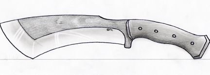

The other design I've been toying with was inspired by the Zulu battle axe, or Isizenze. The shape of the blade is just so effective and I don't really see it often used. I wanted to make a chopper knife that really took advantage of the bite you can get from having an angle "sweet spot" as apposed to a straight or curved cutting zone. The point of that angle is going to be the contact area of the blade and should bite pretty damn good. I'll make one and do some testing to see what I think. Could be that I'm crazy and this design sucks, but I've had this one in my head for a while and I want to test it out.
So that's it. Discuss.
High Plains pair looks pretty nice. I'm not a huge Bowie fan, myself, but those look to be a cool take on them. I dig the handle shape.
Now the Isizenze? That looks pretty wild. Zombie-slayer all the way!

I'll preface this by saying I'm not a bowie fan at all, in fact, it's probably my least favorite style of fixed blade. That said, in the short time I've been hanging around on BF, there are probably 10-15 bowies that have really got my attention. Two of them are in the sketch you posted. The rest of them are Lamey masterpieces or uber high end custom/art knives. I guess that's a roundabout way of saying you've got a super nice design there. I could potentially see myself owning one of those.
I won't say much about the Isizenze, since most of my chopping experience is with axes and a khuk, more recently. It does look like a hell of a sweet zombie slayer, though.

Man, those are nice Bowies bro. Your drawings have been kicking ass.

Thanks broski! That's a huge compliment!

The Zulu looks right up your alley bro. You are the king of the big choppers
Wow, the king huh?! Sounds good to me. I don't know that I deserve that title yet, but I sure do love my choppers and I hope I can live up to the title. :D

Dylan, That Isizenze is just nasty looking.. WOW!! What are the rough Specs?
I forgot to put the specs in the first post. I'll fix that. The Isizenze is going to be 14" over all with a 8.5" blade and 5.5" handle, 1/4" thick steel. No idea what steel I'm going to use.

Your design looks much more functional especially if a finer edge is put close to the ricasso for feathering/notching (to go with the trademark thumb ramp).
.235" thick at the sharp end tapering to 5/32mm at the blade end, maybe 1/8 by the end of the handle for weight forward chopping.
Make it in spring steel at HRC 52 for shock resistance and what you got there is a bone fide double hard survival tool!
The Isizenze is rad! I really like that design. Im not a Bowie fan either, but.... I like the contemporary handle materials. Looking forward to seeing these.
The Bowie interpretations are fantastic bro!!
That Zulu inspiration looks mean and wicked, I love those lines. Personally I'd like to see it with the front end just a little a little more forward so more of an acute angle on the actual tip, but that's just me.

That's what I was thinking as well, I think the sweet spot would fall on the upswept front section then instead of on the lowest point where it changes direction....if that makes sense !:confused:

I don't know...I think that secondary point would still be the sweet spot, I just like something that will stick good too :D
