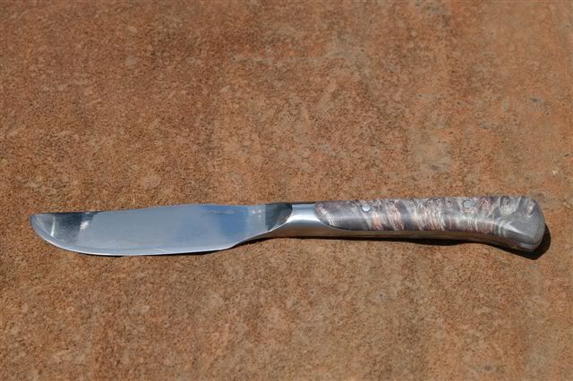

The Integral was done after seeing Burt Fosters demo at ashokan,and alot of good HT advice came from the man as well (Thanks Burt)

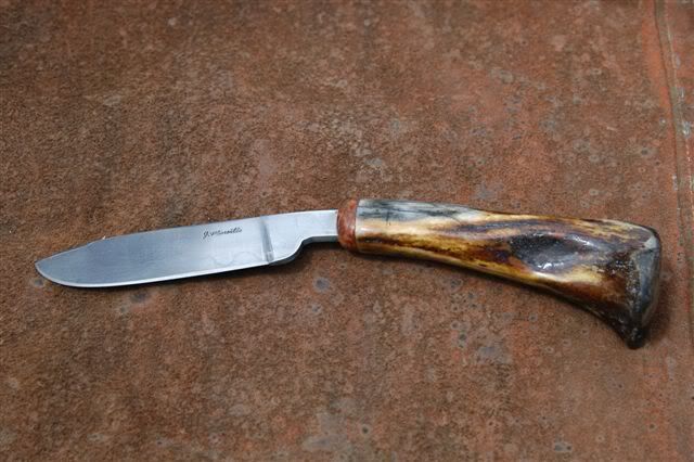

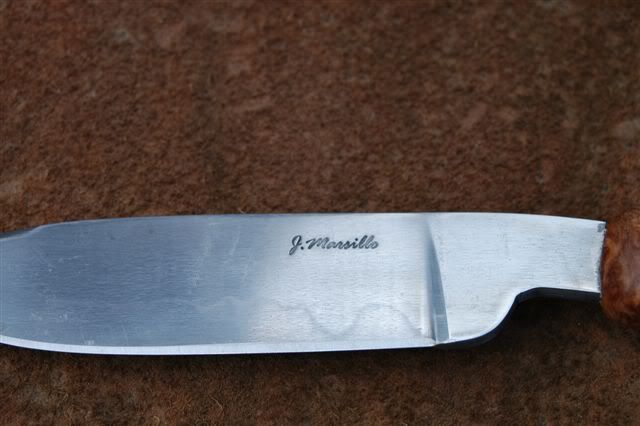

Forged from 5/8" W2 and differentialy hardened.Dyed and stabized box elder burl scales.

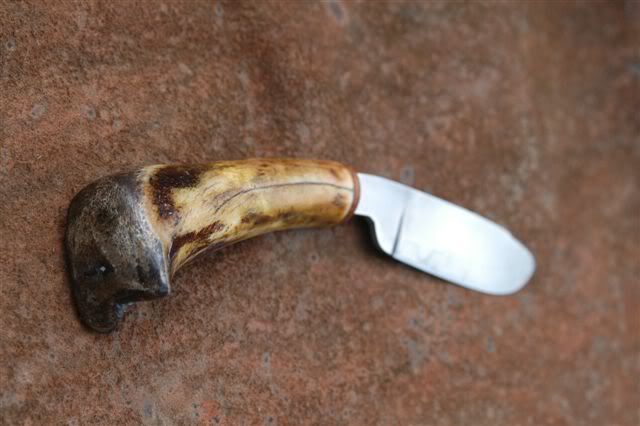

The Deer leg bone was dyed and given a crazy glue finish and another W2 blade with hamon.
