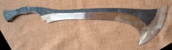

Last month I emailed Jimmy Fikes and got his Ok to do a version of his Jungle Honey design. As I began work, I almost immediately started deviating from his original work. First, I chose 5160 steel, it's a steel I use a lot and am familiar with, but it also meant no hamon like the original. Second, I wanted to do a kind of Persian type of blade. Of course, I kept the most important part of Jimmy's design, the short blade/long handle feature. I think it is a great survival sword, versatile in everyday camp stuff, and badass enough to be a very good defensive weapon.
The blade is 16.5", the handle is 16". It weighs 3 pounds, and cuts like a monster. With the long handle, you can swing it unchecked, full force, like a baseball bat. I nailed the HT, and it takes down thick branches with no damage to the edge. It cuts rope like thread. When I run out'a ammo, this is plan B. All comments welcomed.

That has hard use zombie killer written all over it.....nice job:thumbup:
The only thing I am not super crazy about is the castrator pommel. I think it looks good but I could imagine opening up the artery in my forearm with that bad boy if I got a little too animated.
Overall still a killer piece though
I was thinking the same thing. It is a super cool piece with great aesthetics and first class grinds but knowing myself I have a feeling that after I got through with an all out assault on the vegitation in my back yard, I would find a three foot section of my small intestine laying on the ground.
Really cool stuff though! Thanks for sharing.

I've been away for about a month without the use of a computer. I'm glad I checked this thread, and happy to see some more comments. I've finished the sword, sanding the blade to 400 grit, adding slabs, wrapping them in thin leather, covering the leather with spar varnish, and then adding paracord and turks head knot. I also finished the sheath, adding a hammered brass fitting to hold attach strap rings. I then made another companion sword, this one though is a one handled model,again with the same blade profile and pommel. I have yet to make a sheath for the second blade.
I know the larger sword will have to be carried sling style on the left side, for a right hand draw. I'm thinking of trying to mount the second blade in a back carry rig.

Making the blade is easy, well..I mean I've done it on a regular basis. The problem lays in the heat treating and especially the tempering. Most makers, including me, can only temper an overall lenght of around 26 or 27 inches. That includes the tang. So, say you make a 18" blade, you'd only have a nine inch tang to support a 5' shaft. I've seen guys do this, but they have a collar arounf the shaft with pins through the iron collar into shaft and through the the tang. A good solid sturdy construction. But not picture pretty. Functional as hell, but...
I'll be happy to make you a blade with tang fittings, if you want to mount the shaft yourself
If you want to pursue this, best to go to Pm's.
While I really like it, it seems the only commonality with the Fikes jungle honey is the length of handle and blade.
