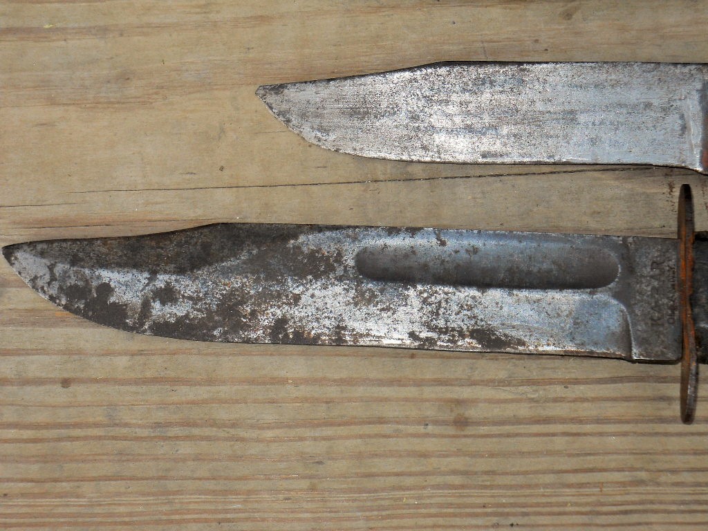

Hello there. I am looking for some help and this looked like a good place to start.
I recently came in to possession of a couple of knives.....

As you can see they are in poor condition and I would like to breath new life back into them.

So this is the deal. One belongs to my father, it was his uncle's knife. The other was my grandfather on my mothers side. I really would like restore these I am just unsure how the best way to do it is. I also am restricted by a budget. So any help would be greatly appreciated. The one that was my fathers I would like to restore and return to him. Also neither knife has a sheath so I am going to have to make one......which I have never done..,...LOL!!

The small Kabar is a WW2 USN MK1 utility knife. It appears to still be "original" in its parts.
The large Kabar is a WW2 USN MK2 fighting/utility knife and is in "theater mod" condition, meaning that the knife was modified "in the field", most likely after the pommel broke off after. Whether that was during or after the war would have to be a story from your dad. :D
The original pommel was most likely a 3/8" thick, round, steel pommel that was peened on, rather than pinned. My assumption is based on the stamps on the ricassos and statistics. Guard stamped thick pommel and blade stamped thin (1/4") pommel versions were made, but in relatively small quantities and are seldom seen.
The first fix would be to stop the active red rust. That would be with 0000 steel wool, 3-in-1 oil (or equivalent) and elbow grease. Without intervention, the rust will continue to erode the blades.
The next fixes would depend on how you want to bring them back up to snuff. To return them back to near original is possible - Kabar (go to kabar.com for the 800 number to cs) sells leather disk replacement sets. I believe they also sell replacement pommels. These replacement pommels would be NOT period correct as they would be thick ones drilled for pinning and not stamped for peening. No original thick pommel was pinned.
I don't know if Kabar sells MK1 specific kits, but the leather disks of the MK2 kit could be used. They would just need to be sanded down more to the original version's handle diameter. Your MK1 pommel is probably peened on (no pommel end pic) and could be reused with judicious care in removing.
... and elbow grease.
Lots of elbow grease. ;)
Agree with zzyzzogeton, not a big $ issue, just manual labor. You'll never get rid of the pitting but you should be able to get a nice stain finish. You could even give it a vinegar bath to force a dark patina to get closer to the original look.
Several vids on YT on rust removal and leather handle replacement.
After you finish with a 00/000/0000 steel wool progression, post some more pics for additional recommendations.

My plans so far are to focus on the Mk2. The pommel (or butt not sure of proper term) is not original and is held on with a pin of some kind.. So I want to remove that so I can see what condition the tang is in. I fear that the rust is under there too, though I am not sure. I would love to put a proper bottom on it but not sure that I will. And if I have trouble with the washers I can always rethink too. The guard at the blade is loose and so are the first couple of washers but I think that reconditioning may help to tighten that up.

The originals (both MK1/2s) had a parkerized finish, so a heavy patina would be closer to period.
I dont want to put scratches or swirls in the blade.
meh, as long as it doesn't get gouged, any scratches or swirls can be sanded/buffed out.
I am torn between the "patinaed" type of look or trying to shine it back up.
Easy enough to bounce between the two.
It have been suggested to leave it more aged for the money value ...
No real 'money value' here anyway. Too much damage. 'Like new' in 'original' condition is where the 'money' is. As you said, the real 'value' here is sentimental.

Yeah I am getting kinda stoked about this too. Started cleaning the blades last night. Used a worn 320 grit sanding sponge and some machine oil. I was pleased with the results. Got some steel wool to continue with them. There is some pitting in the metal. I was thinking of some very fine wet/dry to smooth the spots....not necessarily remove it just soften the edges. I am going to work on it this weekend and try to put up some pics to show my progress.

Well here is an update.....have spent several hours working on these...
This is where I started
And here is where I am at.....
Just a bit of difference I think. Still have some work to do but its encouraging to see the progress. I am not much of one for tedious task but this has not been too bad.
And I was surprised how sharp the big one is! Did some feather sticking while messing around with my boys and it did awesome.....have not even touched a stone yet!

When I get an old project knife with leather washers, I use saddle soap to clean the handle once a day for a week. Then I let it sit for a week to dry out, I will then put the knife in a plastic freezer bag and pour in a whole bottle of neats foot and let it soak for a week. I have had good luck saving leather handles using this treatment.

Too much pitting to make a full restoration worth the 'days' of hand sanding worth it. Might want to try some 220grit to put a bit of satin finish around the pitting.
I'd concentrate on cleaning up the edge itself and the leather.
I think you better get some more opinions on what to do with that leather before you try the suggestion above. I've only seen leather ruined by what was suggested. The leather you have is 70 years old now and may not be salvageable in any case. The methods used to try and preserve leather vary a bit and need to be applied in a case by case basis. Better to have your "leather expert" look at the knives first hand. I've only seen one kind of result from soaking any leather for extended periods of time in (Neatsfoot oil). The leather becomes spongy and will leach out oil for months or even years. The leather looses it's structural strength and will rip much more easily. On old leather I've seen it actually break apart.
I have used Neatsfoot oil, very sparingly, to keep leather from drying out when it's being dyed and other processes that tend to dry it out. IMHO, I prefer to use Lanolin for this sort of thing these days.
