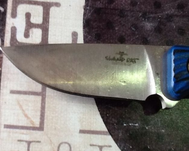

I have a Rodent 3 that I acquired last Xmas. I've used it quite a bit, but kitchen duty only. It is pretty much impossible to use and keep in a satin finish ( unless someone has got a way??). I use a sink cleaner that is mildly abrasive and Turtle Wax scratch remover. I've even used steel wool. It worked ok for a while but this is the best I could do...
....considering using meat / blood to force a blue petina. Many varieties of fruit will just turn the blade black. Love the knife nonetheless. Very solid feeling, NICE edge!

Once patina forms, there is no reaction with acids in foods, at least nothing that changes the color over time, all my kitchen knives are carbon steel and it seems the patina holds the colors with time.

Deer blood renders a nice bluish/purplish patina on 1095 and O1. Not sure what it'd do on SR101, but I bet it would look nice. And like someone said, carving a hot bloody steak works quite well, too. Great... Now I'm hungry.

I've seen some of the hogs use plain old white Colgate toothpaste and it takes the discoloration right off.
