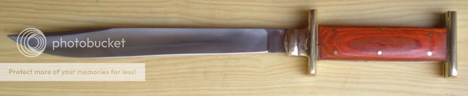

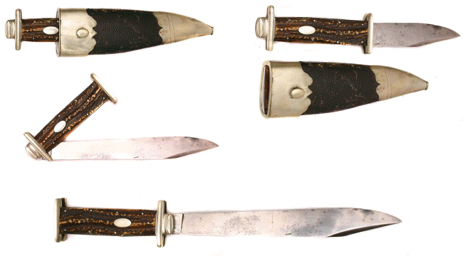

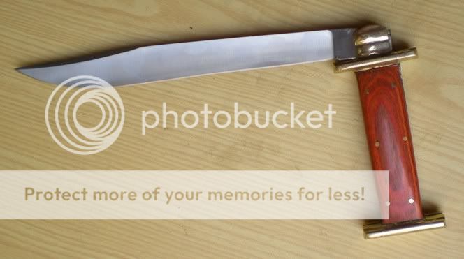

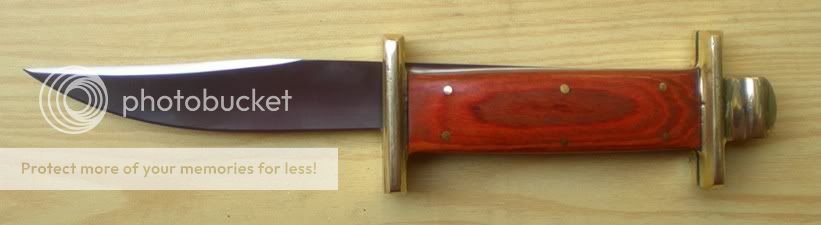

I've been working on making a folding Bowie, that starts off as a nice vintage style fighter in the sheath and then opens up to a 16 inch Bowie. One issue I trying to resolve is how to lock both knives firmly in position. If any of you have any photographs of similar knives or suggestions about this type of knife feel free to share. The pictures are of what I am using as a reference with sheath and several of a rough working prototype. I want to get a good working prototype before I start using expensive materials. I'm going to make two eventually - one with an ivory handle, one with black stained stag antler. All thoughts and suggestions appreciated. Thanks.
This is the reference I am working from
Folded down to a fighter size, which will fit into the sheath.
Opening
Fully extended to 16 inches.

Never actually handled one of these, but my understanding is that the shield on these is actually a button that unlocks it from both "closed" and open positions.
Ah! Now that makes sense. That's really very helpful. Thanks. I didn't want a obvious button. You have solved the last part of the jigsaw for me. Just got to work out how to make it work now.:thumbup:

Thanks. It's one of the issues I am working on to resolve. The navy folding bowie from Joseph Rogers above has lasted from around 1890. So it is obviously possible to make them to last. Having said that they are pretty rare. This is either becasue not many were made or they break!? Only time will tell I guess. I'm certainly going to make the final two I produce to be pretty rugged.
