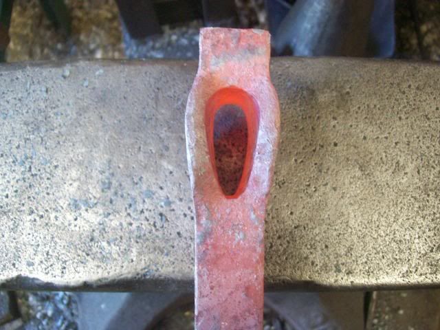

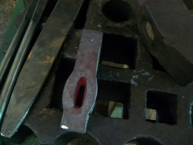

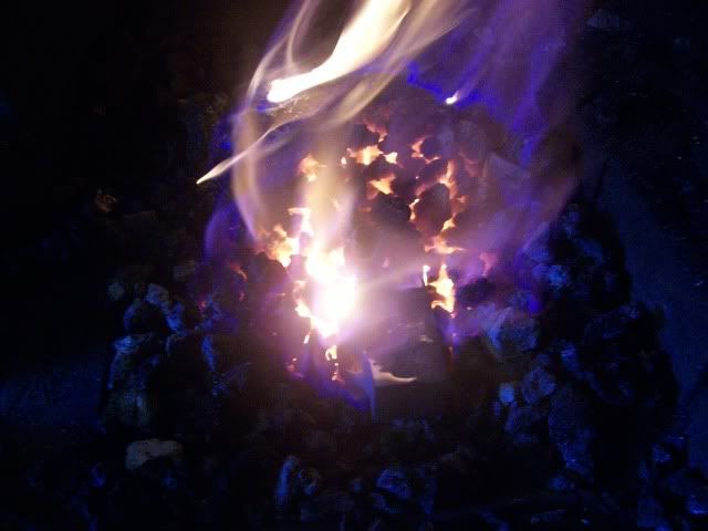

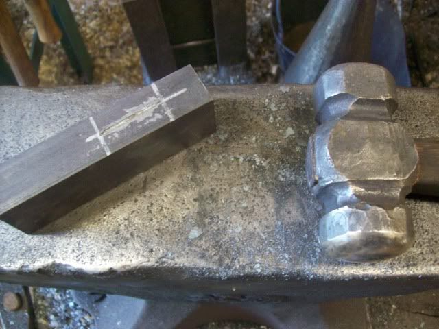

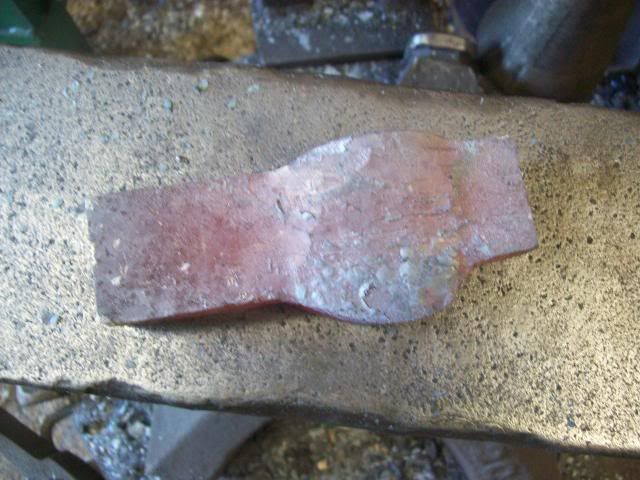

We took pics of this last build so I thought we would post them..Shows just how much really goes into making this type of hatchet..
Start off with a 1" x 1 1/2" bar of mild steel..

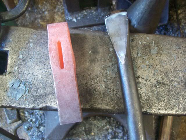

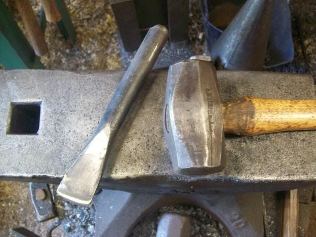

First thing to do is make the eye..Here are the tools we use..A hand held hot slitter and a hammer.
Just started..
A "in the fire" pic..
Hot cut through both sides..

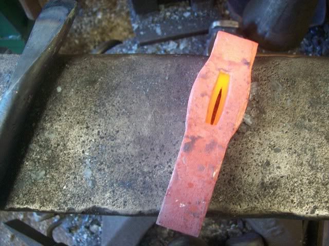

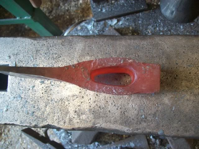

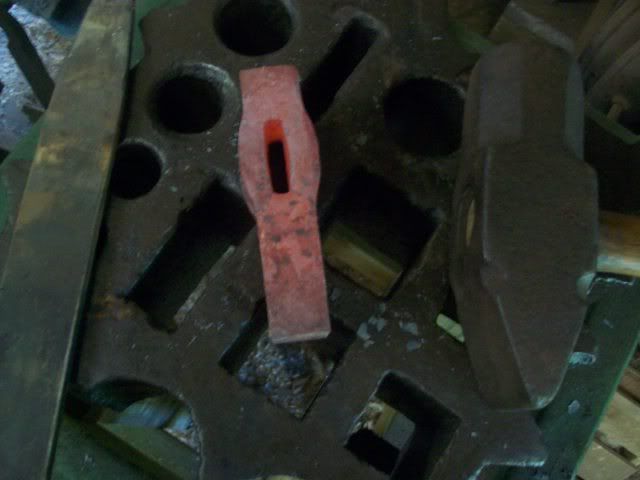

Opening the eye..
A spring swage in the hammer for drawing down the ears..
Ears drawn down..
Eye drifted to shape..

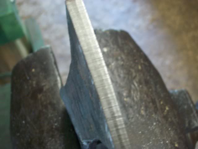

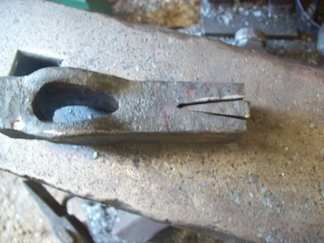

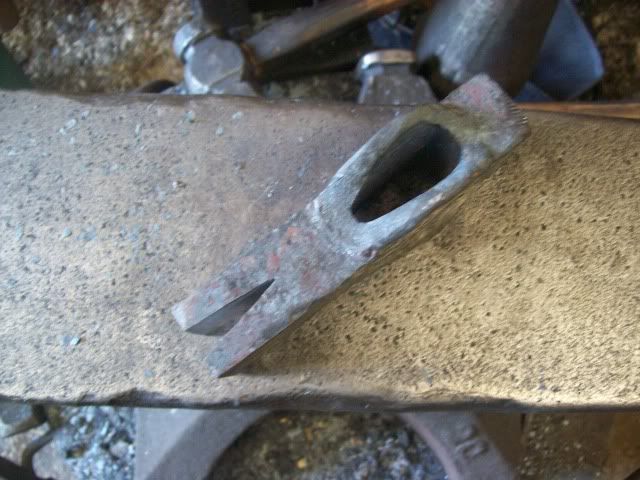

Poll cut to accept a cutting bit of 1075 steel..
All welded up with the edge trimmed away..You can see the 1075 between the layers of mild steel..
Shot of the eye..

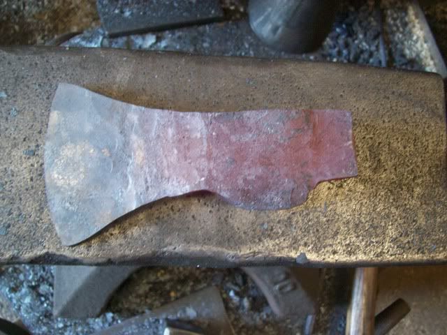

Ready to anneal and grind on..
Getting ready to heat treat...

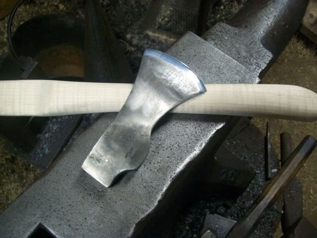

Heat treated,ground and ready to start assembling..
Heres a few finished pics..
