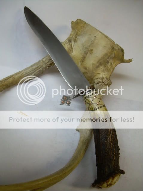

Not up to typing much so I'm just gonna let the pics mostly speak for themselves.....
A collaboration with Bladesmith: Jerry Rodri of 9 Tongs Forge…
Wild Goo 29 – Bladesmith Tai Goo of course………..
Sometimes the end of the antler just looks great by itself
The above two are convertibles sheaths – they can be worn left or right handed
Copy of an original Southwest belduque by bladesmith Joe Delaronde from SW Colorado
I used thread for the “braid work” on this one – the knife is by maker C Matteo from MIchigan - the inlay is buffalo hair on hide....
And last but not least a couple more Wild Goos….the top one is quillworked rather than beaded........

Kevin - here's a pic of the the coffin handled knife...
It's based on the knife carried by Seth Kinman, a famous 1800's frontiersman with a very interesting history.........

That recurve piece was actually one of those serendipitous pieces that just happen - The grip, with copper fittings came together with out a blade, and then Tai sent that blade out of the blue and voila!.....
