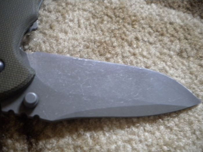

Just to share some finish Ideas. This was a custom finished knife for a good guy on here who proudly serves our country.
We called this the Grunt finish.
-OD Canvas
-Acid washed and hand tumbled in copper 1/4" nails for added toughness;)
-Acid washed and hand rubbed clip, liner and LBS
-Oxidized Titanium handle. 1000 wet grit sanding followed by OXY treatment
Thank you ARK and Chris. I enjoyed this one.
When I say hand tumbled. I meant that I put the blade into a little wooden tray that I made with a lid and filled it with the small nails. And shook it vigorously back and forth (sifting style) for a longer mark feature instead of tiny little marks like on a fine stone wash. This has a different finish. Then flipping the blade over and doing the same back and forth to even it out.. :)
Nice looking finish. What does "hand tumbled" mean?
Ah i see, your giving your secrets away too quickly my friend. ;)
I hope not!
Here is a closer look. Kind of a spyderweb pattern. Not a good picture to show how even, but something left over.
