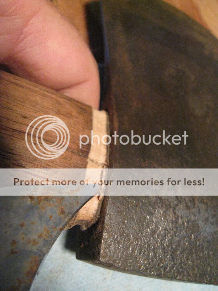

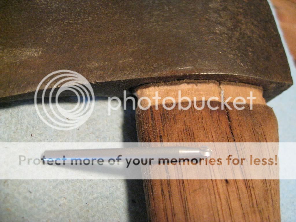

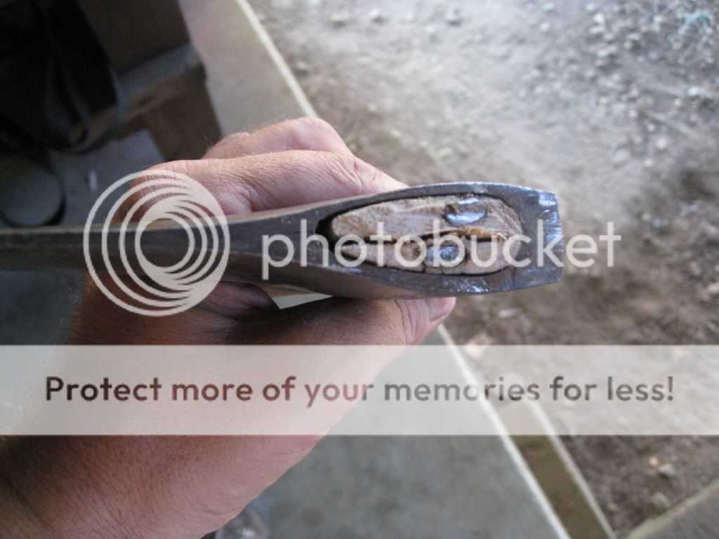

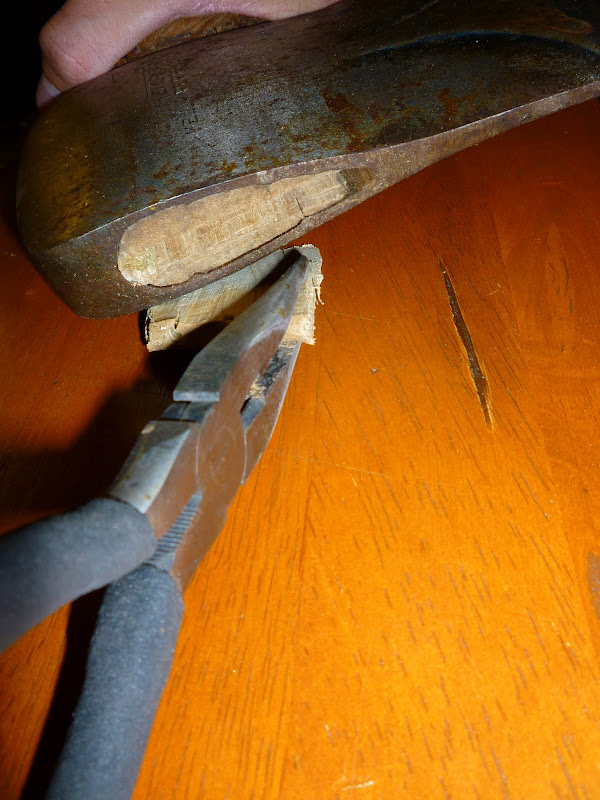

I thought I'd post some photos of a recent haft removal, and the tools I found useful. I'm sure there are many better methods and tools for haft removal but this worked for me. I did most of the wood removal with this little Dremel attachment.
Then I used a knife to get the little ridge of wood right up against the eye where I couldn't reach with the Dremel.

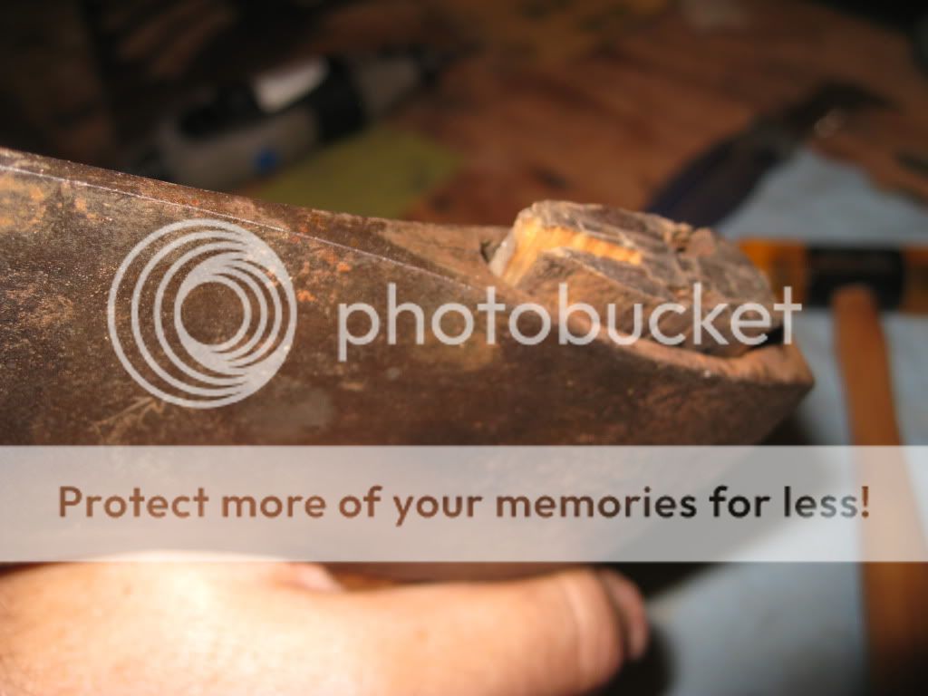

Eventually I removed enough wood and I was able to slide the head downward, which leaves the top of the handle exposed above the head.

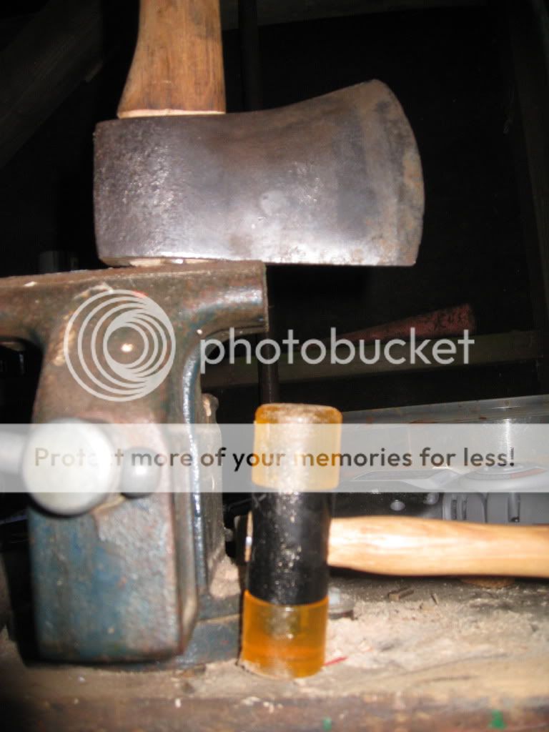

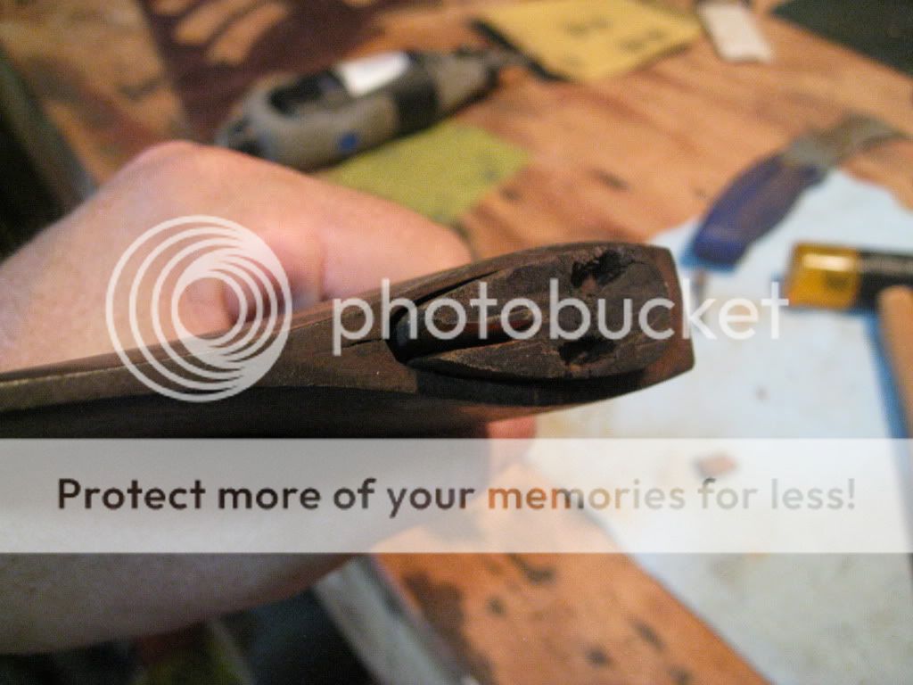

The next step, which I forgot to photograph, is using a small handsaw to remove the handle wood on either side of the wedge. Once this was done I had just the wedge sticking up out of the top of the handle. I pinched the exposed wedge in a vice and used a plastic mallet to knock the head upwards until the wedge popped out. Initially I tried to simply pull upwards on the handle but in the end the tapping with the hammer is what was needed.

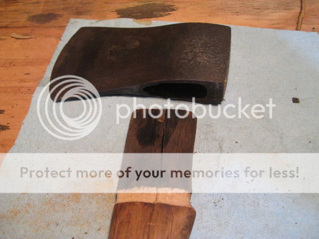

Once the wedge was removed I was able to knock the handle through from the top. It was still a pretty tight fit because of the metal wedges that had been pounded in from the top of the handle.
I'm getting more proficient each time I do one of these handle removals. Some are easy and some are messy and sometimes the handle has to be written off.
