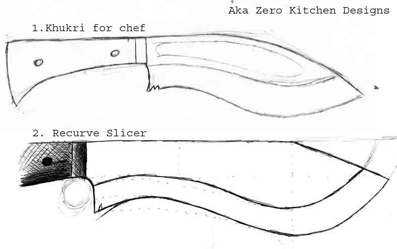

I got a drawing of something somewhere between a chef/santoku and a khukri.
will get it scanned later. have to go to work now.

These are not to scale or anything.
Scans of a couple drawings I liked the best. Problem is I keep wanting to design an all out chopper, so was hard to keep focused on the kitchen task.
Main change I would make for adapting to kitchen use is a more chef like handle. So you can get closer to the work surface, and choke up some on the blade so you can get detail work done.
Chiruwa style handles would help it fit into kitchen style better, and maybe would upgrade scales to something more water resistant (micarta, g-10)
Starting out with hron (maybe wood), no bolster, like on the cleaver would look pretty cool.
#1 is kind of santoku style mixed with a khukris curves. 7-9" blade Would be good for rocking through veggies, and the belly of the blade would be good for slicing meats. The oval shape indicates a fuller. Around a pound or less for weight would make it good for a lot of kitchen tasks, as well as a good camp tool.
#2 Is more of a cleaver replacement. 8+ inch blade, traditional kukri thickness, but a lot of curve on the belly to help it slice well too.
Tell me what you think, Outline areas that might be improved.
