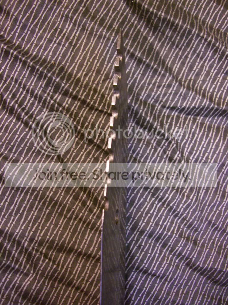

This antique cleaver (I call it my "chicken chopper") has a lens-shaped cross section.
You can see how the teeth of the meat tenderizer get thicker as they approach the tip, which is at the center of the "lens"
Wow :eek: I have never seen anything like that. That is pretty cool. And even though it's got that mottled patina I can kind of see the effect I'm looking for of a "spherical blade."
I don't suppose that's an easy-to-find cleaver :) thanks for sharing
Actually, I guess they turn up all the time on eBay, usually labeled as a bowie knife of some kind. No one seems to know who made them, but they seem to have been pretty well distributed and made in large quantities. It's a great chopper for culling old laying hens. :D:thumbup:
