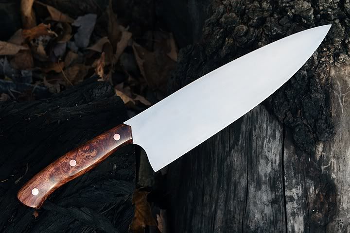

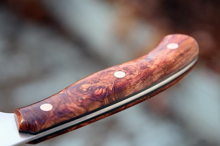

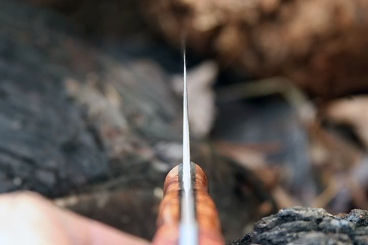

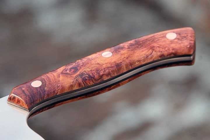

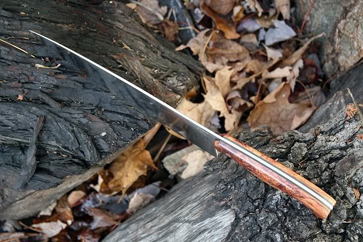

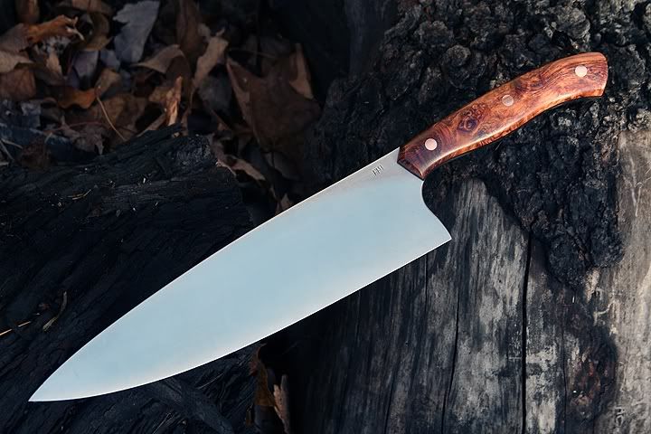

Heres one Im working on It should be done today. I still need to add the final edge on this one. But wanted to try and get a few good pics in the morning light!
Its blade is 240mm from tip to heel. With a 2.9mm thickness above the heel. tapering to a super nice thin tip. Blade is 1095 HC with a bright satin finish. The blade is TALL!! Measures 57mm at the heel. The balance point is at the makers mark.
Thanks for checking out the thread. Comments and critiques welcomed!
