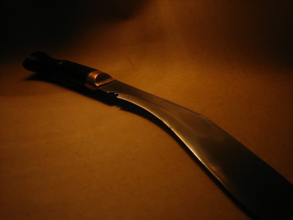

my ww2 does similar duty.. a slightly thinner edge than standard so that it goes through the finer stuff, but its a real workhorse of a knife.. it still kinda looks good too, distinguished with its patina and rough wear marks.
