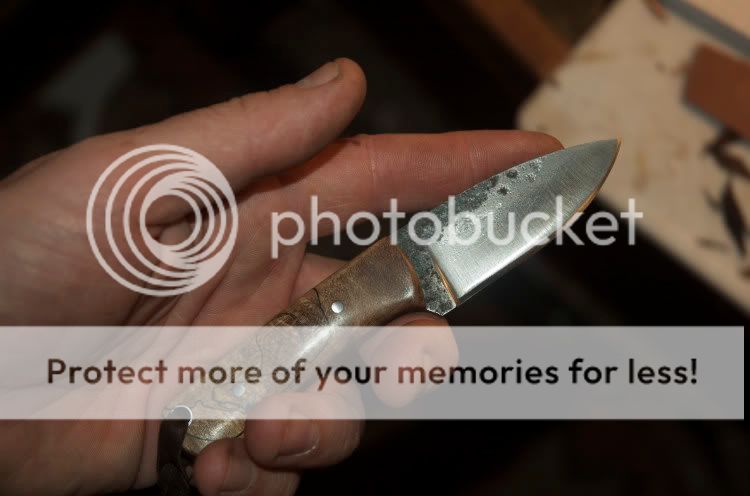

I thought I'd post this pic to show the size in the hand. The guy who's getting it was kind of shocked to see how small it really is.
Stuart that is a sweet little knife it looks like you could count on it to do most small job very well
