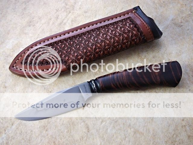

Here's some pics of one I finished recently for a good friend of this forum :) . I think this is a mean looking little knife. Very compact and lightweight.

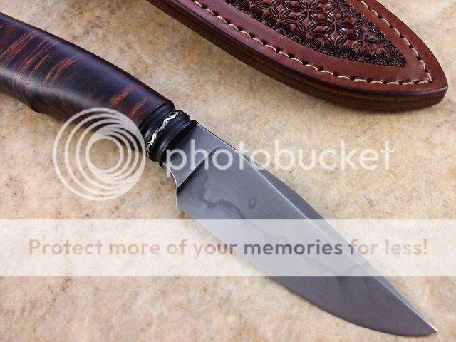

Hand forged from W2 steel, clay quenched and etched
7 3/8" overall, 3 3/8" blade, .160" at the ricasso with full distal taper
False edge, just shy of sharp
Heavily rounded spine and ricasso edge

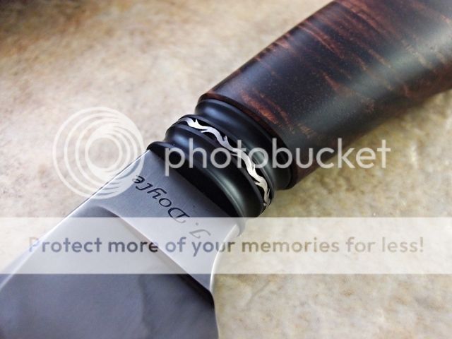

Black g-10 collars
Thorn and vine fileworked titanium spacer

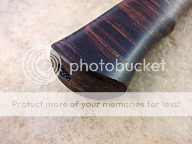

Stabilized Hawaiian Koa

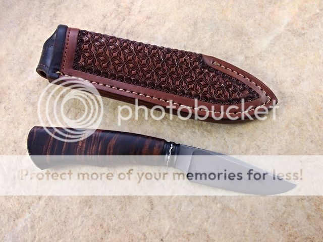

Claude Scott made the sheath and did a great job of it too!
All comments and discussion welcome.

I like how the blade has that marking in the metal. I think that it is very interesting.
It is not plain yet it is not a complete Damascus look like some of my husband's knives have on the blades.
I like the sheath too! Sweet.
Did you have to stain the KOA wood? Is that natural with a touch of tung oil or something like that on it?

Hi Cate. Questions and comments are just fine. :) Thanks for posting.
The koa is natural color. No stain. It does have a few coats of teak oil on it.

Interesting guard treatment [collars]. Never considered that but looks like it works well.
Great piece of Koa...
