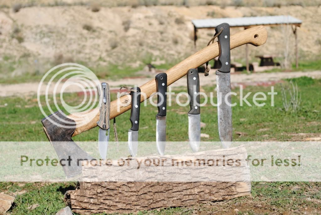

My JKs Hanging out at the campground, where my 4/2 wedding will be held.

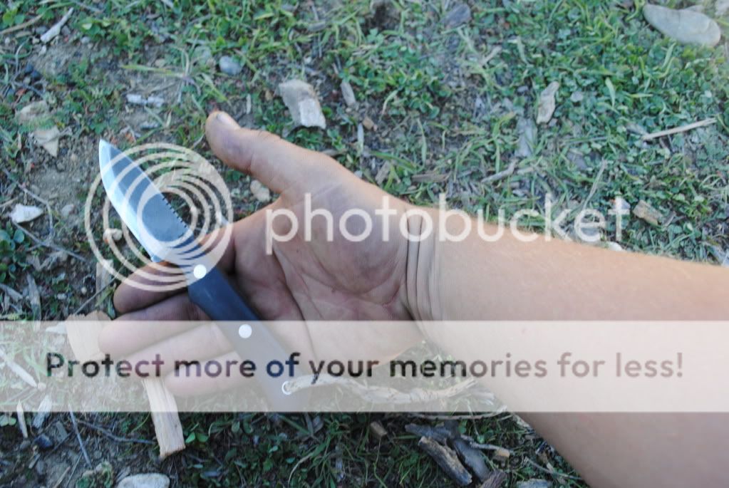

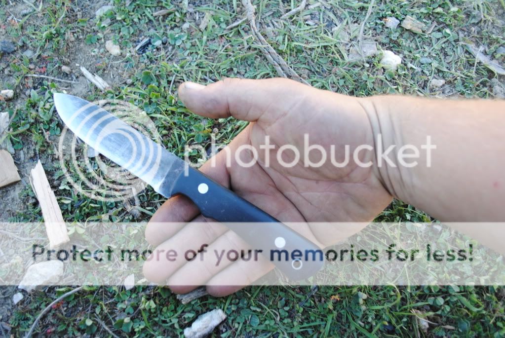

Clearly there is a variety here, so I will speak to the strengths and weaknesses of each, starting with my favorite blade (both JK and all time): My Short, Scandi, Hiker...or what I call Sven's Scandi Scalpel
This thing is the best all around blade I have ever owned. It has been on my person nearly every day since I received it last april. It is small where it needs to be. and the handle fits me perfectly. It excels in skinning and game processing tasks, make fussy sticks effortlessly and slices through everyday objects ad nauseum. I am often accused of having "too sharp a knife when this one gets used. As an outdoor EDC, this knife is perfect. Small and light it makes quick work of any outdoor task. As an urban EDC, this knife s elegant enough, to pass in most any social situation, and short enough to pass even the strictest blade length limitations.
I would love to say there is no downside to this knife, but there is one. While I asked for a scandi, this knife was not ground properly when I received it. There was a significant and obtuse secondary bevel which took dozens of sharpening sessions to completely remove. While I know that John would have done the work had I shared this with him, I could not bare to be without this thing, even for a day or two, after using it just once. So I happily spent the time with my blade and stones, but I am still a bit upset that a knife, custom made, and over a hundred dollars, was not to the specs designated in the order. Indeed I feel the time I spent working on this knife is one of the things that makes it so perfect for my uses.
Along with the scalpel, I have my 4"Hiker and my 9"Camp knife, all three match with black scales and red liners.

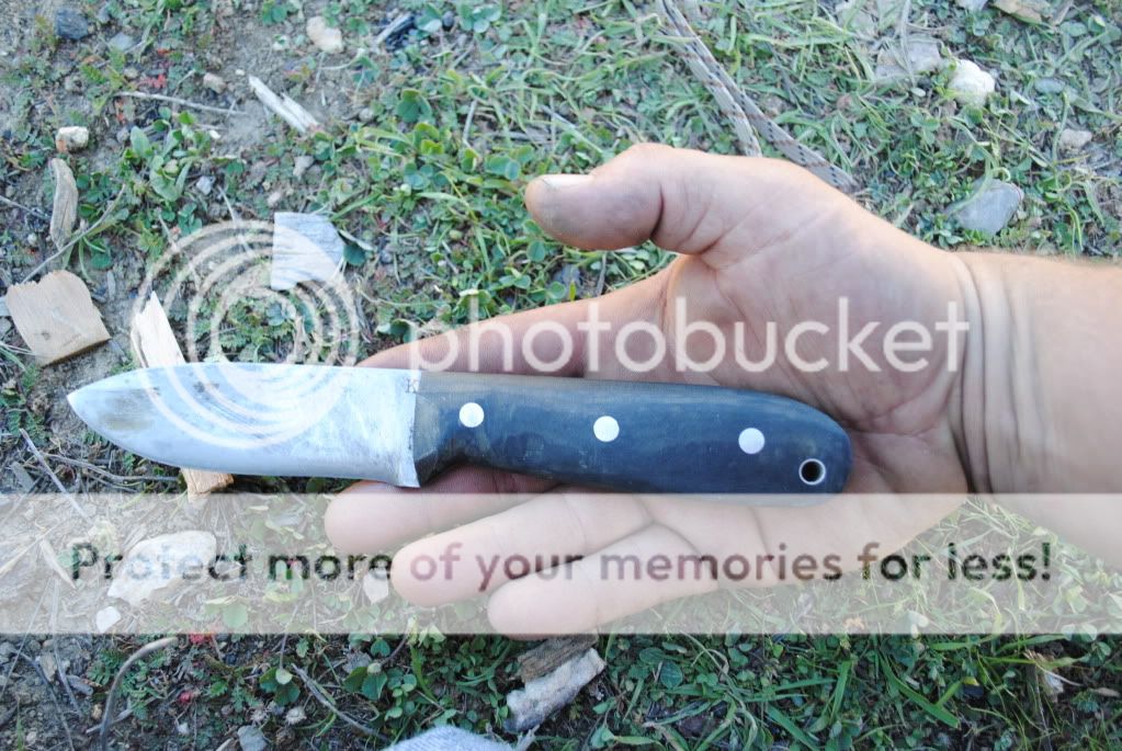

Hiker
Camp
The Hiker was my first from John directly, and I have had the chance to spend a great deal of time with it. I consider it a top notch bushcraft knife. John has the highest quality heat treat out there, and it stand up to serious use and abuse with no damage.

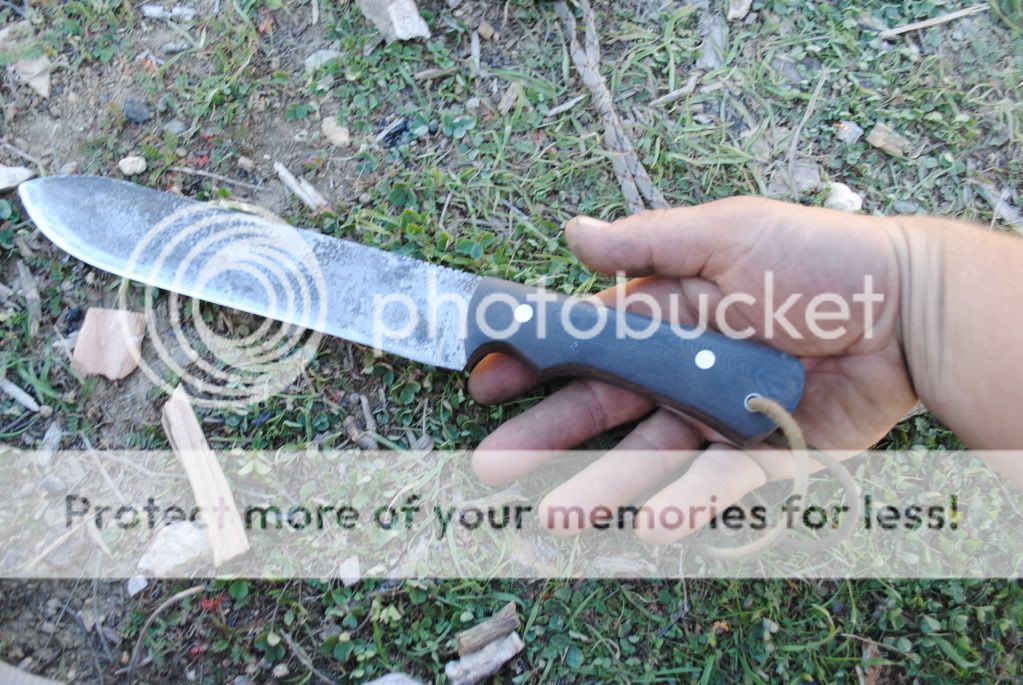

My Camp knife is my newest, and it has not seen as extensive of use as the others. It chops well considering its size, but it is not a dedicated chopper. It does baton like a champ and slices better than I expected from such a stout blade.

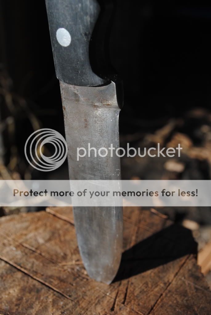

This was a Kephart HD,
I modded it. The large round handle of the Kephart never really fit my stubby fingers. I tried liking it for so long before I finally gave in and reshaped than handle, taking inspiration from my other, more ergonomically designed JKs. I left it rough, to provide better grip (which it does) and I am very happy wit the mod. The blade of this beauty is ground to a full convex, and the blade height is perfectly suited for that type of grind. Like all my JKs this guy is great. the grind I gave it compliments John's heat treat and makes a stout, but delicate knife. Since I modded the handle, I fell in love again.

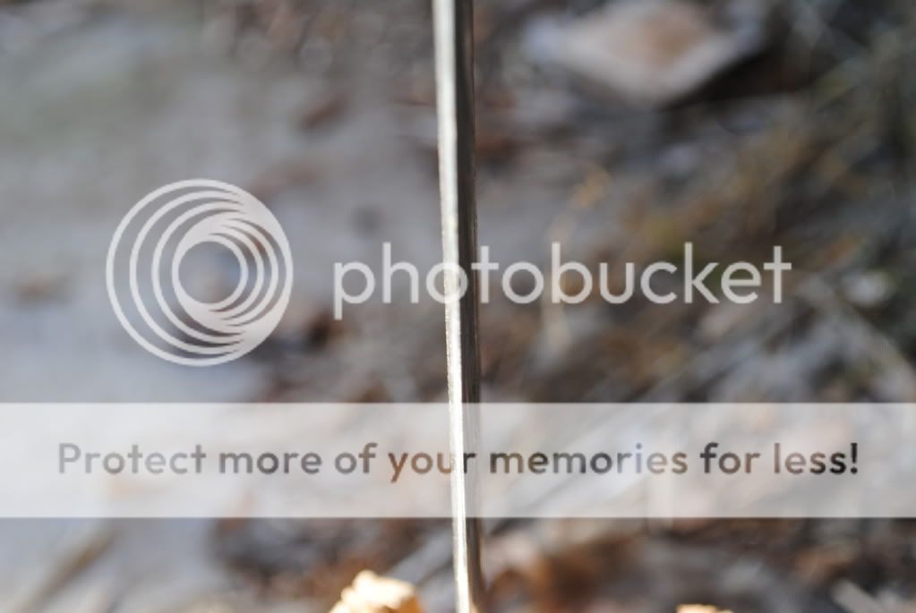

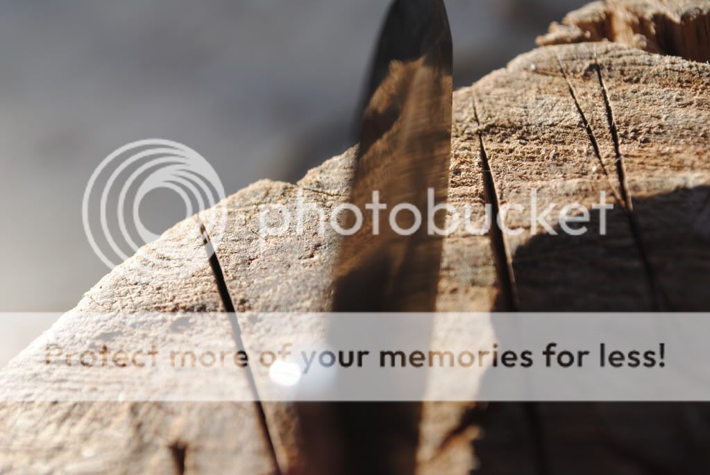

Thanks Pitt, Thats exactly what I mean. I'll take some more detailed photos to clarify. The difference is a full height convex grind, as John does with most of his knives, and a full convex zero grind. The zero being zero secondary bevel.
note the lack of secondary bevel, I know the knife is out f focus, but you can see the scandi with no secondary bevel in the mirror image of the cutting block.

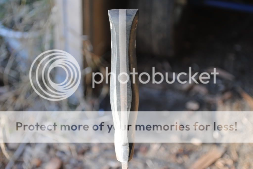

My 9" camp directly head on the blade.

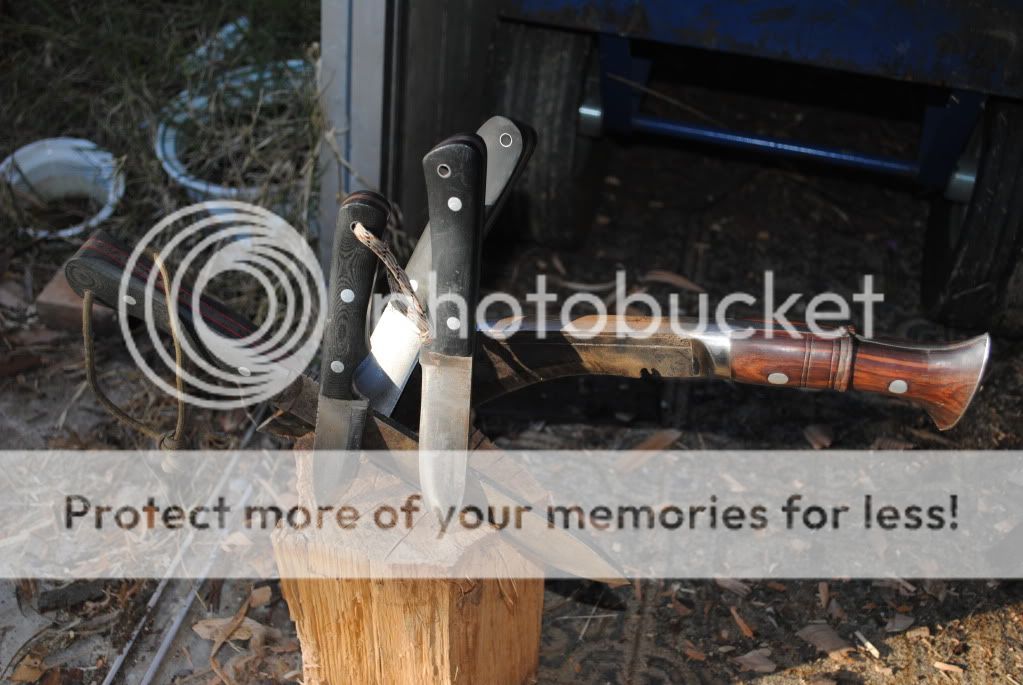

Here they are with their big Asian buddy Kuk.
