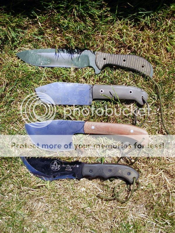

Figured I'd give a few of my knives a little testing today to see how they compare.
These are the knives:

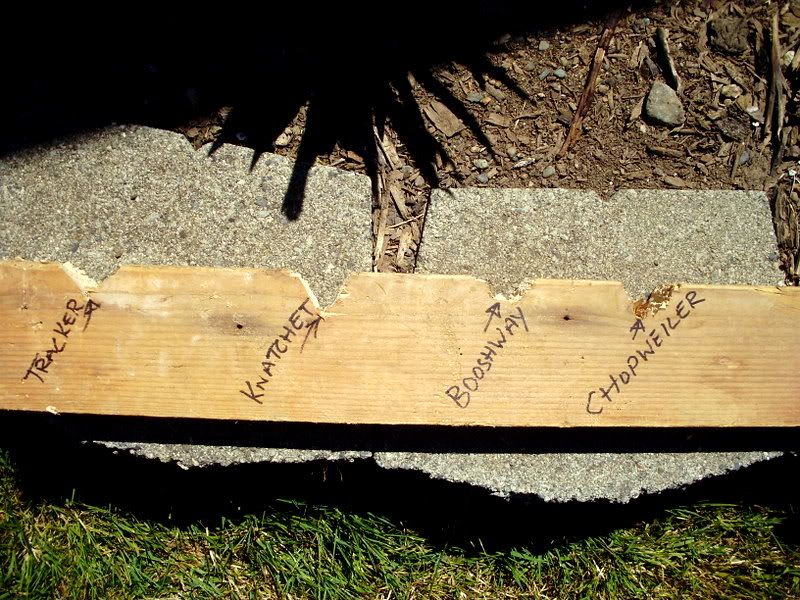

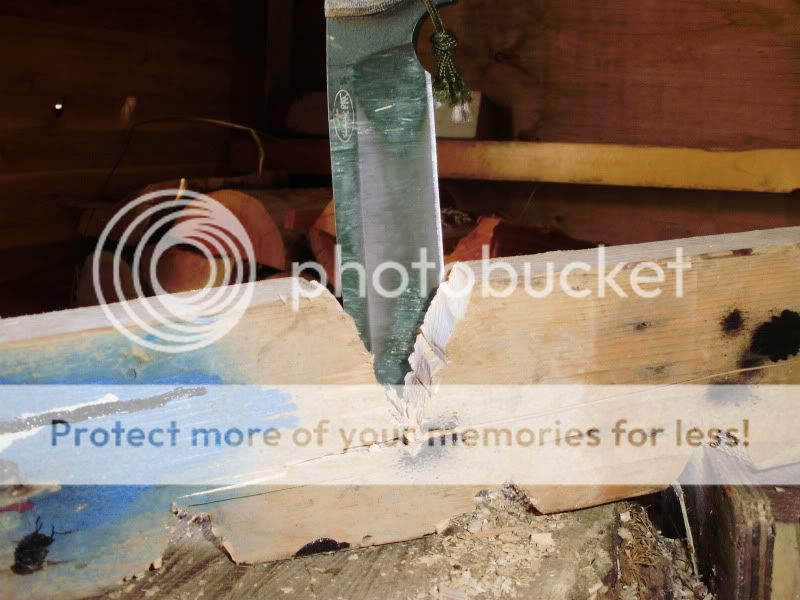

This was the result of 60 chops from each knife.
The Tracker felt very clumsy but appears to have done the best. The Chopweiler really chops with authority and was very close to the Tracker.
The Knatchet felt the best in use and I think in hindsight I could have swung the thing a lot harder.It definitely appeared the most precise to use.
The Booshway looks like it lagged quite a way behind here but in reality it was actually quite close which given the size suprised me.I think it would have caught up with the bst of them after maybe another 20 chops which is negligible in the scheme of things eh !
The V's also look a lot better on the other side of the wood which was the side I chopped. I had to turn it round to write on though as the chopped side had paint on it !

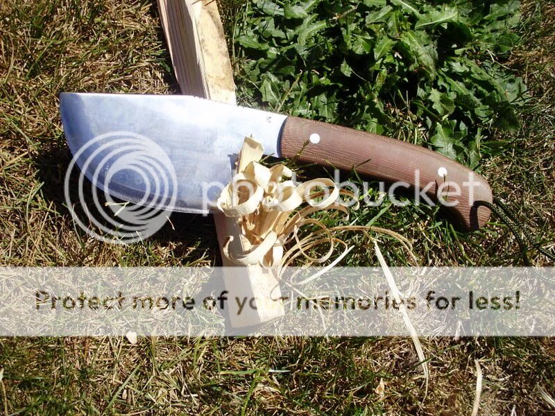

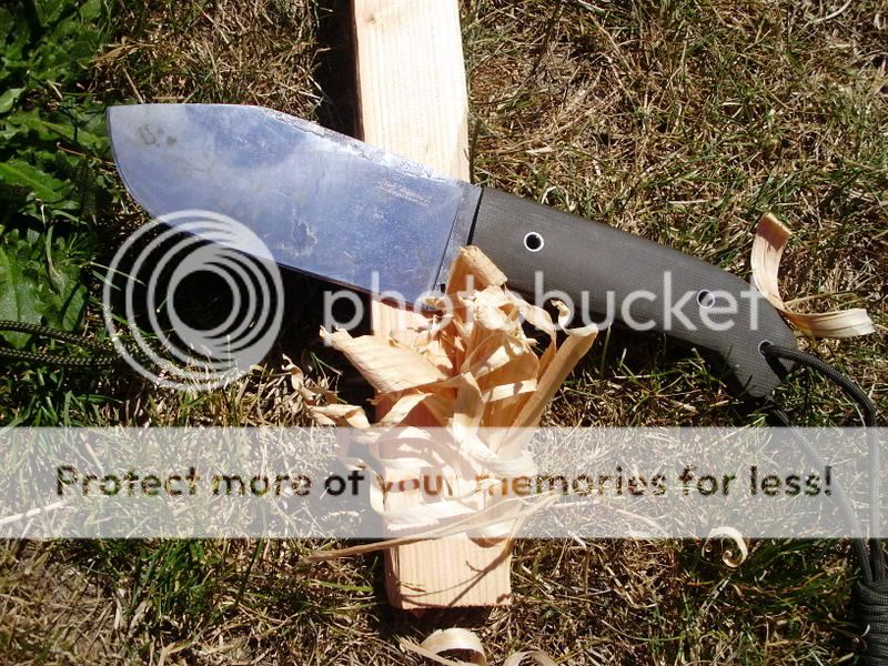

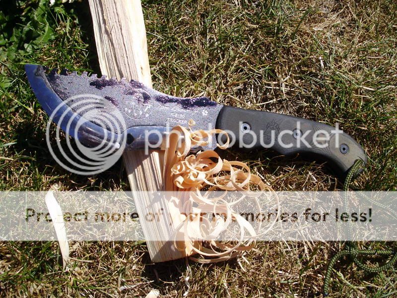

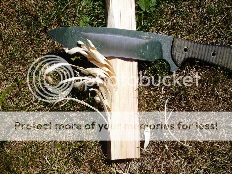

I then used the knives to make some fuzzies:
My technique was pretty poor today but I guess it was consistant so it was poor with all the knives !!!
Suprisingly the Tracker came out top again ! The Knatchet did some really nice curls but they kept breaking off at the end.
The Booshway felt the best doing this and as with the Knatchet did some really nice curls but they came off.
The Chopweiler performs every task pretty well and is just a dependable workhorse !
Snicker picked out her favourite !

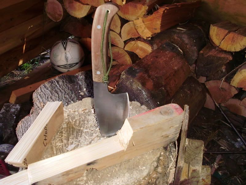

60 ? Damn bro, how wide is that board, and what kind of wood is it?
Ok buddy ya got me, I guess I was using about 60% effort, but that was constant with them all !:o

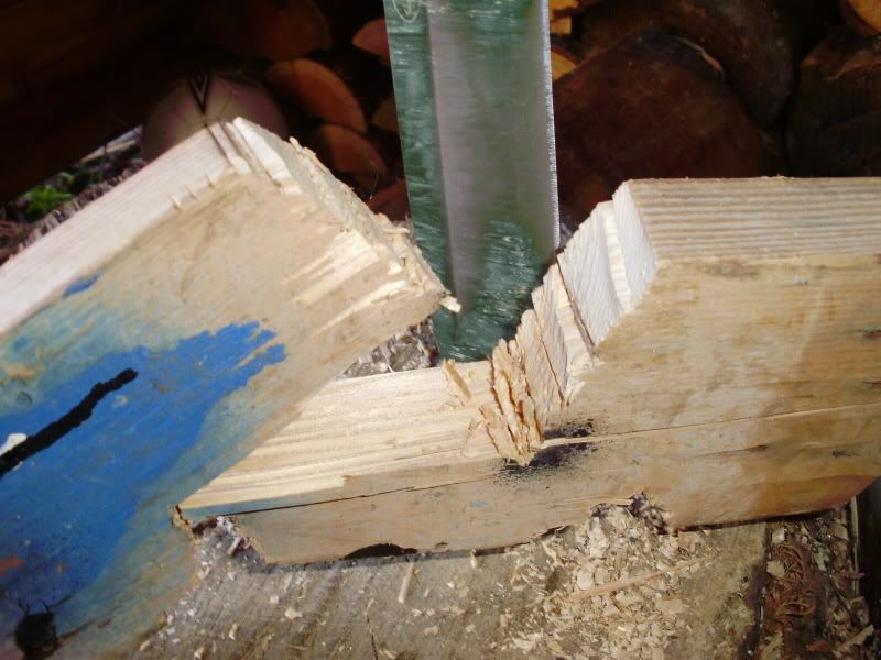

I just went out after your post and tried again at full effort with the Chopweiler, 60 chops......
Just tried the Knatchet at full effort and wood broke at 46 chops, not bad for a 3/16" knife eh !
I was going to say, if that was 60 chops, it better be a hard wood and bigger then it looked! Nice review! Thanks for posting it up.
Good stuff Pit, looks like the Chopweiller won the fuzzy contest to me.

THANK YOU for posting another pic of that board with the chopweiler next to it for comparison. I too was like "60 chops? How weak is pitdog swinging that thing". But now I see how thick it is it makes MUCH more sense. The results are suprising I would have thought the Chopweiler would have came out on top.
In all honesty, I think they all performed enough alike that the proper choice is the one that feels best in hand.
