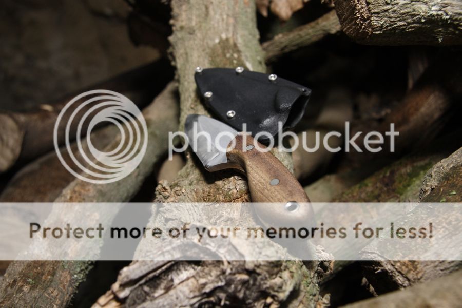

finally found a little time to post some pictures.
I hope you enjoy it but in any case accept any comment!

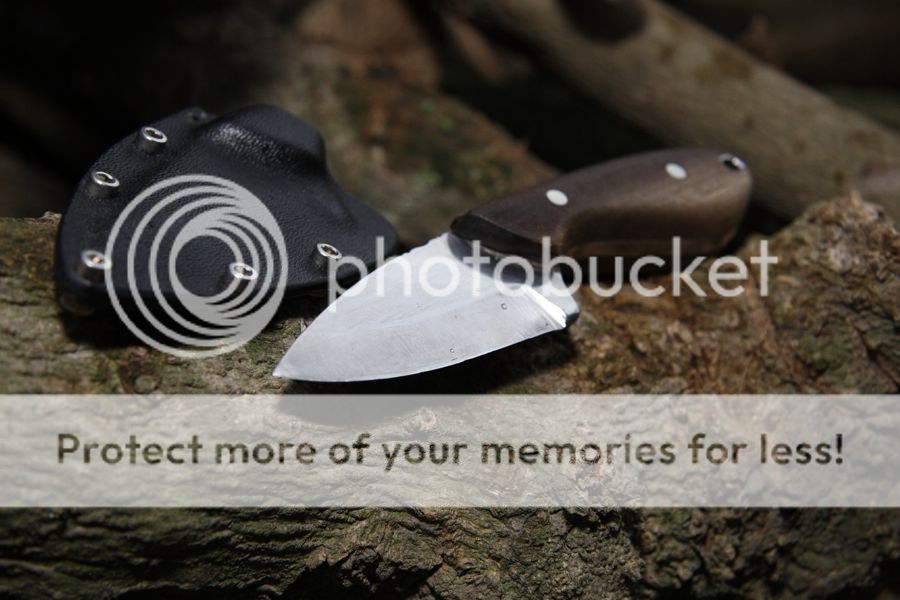

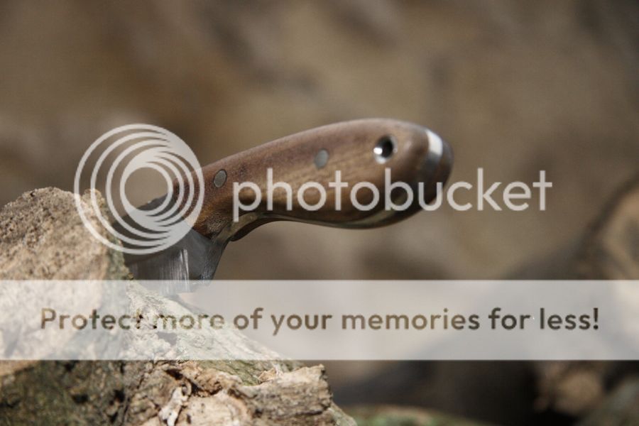

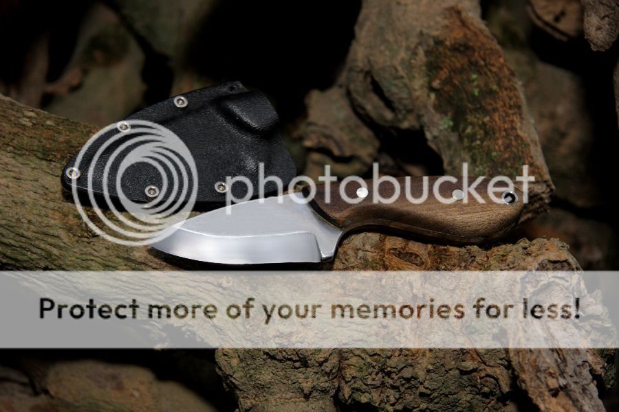

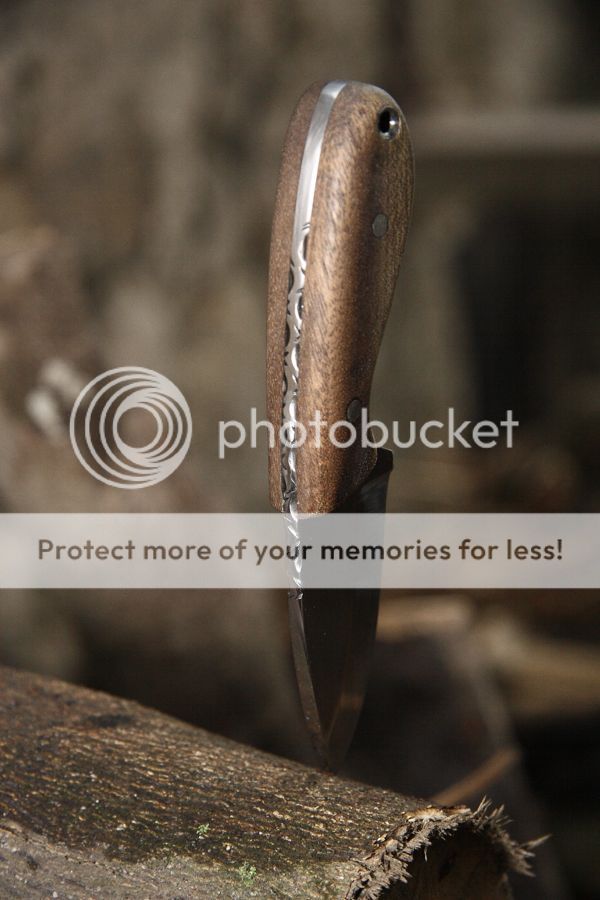

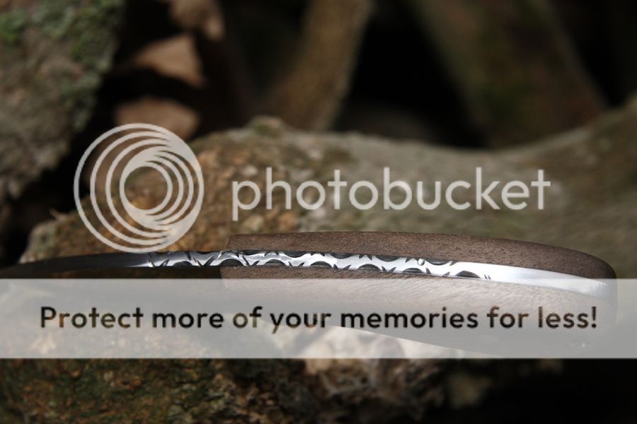

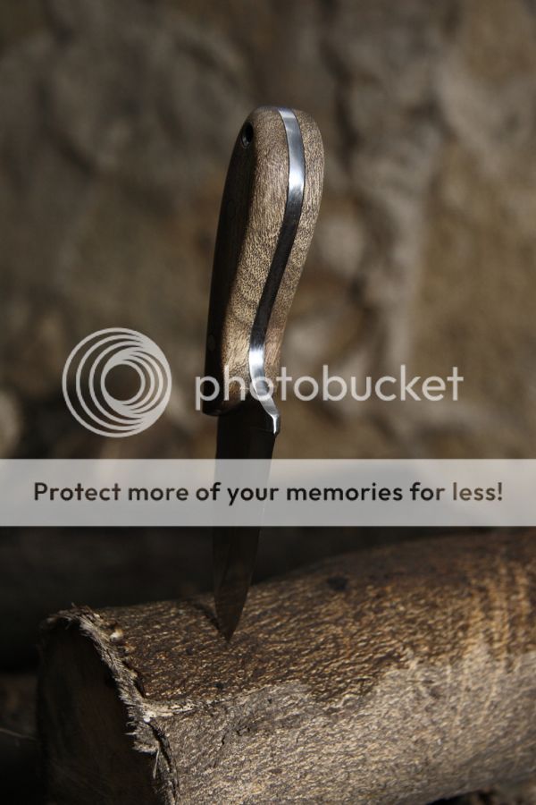

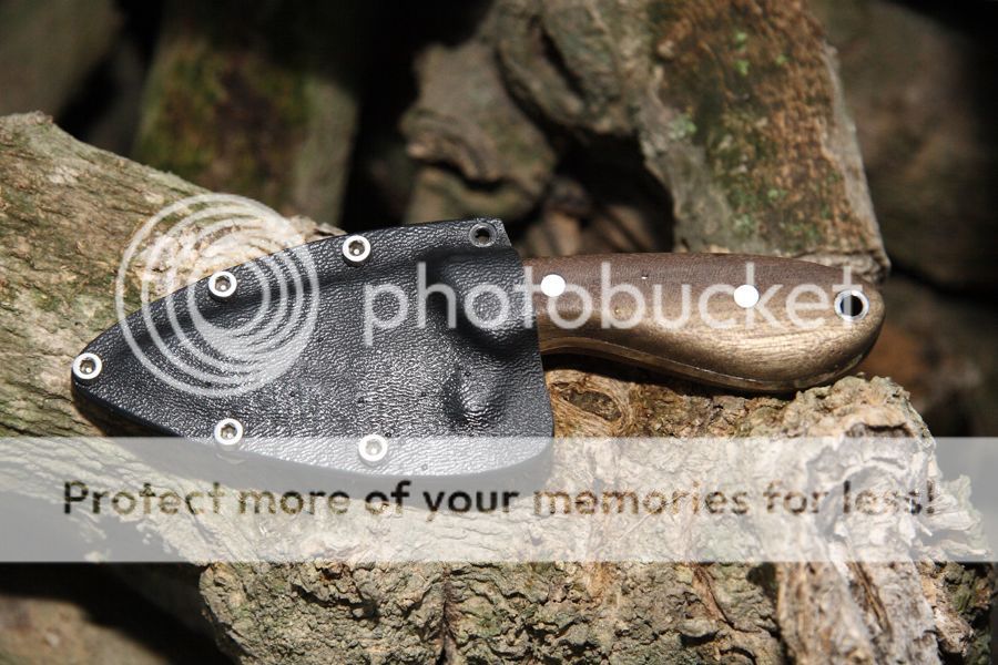

So is Hr1095 4mm hardened to approx. 58 hrc. The pins are plated nickel from 4mm (inch 0,157) and the pipe for the laynard is from 6mm (inch 0,23.
Hickory handle in stabilized. The blade is inch 2.56 with a cutting edge by 2,36 for a total of 5.31 inch approx.
Although it is a 3 fingers you hold well in the chest lever grip (the knob is nice round)

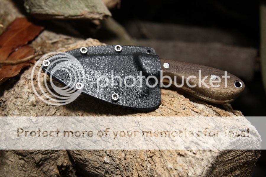

I preferred the sheath KIDEX to give a touch of the old technology turn (I do not think failure)
for screws I had to settle for now with holes allen.

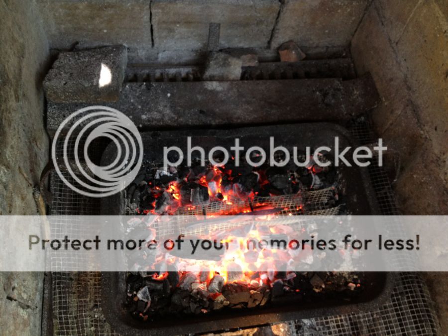

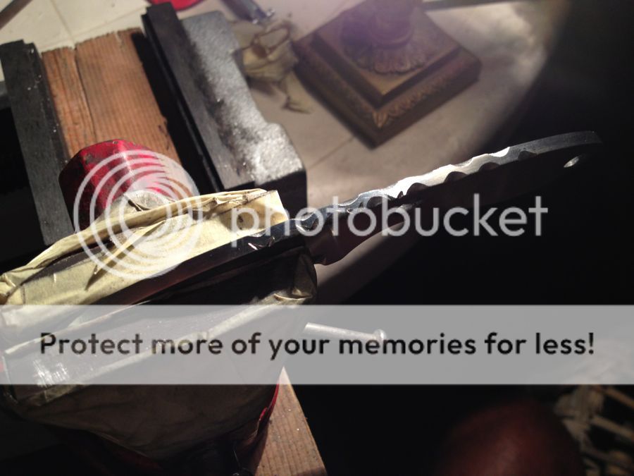

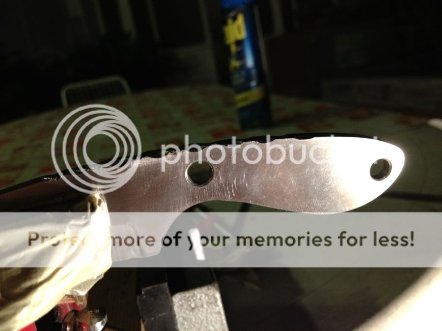

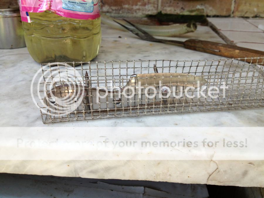

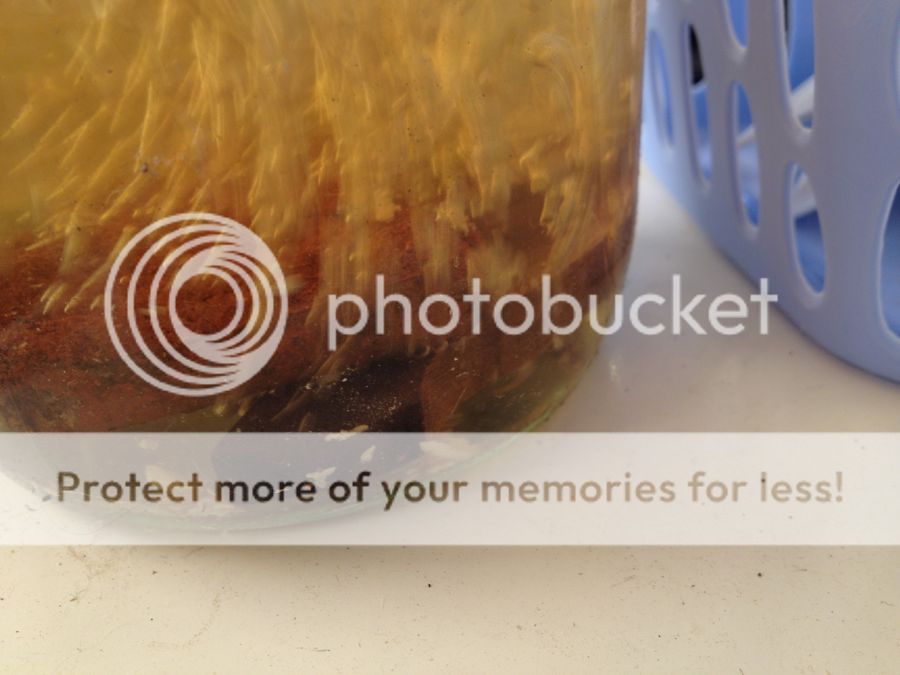

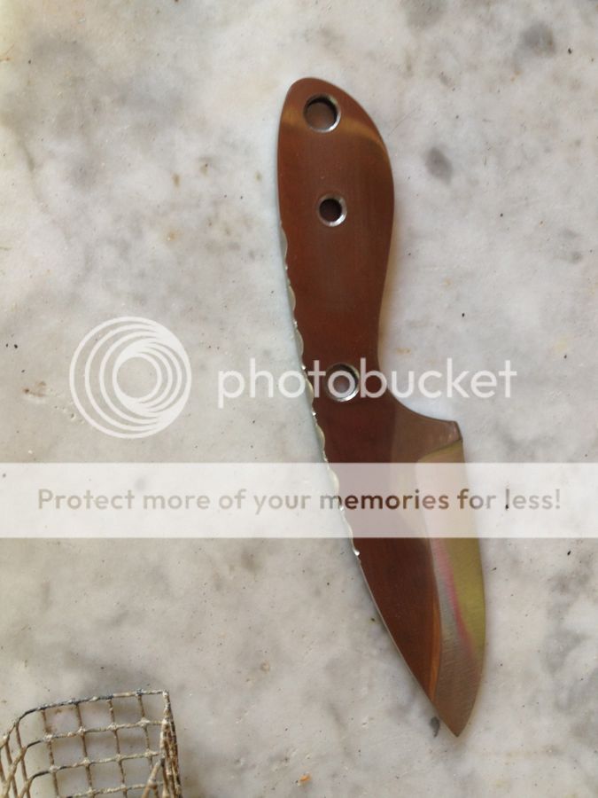

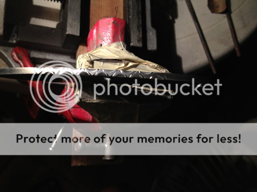

here is some photos during the process

stabilizzated wood
