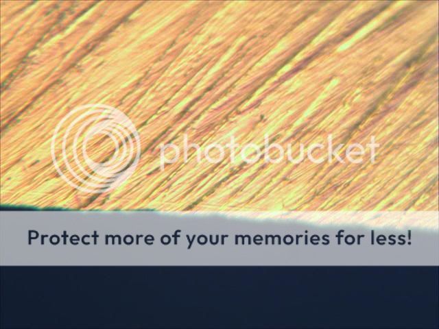

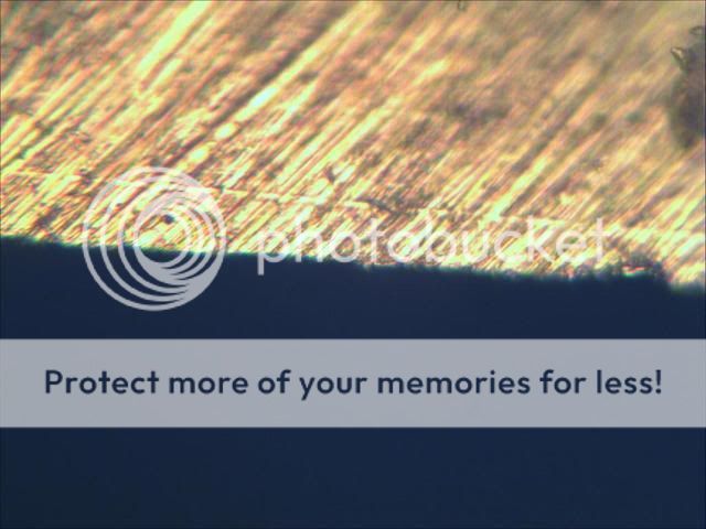

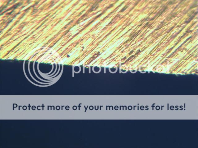

I had to take a closer look at what was happening. I have a pretty good handle on the basic grind I get from a waterstone, so my focus was more on the stropping procedure. Took a 1095 carbon steel knife that had been sharpened up on my King 1200 grit stone and stropped with 6 micron diamond paste (I like a toothy edge). First I took a picture of the edge, then stropped it on some damp paper 60 passes/side and took a pic, finally stropped it with the slurry on damp paper 25 passes/side and took a pic.

Edge following 6 micron stropping on leather
Edge following 6 micron stropping on leather and stropping on paper
Edge following stropping on paper loaded with waterstone slurry
You can clearly see that the wet paper did some polishing - the scratch is a tiny bit smaller and the whole thing is shinier. The pic of the blade post stropping on paper with slurry is a bit surprising. The scratch troughs are a fraction of the size they were coming off the stone, couldn't find the exact spot on the blade for the pic because the reference scratch was unrecognizable.
This is about the best toothy edge I've ever whipped up - sends facial stubble flying and I actually cut my arm shaving some arm hair - only the second time in my life that's happened. .
