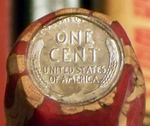

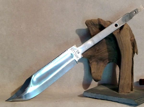

I found this blade in the bottom of a tackle box bought at a garage sale. I didn't see it until I got home, it was wrapped in oily brown paper and stuck in the bottom back of the tackle box. slightly rusty, broken tip which had been reground, no handle material left and the threads cut off the back of the tang.

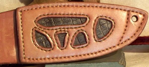

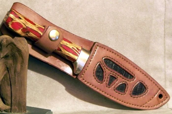

I pondered what to do with this and then I recalled an article in an old (1973) Gun Digest Book of Knives that showed cholla cactus wood being used as a knife handle material. I decided to try this and am rather pleased with the results. The cholla has a lot of character and the red tinted casting resin goes well with it. I debated turn the handle round but decided to leave it bumpy and irregular and it really does feel good in the hand. I sealed the wood with a honey oak Minwax finish and for a touch of whimsy placed a WWII era steel wheat penny into the but as it matches the age of the knife. The sheath in the pics came from a maker in Africa and was a real bargain on that infamous auction site, $12.50 including shipping, the cholla cost me a buck at a pet shop, the casting resin was about $15.00, and I paid $3.00 for the tackle box. Plus I still have a bunch of very nice older lures.
At any rate here it is, a Marble reborn...
