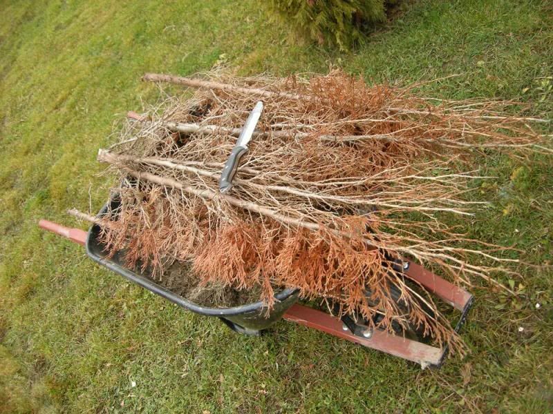

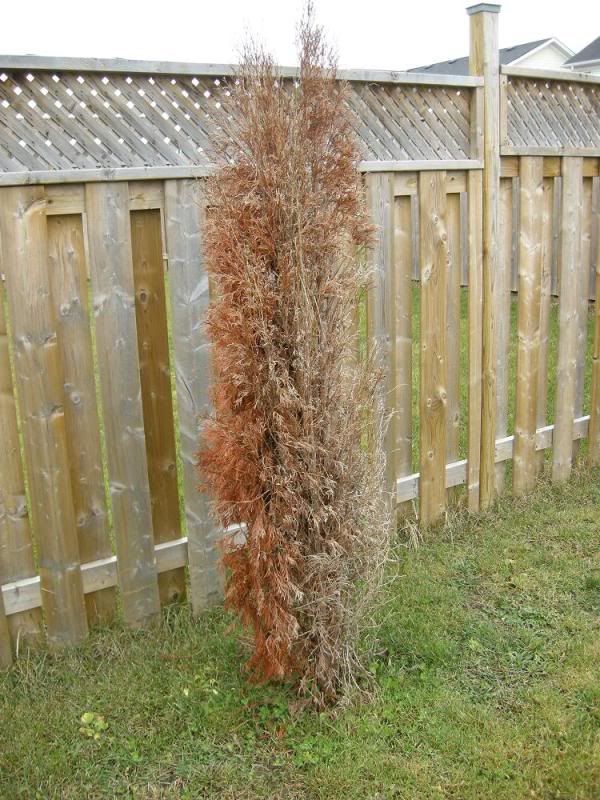

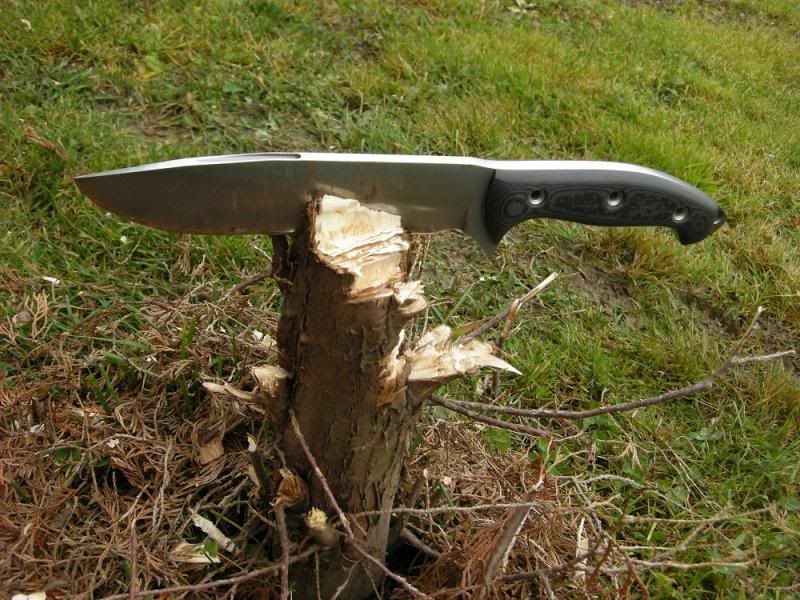

I wanted this one as a camp knife that could do some chopping, and it excels in that capacity. The relatively thick spine gives the blade considerable momentum, and the knife has plenty of bite due to its excellent convex edge. Two days ago, I cleaned up a number of limbs, ranging from one-inch to three-inches thick, and the Camp Blood made short work of them. Yesterday, I split a number of logs by batoning them. Here, the thicker spine and convex edge helped expedite the process. My knife has a fairly thick tip, which allowed me to pound on it with a baton log without any concerns of breakage.

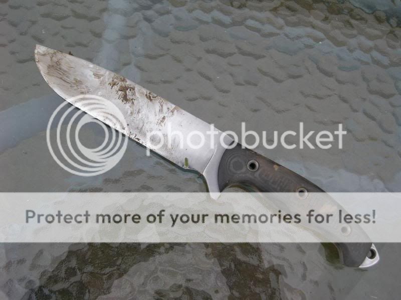

Jeremy takes great care convexing his so-called "Platinum edges." Back when he was still doing modifications, he convexed a couple of my knives that previously had V-grinds, and his work in this regard is top-notch. My Camp Blood edge is flawlessly straight, symmetrical, and polished mirror-smooth. I also know Jeremy invests in his heat treatment, and the edge retention of my Camp Blood reveals how such investment pays off. After two days of various chores, chopping and batoning hard woods, the knife was still sharp to my touch. A few passes on a leather strop loaded with green paste, and it was back to its original razor-like feel.
