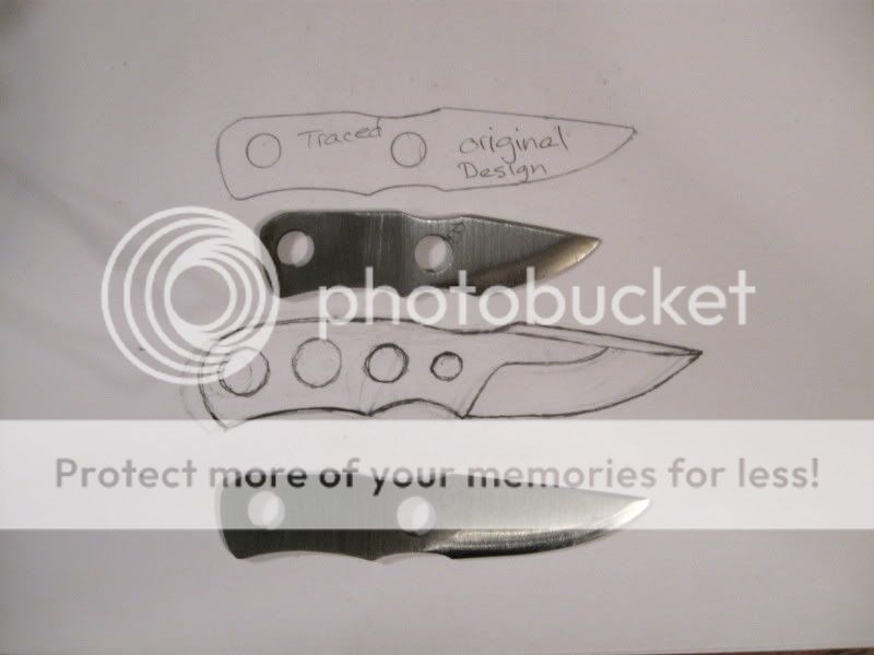

I sent the first drawings, pictured below, off to Bryan and this time it was he who simplified the design a little.

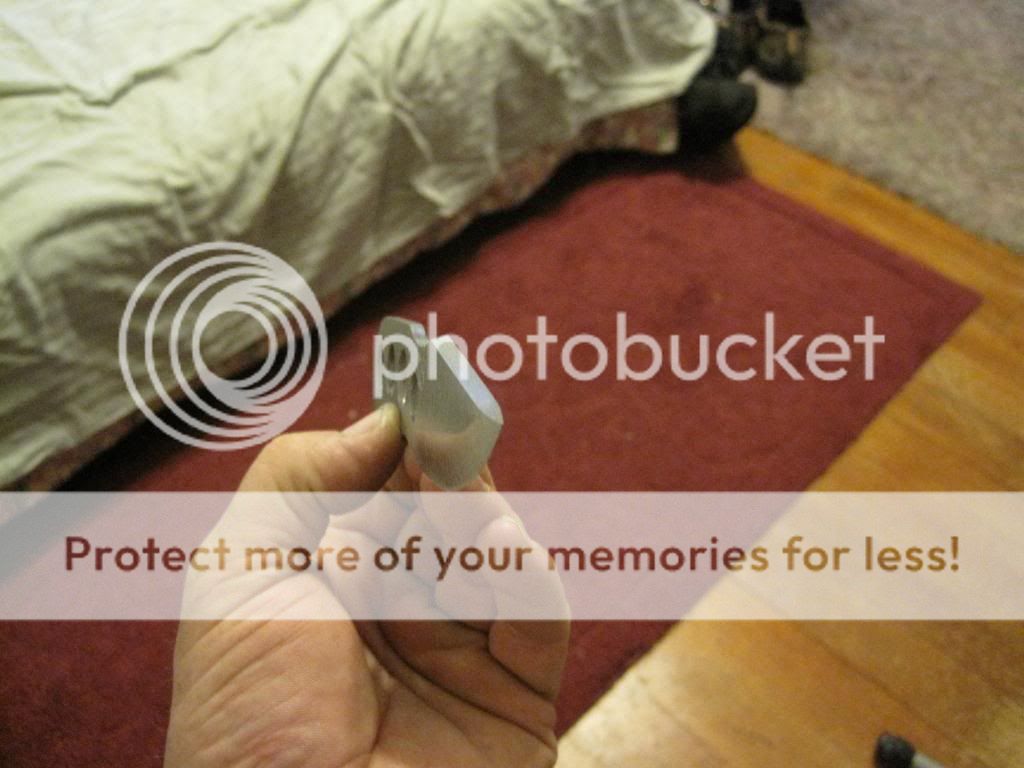

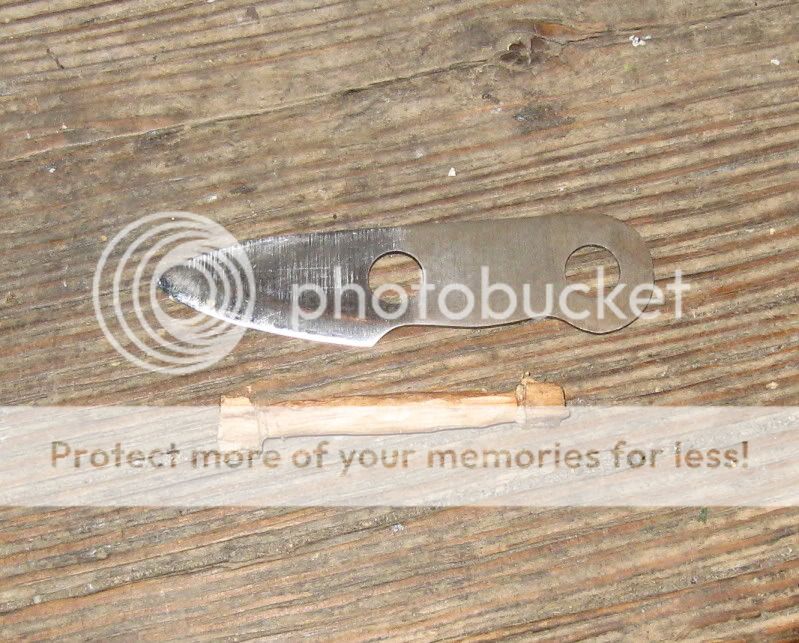

He sent me two prototypes to take out and work with, one smaller one about the same size as a final option knife which I now keep in the pouch on my 1-0…

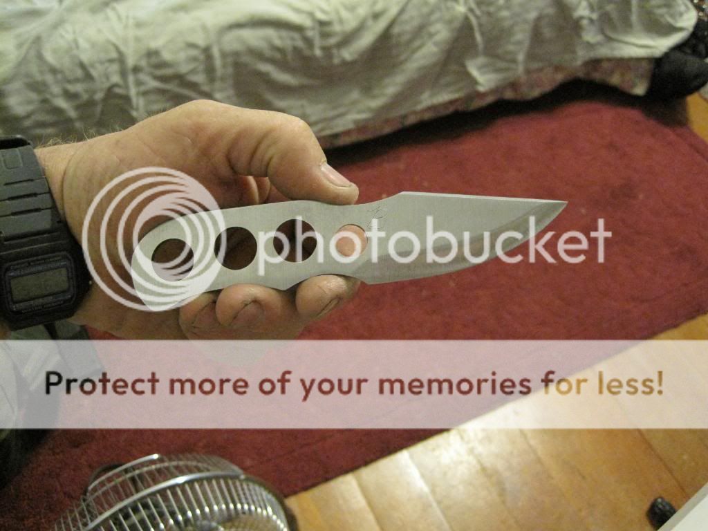

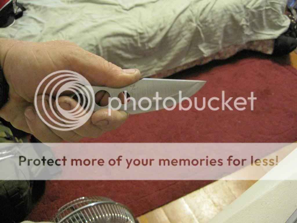

And one an inch longer more designed to serve as more of a stand-alone tool.

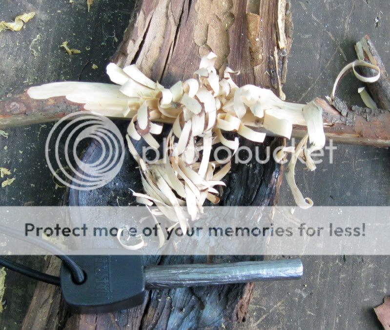

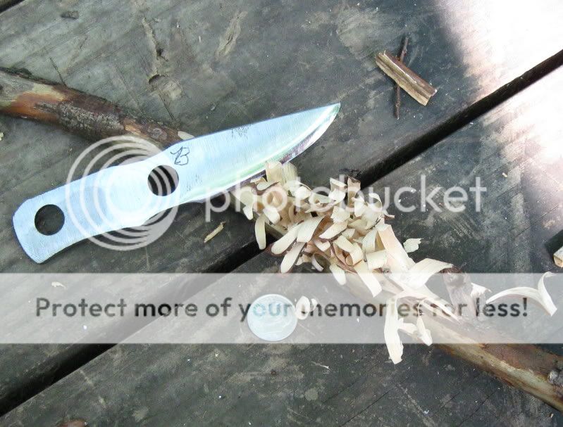

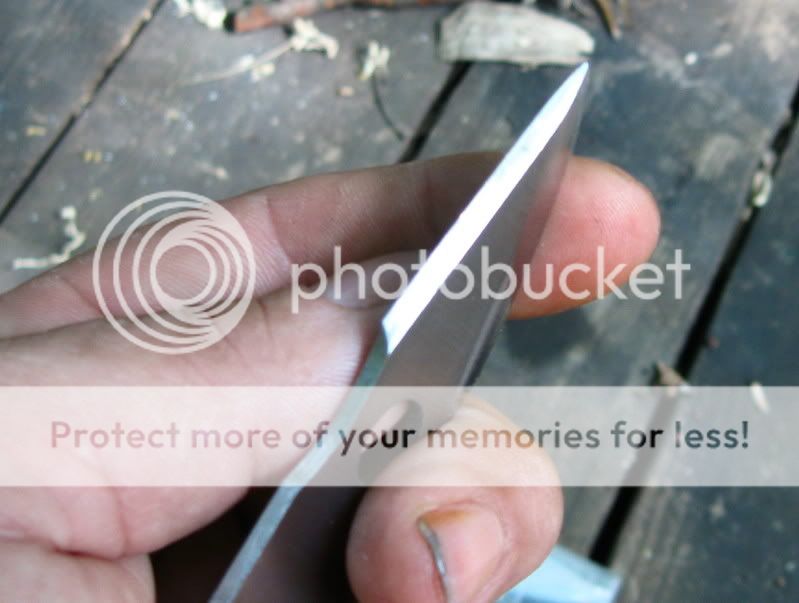

This tool is designed with angled surfaces, the scallop in the spine which serves as a thumb grip has only a slight bevel. This doesn't interfere with it's use as a thumb grip at all and works really well for scraping fuzz from fatwood as I have determined that multi-textured fatwood material works better than any one single texture of material.
The razor sharp edge of the tool works really well for cutting the finer slivers of fatwood….

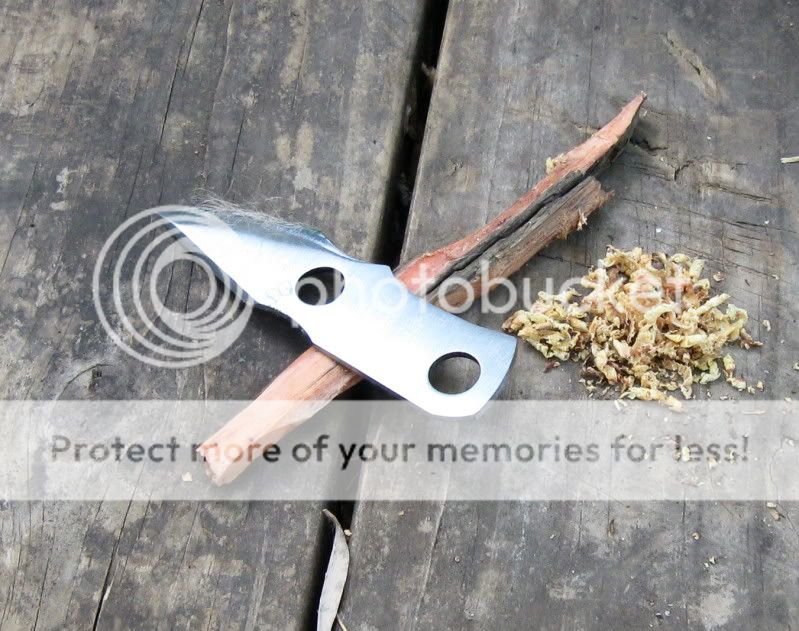

As anyone who has ever tried it knows, the edge of a knife will produce a lot more sparks from a firesteel than even the squarest spine. With this in mind I thought an acute angle beveled spine would work better for a striker than a squared one…I was right.
I also tried the tool on some plain dead pine one afternoon after a night of rain. With the abilities of the edge to cut very fine slivers, and the beveled spine to throw sparks, creating fire was no problem at all.

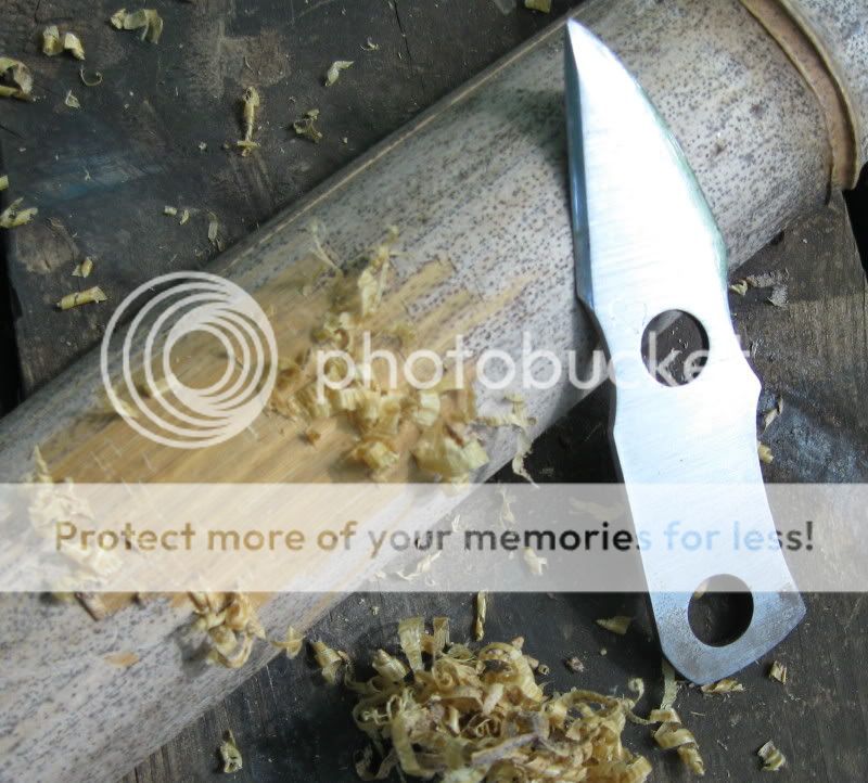

Then I tried it with some Bamboo, also with favorable results so odds are that if there is fuel for a fire in the area I am in, then with this tool and a firesteel I shall have fire.

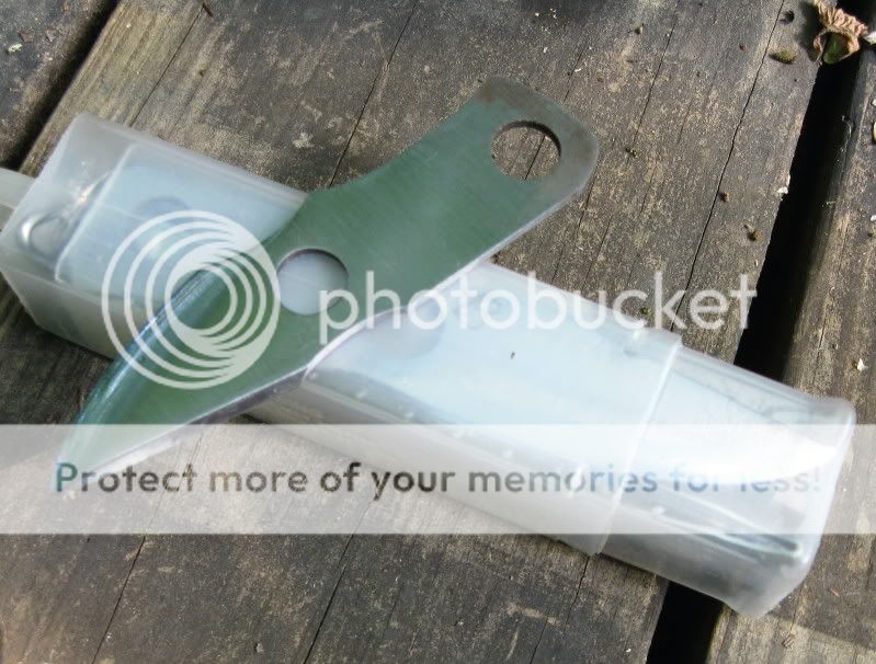

So now I keep the smaller one in the pouch of my knife, and I have put the larger one in a contingency kit I made from an old drill bit case.

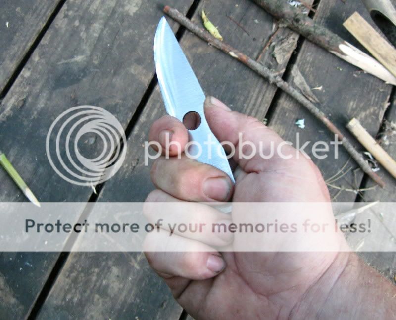

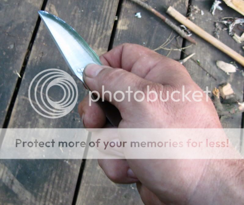

There was a couple of issues I did note in the process of working out the design. The grind needed to be changed so that the front of the "choil" was flat and would serve as a guard when striking. And the tip where the beveled spine meets the upper scallop needs to be rounded over somewhat to make it more comfortable in push cuts and tip work
So now the new ones will look more like this.
Bryan is also working on a version with handle scales for more comfort, as well as a couple of full sized knives based on this same concept. Here you can see one of the concept drawings compared to one of Bryan's FOK's and the prototype Bushlore knife I bought from Rick (Magnussen) .

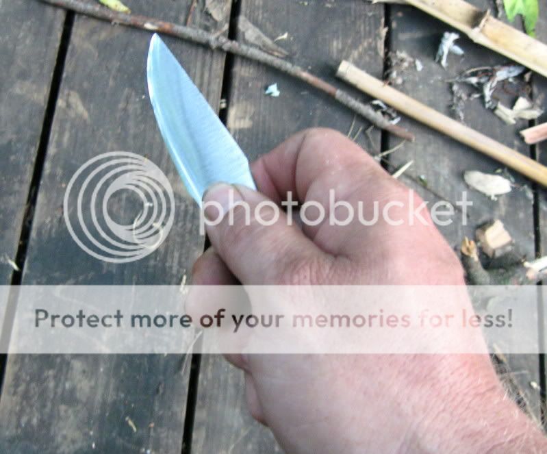

I like it. How will the larger knife's (one with handles) spine be designed if you want to grip the blade and scrape with it?
Do you mean as in holding the blade in a pinch grip and scraping with the edge?
They'll all have a beveled spine for scraping a firesteel...unless requested without it I suppose...however it's only about a 25 degree angle so it's really not all that sharp. I held the larger and smaller ones in a pinch grip while scraping bamboo with no discomfort.
Thanks, I think it does quite nicely. All I did to solve the issues with these two was to round off the point where the blade meets the choil and no more cut finger, and round over the point where the spine meets the scallop and it was more comfortable doing push cuts and tip work.

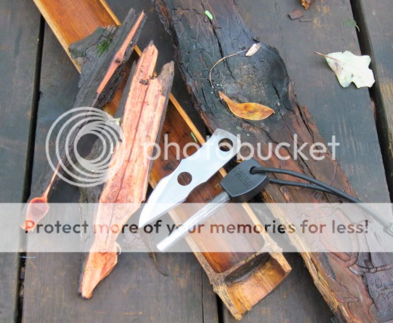

Today, after severe storms passed through last night and a good storm this afternoon, seemed like a good day to practice some firecraft.
Here are a couple of short videos to show what today was like...there were a couple of hours of this.

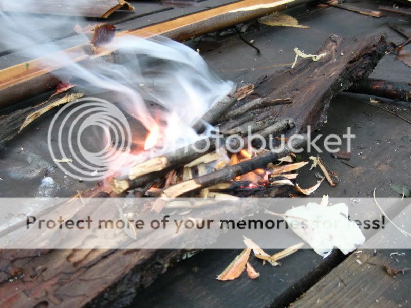

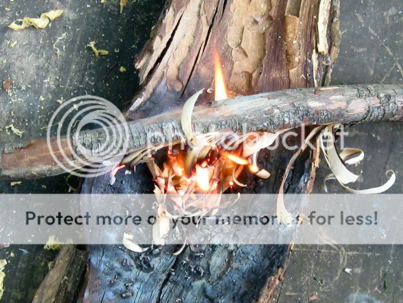

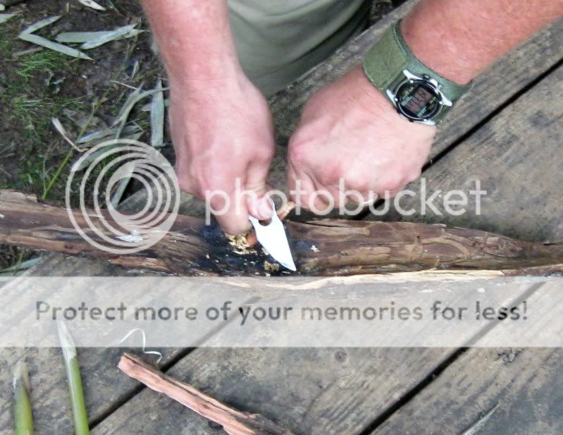

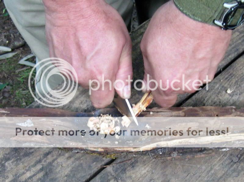

I think you can tell how wet the material is, one of the really cool things about fatwood is that it doesn't absorb water.
and so once fuzzed up good, and sliced thin it takes a good spark well and this little jewel throws great sparks
add a little wet fuel, and you get steam!

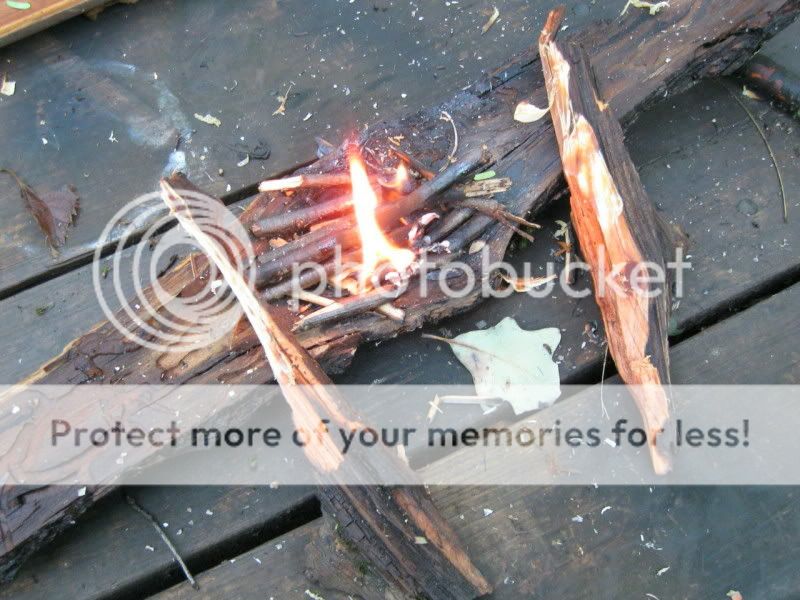

and if you used enough fatwood you get fire.
considering how little I just used...you can get pretty much as much fire as you'll ever want at one time from one good stump...unless you're wanting to make a good signal fire.

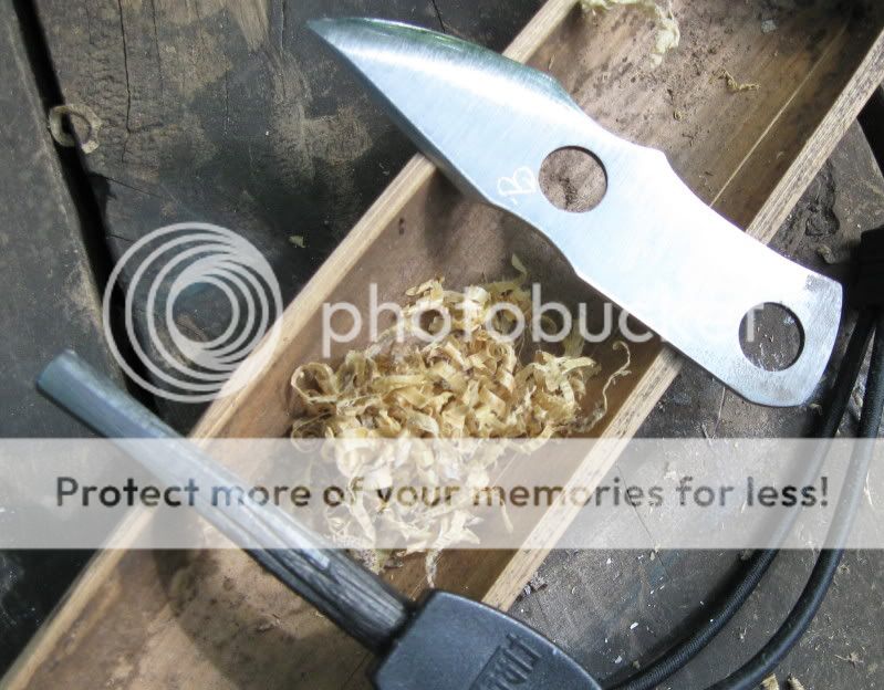

I got the new designed larger one in today, man I really like this thing.
You did a great job at fixing my issues with it by changing the grind and rounding the tip on the spine, thanks!
Today seemed like a s good a day as any to test it so with just these...

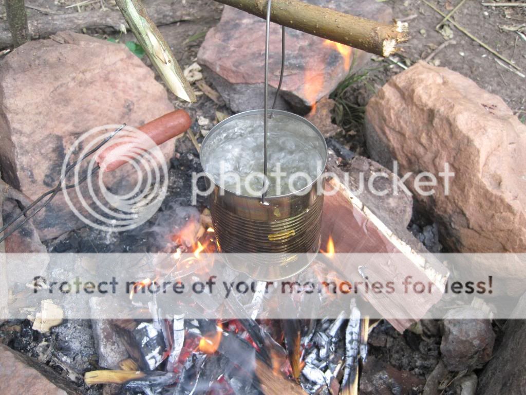

Since it was not raining her today kathy and I wnt out to one of our campsites and had a fire and roasted a few weenies and had some coco and marshmellows :D In this pic kathy is roasting here weenie and I have some water boiling for the coco.

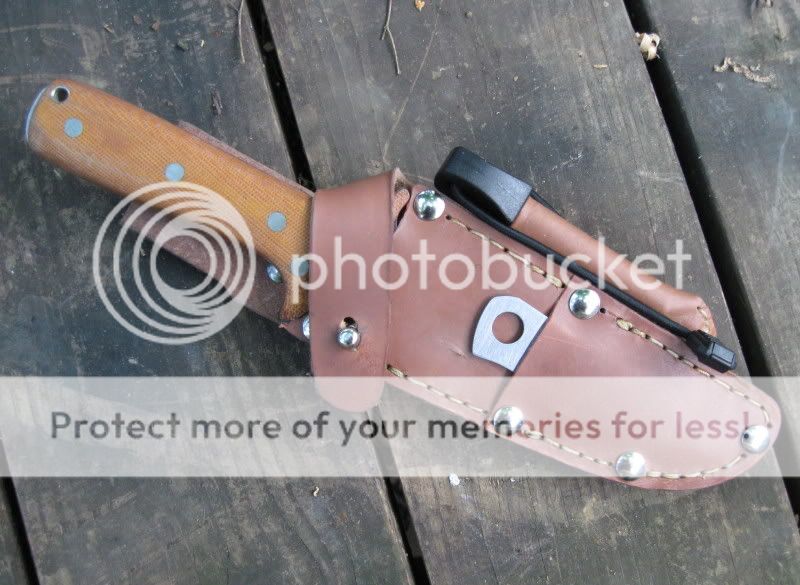

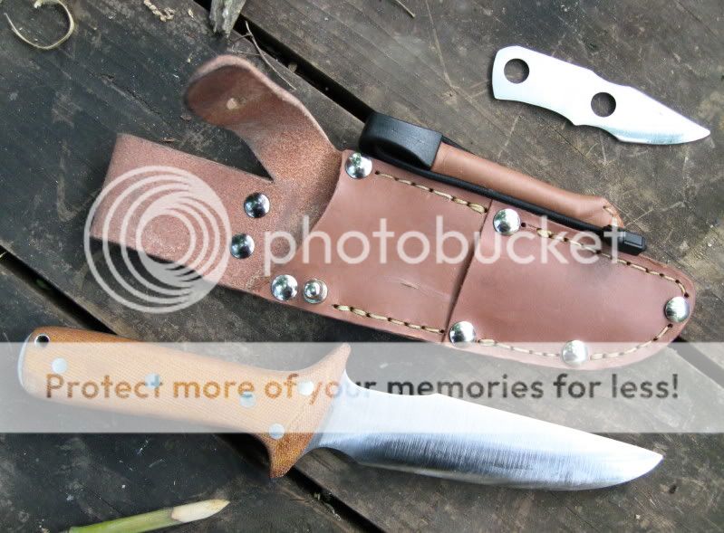

This one is going to be for the back up for my MEGA "1-0" as you can see in this pic.
The striker knife will ride in pouch on the front of the sheath.
In the pic I put my 5.5" bladed "1-0" for comparison to the 10" One Zero.
