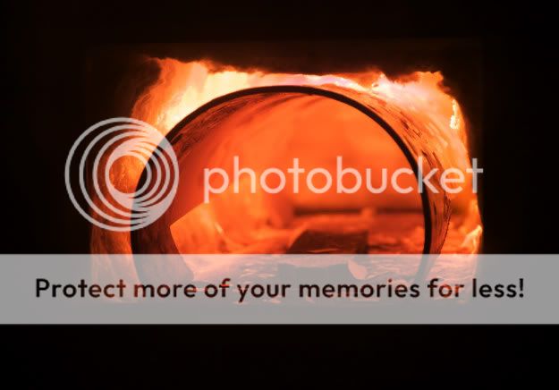

I have been using a locally made forge but have just sold it. It was a 2 burner design with the burners in the top blasting straight down. I didn't like the hot spots it created and unless I treated it like a blow torch, it wasn't great for heat treating. I added a muffle tube but that was hard to control the temperature in.
I eventually put a small "kwansit hut" style cover inside the forge to keep the heat off the work but it has burnt up and I don't really want to get into that cycle as it tends to create uneven heat.
So... I have been looking at two options.. First is to buy a welder and make my own but in the end that'll be expensive as getting materials in Canada is darn difficult. The second option, what I'm leaning towards, is Ellis's forge. In the end this is a single out lay of cash and less than the first option.
Darren Ellis has only the 6" in stock and I was wondering how that works for those who own it. I found that with the muffle tube set up that the knife sucked the heat and it required constant control to keep the temperature steady for HT'ing. Will I have the same problems?
I am also interested in the Riverside vertical forge but I think with that I am not getting all the parts so I would have to place a second expensive order to get what I needed to get running.
I will eventually get a welder and do a dedicated HT forge but until then I need something that'll do it all.
I like the Chiles too but I do not like the direct heat. Any other forges out there that would suit my wants?
I also like the Little Johnny forge but I'm not sure about shipping to Canada and doesn't this fire the blast straight down in the middle? How does this one deal with hot spots.
And finally, venturi or blown? I like the convenience of the venturi as I don't have to source a blower but can I control the temp of the venturi Ellis forge enough for precise HT'ing? (I have a thermocouple)

I cannot comment on other forges as I elected to go with the Ellis forge to start with. The forge has held up well despite my attempt to destroy it with super heats. I finally got a thermocouple and started using the forced air and after relining the forge it holds a steady heat...more than adequate for steel appropriate forging temps and HT.
The only thing I had to do was switch to a larger propane tank. The smaller ones would start to freeze followed by a drop in pressure and temperature.
The heat is even within the forge and a really nice reducing flame can be easily tuned in.
