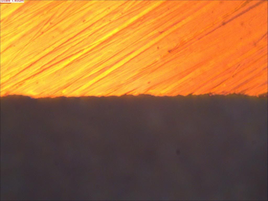

Was tinkering with a bit of .5u CrO compound as a follow up to my 4k compound on my work Washboard. I don't normally go finer than my usual 4k-6k so this is out of the ordinary for me but I hadn't taken out the microscope in a few...
The edge was dropping hairs and treetopping a pile of leghair with each pass. The edge could be even more true if I'd done more stonework leading in, but still pretty good for relatively little effort. Scale upper left is just under 1.5u, single red blood cell is about 5 of those scale marks end to end. My usual edges are three finger sticky and can just treetop leghair and dryshave facial stubble.
