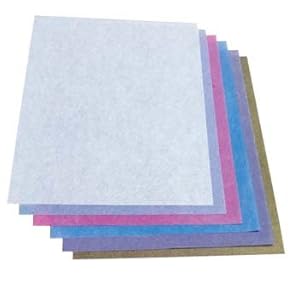

I have some of the 3M stuff, in full-size sheets (maybe 8-1/2" x 11" or so). Sort of a fine, thin mesh. Kind of like a Scotch-Brite pad, but much thinner, like fabric, and impregnated with aluminum oxide abrasive. I used it for finishing touches when I thinned & polished the blades on my Opinels (doing the heavier work with wet/dry sandpaper). Don't remember what the grit was, at the moment. Only thing to watch out for, because it's a mesh and has some 'give' to it, is a tendency for it to roll over/around the edge when 'stropping' on it.
(Edit: The 3M stuff I have, I think is called 'Micron Polishing Paper', but that's a little mis-leading, as it's more like a fabric mesh. I have it in 9/3/2/1 micron grit. Edited sheet size info above. Got it thru Amazon, pic below...)

Maybe its Micro-Mesh. I have some of the 3m cloth too. Pretty handy stuff. I originally used it on pool cue shafts.
