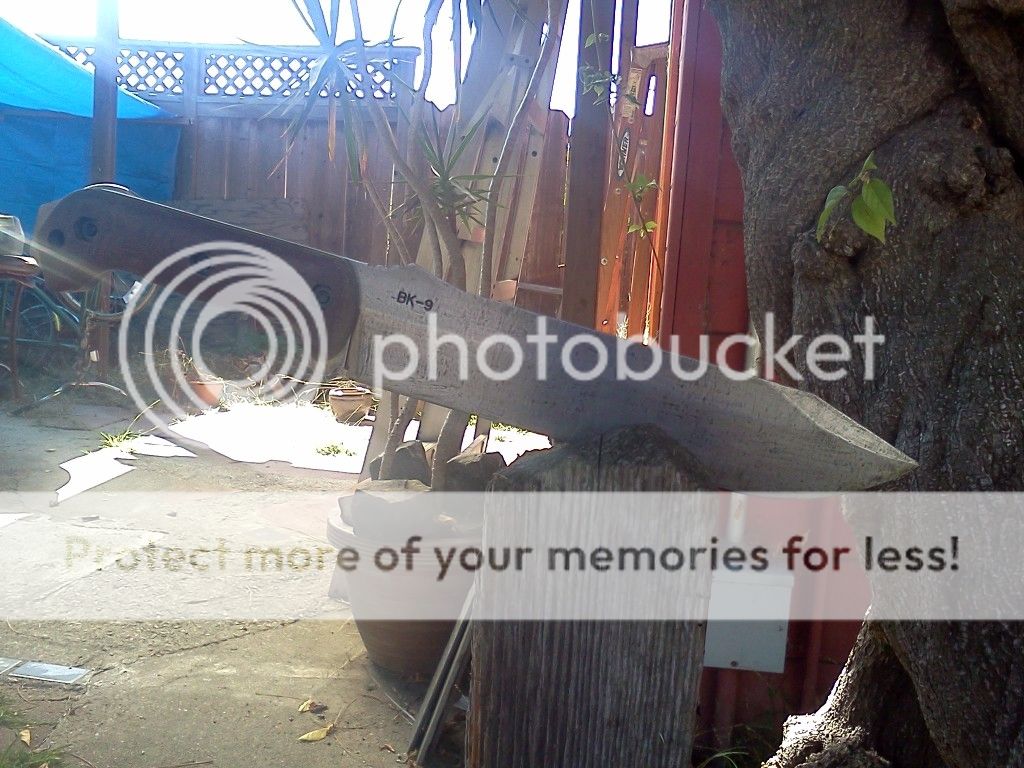

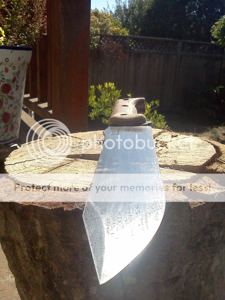

I hit it with some 120 grit followed by 600 (just what I had at the house) then gave it a vinegar bath for about 40 minutes
Does anyone know how to give it that dark uniform grey? I'll definitely be saving up for a new bk14 and all the goodies. That was my favorite edc knife I have ever carried.

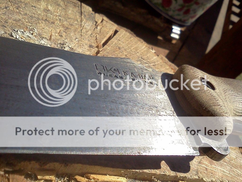

Gun blue might be a good bet for greying out the blade. You can also leave it soaking in vinegar for a few hours.
Total bummer dude. I despise thieves man... to the point that it be more dangerous to me if I were to catch one...
A white vinegar patina on a CLEAN blade. Wash it with hot soapy water and then rub it down with rubbing alcohol and a paper towel... DONT TOUCH THE METAL. Keep your hands off of the blade and after rubbing it with alcohol, rub it down with white vinegar paper towel. Just a couple of passes and blow on it to help it dry... or have a fan near by. Rub the vinegar on and let it dry repeatedly for about 10 min or so...
Once you're done, rinse it off and wipe it down with a clean paper towel. Should have a nice uniform patina. I usually strop the blade grinds afterwards too. The polished edges look good to me and makes it nice and smooth.
Here's my newest 2 that I did just that to this weekend:
Sorry about the backpack, hopefully the police catch him doing some other stupid sh*# and find your backpack and knife. And go with a warm apple cider vinegar or white vinegar bath. My bk2 came out in a nice dark grey with acv uploadfromtaptalk1347970992751.jpg
