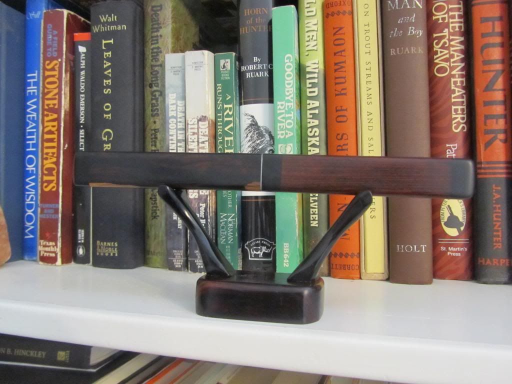

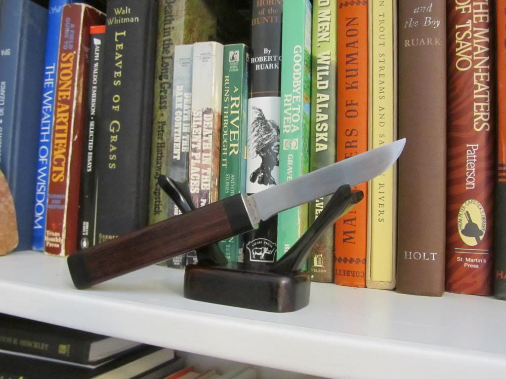

Here's the first knife I made from one of the files that my FIL gave me. This one is sitting on my desk in my home office and makes a great little "desk knife" for opening letters, trimming finger nails, and any other little thing I can find to cut on during the day.
8" OAL
3.5" blade made from a small file
Handle/sheath is made from Cocobolo wood and Gaboon Ebony.
Stand is made from the same cocobolo and ebony wood.
I didn't have many materials at this point so the SS ferrule/spacer you see is a piece of a 6" SS ruler I found in my garage.
So this is the first "knife" I made since 16 years ago when I was in HS. The pictures are kind of poor and make the colors look washed out but it's a pretty cool little knife.

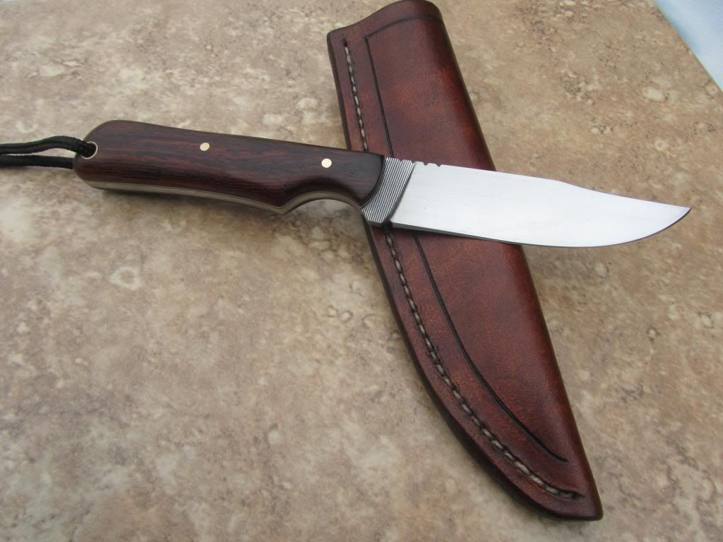

At the same time I made this first knife I also took one of the larger files and profiled it and filed the bevels on it. Then I started reading about "mystery steel" and decided to scrap it and put it on the back of the work bench and ordered some real steel to work on. I made 1 knife out of some 01 that I ordered and then went back to finish the other file knife just to get it out of the way. I planned on giving it to my FIL as a thank you for the stuff he had given me.
I finally finished the knife the other day and shipped it off to my FIL. He didn't know i was doing it but when he got the knife he called me up and was literally in tears saying how much it meant to him and how he would now have something like this that he could remember his grandfather by and cherish the rest of his life. He even called me an artist. Now I've seen some of the work you guys on here do and this is a pretty basic knife and I'm no artist but that's a pretty rewarding feeling to know that I made something that is that special to someone. I've never had that experience before with anything I've made.

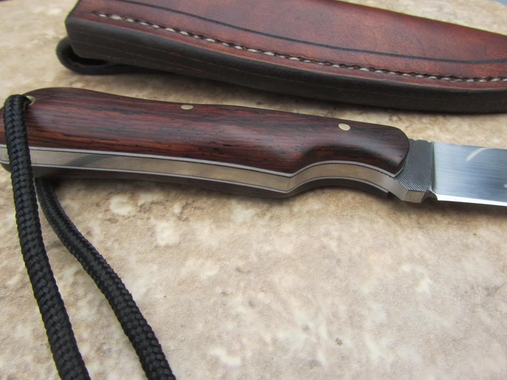

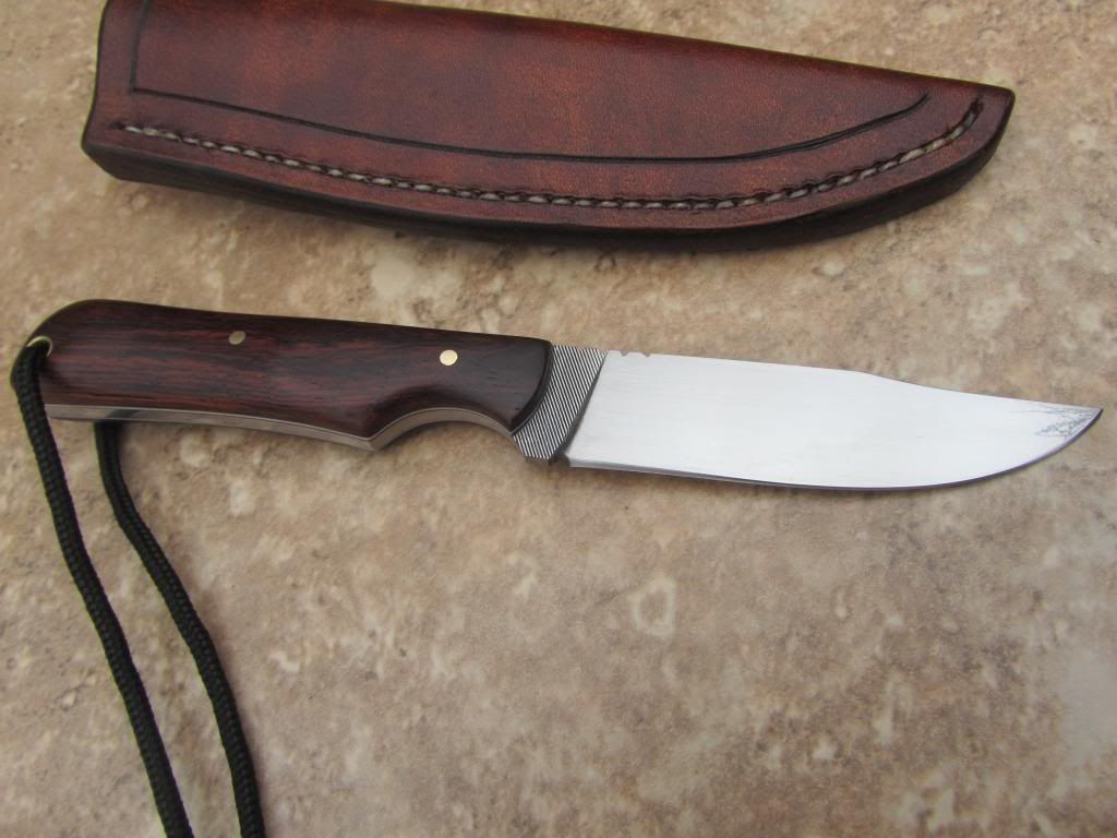

Blade is about 4" long and probably a little over 1/8" thick on the spine at plunge line with distal taper to the tip.
Cocobolo scales and contoured handle.
white liners
brass pins
blade hand rubbed 1200 grit finish
file work/jimping- bad mistake but I did that when I first profiled the handle and couldn't go back an undo it
There will be no file work or jimping again by me anytime soon.
Really stinkin sharp and easily the best cutting/slicing knife I've ever had. The blade was ground down very thin before putting the edge on it(I don't even own a caliper yet so couldn't tell you how thin). I finally bought a little 1x30 grinder which I used to put the edge on this and sharpen it. Put the edge on w/240 grit belt and sharpened progressing up to 1200 grit then stropped with a leather strop I made.
Sheath- the 2nd item I've ever made out of leather. Turned out ok but not even as good as the first sheath I made. Top needs to be wider. I need to wait until the dye dries before stitching because the white thread looks dirty. The edges look bad because the edge beveler I bought ended up being a lot bigger size than I need so it cuts too much material and makes the side look more rounded than I would like.
I think the dark stuff on the tip of the blade is the reflection of a tree
I don't really like how straight the blade and handle are but was limited with what I could do due to the size of the file it was made from. I guess I could have heated the handle in the forge and bent the handle down a little at the back but wasn't sure if that would cause any future issues or not. The contoured handle and thin/sharp blade make it feel really good in the hand when cutting though.
Sorry for the long post but just wanted to share 2 of my first 3 knives and see what you guys think. I'm always open to positive or negative criticism/feedback and I'm well aware that there are a lot of imperfections in these 2. I'm hooked on knife making now so I'll be around here for a while I imagine. Just trying to scheme up ways to get a real belt grinder now...
