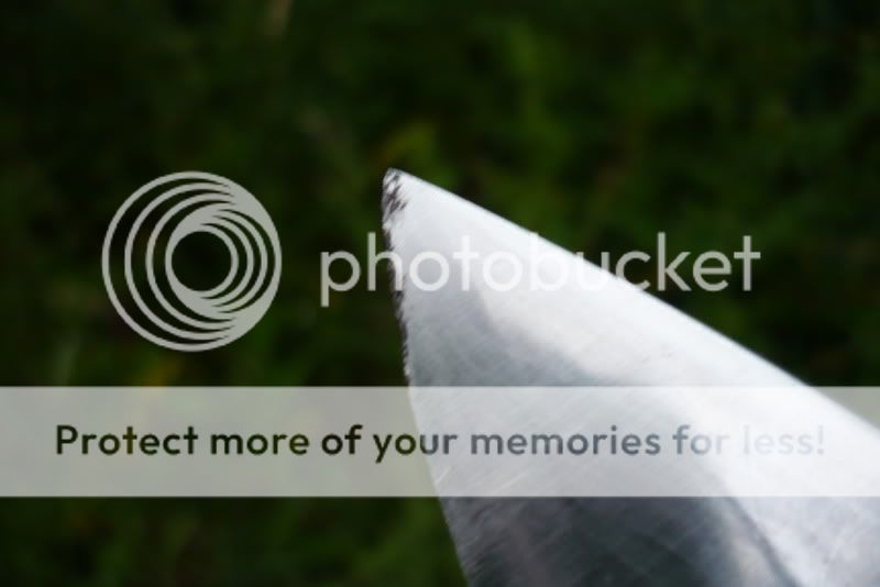

Now the above cover off proper sharpening and topping up ... but if you ever "dink" an edge on a stone and it is Infi you will likely see a burr and roll of the steel ... something like this ...
To save the metal and reposition this into alignment with the edge get yourself an old tool steel large screw driver ... not ideal for field carry ... but until you have done this a few times this is what you want. Clean the dinked area and look which way the metal has rolled ... you need to steel the metal back into alignment so you run the rounded shaft of the screw driver on the relevant side of the blade pushing the steel back into place ... the longer the shaft the easier the task ... put the edge back as best you can ... you will have blunted the edge at that part by doing so ... take the knife back home if need be and repair the edge with the best method you have ... belt sander or Edge Pro ... depending upon the grind.
Once you have done a few of these dinks so that you are confident you know what you are doing you can fix them in the field if need be.
I use a rifle bolt instead of a screw driver if I am carrying one to re-align the dink or I carry a sawn off bit of screw driver shaft to act as a steel ... then I use whatever field method of sharpening I am carrying ... experience lets me know what to do ... and the same will be true for you ... but the first time it happened I was most happy taking the dink back to my work shop to sort out ...
Again ... once you have done a few the knack will come easily .. :thumbup:
