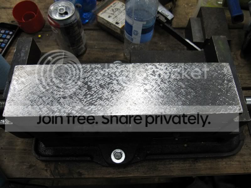

I've done a lot of scraping, both hand scraping and power scraping. This is a prismatic metrology block that I scraped flat and parallel to 50 micro-inches (seriously!)
That said, most scraping is done on gray cast iron, which scrapes beautifully. Unhardened steel doesn't scrape well, and hardened steel (like on machine ways) is a royal PITA, even with a carbide blade on a Biax (power scraper).
Round scraping ("hollows") is often done on bronze or Babbit bearings, but overall, scraping is completely unsuited for knifemaking, IMHO. For one thing, scraping pass removes 2 - 5 tenths on soft gray cast iron. Removing several thou on steel, let alone hardened steel, would take you all afternoon.
I have considered scraping the flats of a blade, for decorative effect. It leaves a shimmering, quasi-holographic sheen. But the scrape marks also have incredible surface area, which is great for oil retention, but it starts rusting as soon as you've scraped it...
