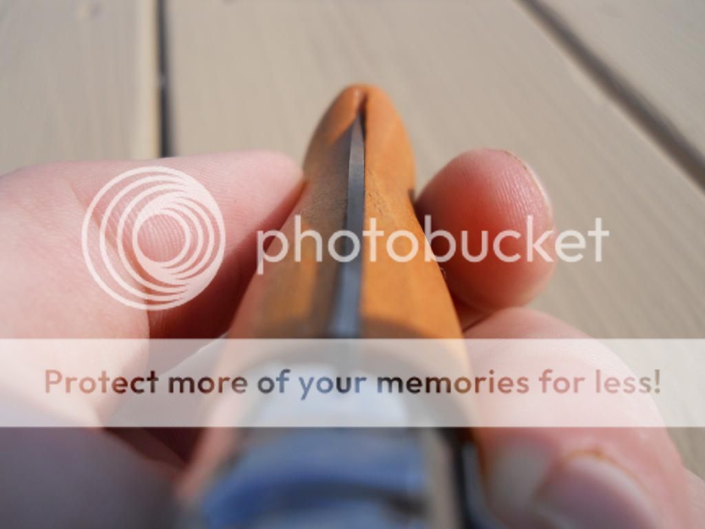

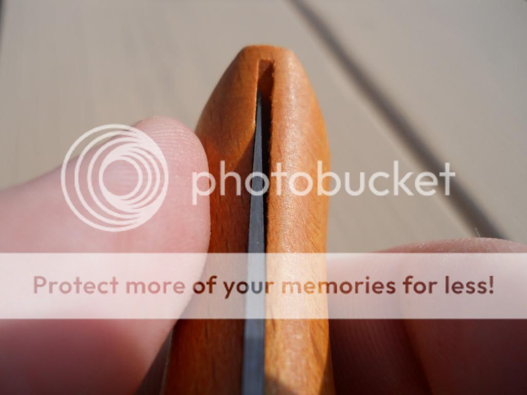

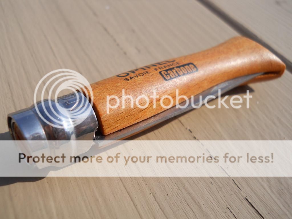

Howdy folks!
Funds are getting tight in the Bladeboss department, so I'm carrying knives I normally dont to keep myself busy. :)
An Opinel No. 6 is one of those knives that never got much love.
I bought it last year and didnt carry it at all because of a very "Nit-Picky issue".
The blade is bent. Not just off center, but bent.
What do you guys think?
Would you:
A-Think its normal
B-Not care anyway and carry it
C-Throw it in a dumpster and buy another one
Any help is appreciated. Ive never owned an Opinel before.

I'd choose B. Use the heck out of it and see if you can kill it. If you can* then buy a new one.
I have a no. 6 and love. Perfect size for EDC.

Hold up there a moment, bladeboss. Don't go tossing it in the trash bin just yet.
First, you won't get any use out of it that way. Total waste of funds. Second, there's no place to return it, so you're kind of stuck with it. This brings us to numb three; which is all of the above are good tbhngs. This is liberating in that you can use the liven' dog poo out of it, and get an idea of what these knives will do and won't do. If it breaks, no big deal, it's been a learning experience.
I'd make sure it was sharp, drop it in pocket and use without any hesitation or restraint. :thumbup:
D-Throw it in an envelope with my name and address on it.
Seriously, just use it. It's an inexpensive tool and the blade being bent a tiny bit doesn't matter.

You ought to be able to tweak that straight merely by gripping it with two pairs of pliers, behind and in front of the bend. Up to you if you want
to put some duct tape on the blade to shield it from the plier jaws.
If it were MY knife? I would clamp it in a vise and straighten it out. It doesn't take much force to do and I hate crooked blades.
I'll probably just use it. I don't want to risk "waffleing" the blade and make it wavy by trying to fix it. I guess it doesn't hurt anything. :)
I'm with Mark. Is it really bent? could also be a pivot pin issue, which could be a bigger deal to fix.

Yeah its bent. It stays the same bent shape all throughout openening. You can see the curve in my first picture.
Is the blade bent, or is it ground incorrectly? Either way, who cares; it's a $10 knife. Use it till it dies, but another one. Repeat.
I have my #6 Carbone in my pocket right now as luck would have it. And looking at it, the blade is bent ever so slightly to the right. Not as much as yours, but there is a very slight curve. I'd chalk it up to a very fine blade moving a little during heat treat. If you wouldn't have posted the picture of yours, I never would have noticed. I don't think it would affect functionality at all. Only thing I could think is it might, might, make it a little trickier to sharpen if you use a flat stone. I use crock-sticks to maintain my knives, so I guess that's why I never noticed. $12 knife. I'd live with it and try with all I could to see at what point the old design would fail me.
Does it cut crooked? If not, what's the problem?
