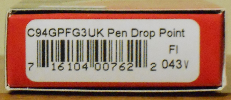

One thing for fakes... look at the bar code, the numbers under the bar code should be touching the bar itself, there should be no space like there is in your picture.
I'm not saying that the OP's Civilian is not a fake, but your "tell" is unreliable....
...the box it the photo above belongs to a CC#d Spyderco, purchased while I had that number (043), from the dealer who serviced my account, so I can say with 100% certainty that it, and the knife it contained are genuine.
