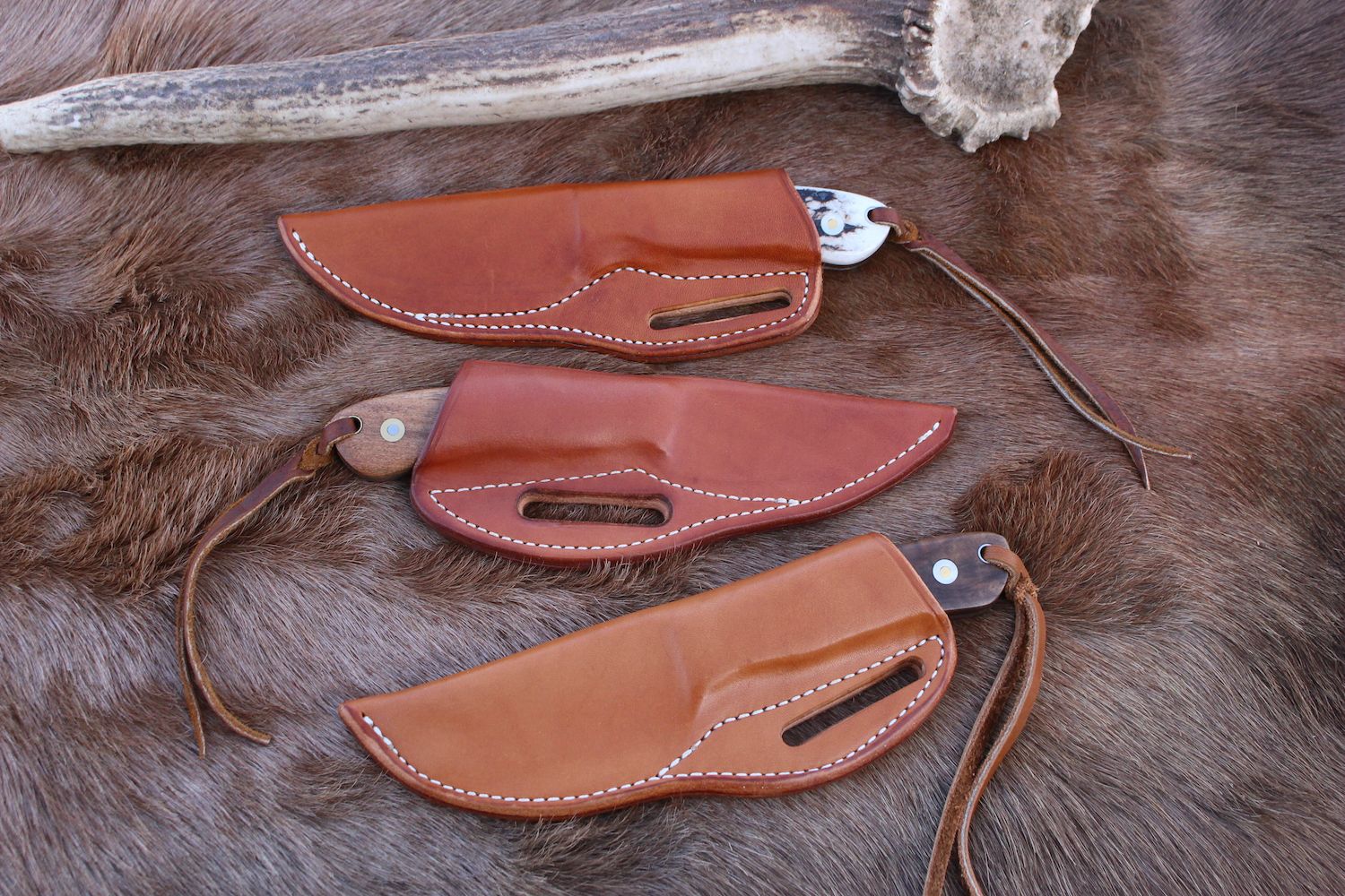

Pretty much....
The knife and sheath are held in place by the pants belt and goes through to hold its position. Like this but picture the belt coming out the loop and over the sheath and back into the pants belt loop:
There are two of my sheath styles represented in that photo. One I call the Slotted sheath and the other the Slot and Loop, they carry different. The only differenece is the Slot and Loop does have a loop on the back side. So Druid is correct on the Slotted sheath it does carry as his pic illustrates.

Neat thing about the Slotted sheath it will go anywhere on your belt. I'd always envisioned it as a crossdraw and we were branding one day. A buddy had come to help and he had moved his Slotted sheath back to behind the right hip due to portliness. Man he was slick getting it in and out of there when neded. So then I had to rethink the whole deal.
