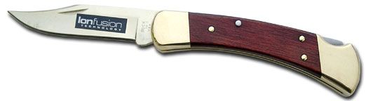

You are talking about IonFusion. It is available on a number of knives, the linerlock that I can think of would be the Crosslock. It is also on the 110, and the Vanguard that I know of.

IonFusion is still available, I know that if you have a 110 made in the custom shop you can get it. I dont know what runs currently have it though.
By carbides, what do you mean?
The TiNi is bonded to the steel. It is chisel ground so tha the cutting edge is comprised of the 420HC steel at 58RC, and the TiNi at around 80RC. Cutting will wear the steel before the coating. Heavy cutting will affect the coating because of the edge configuration.
