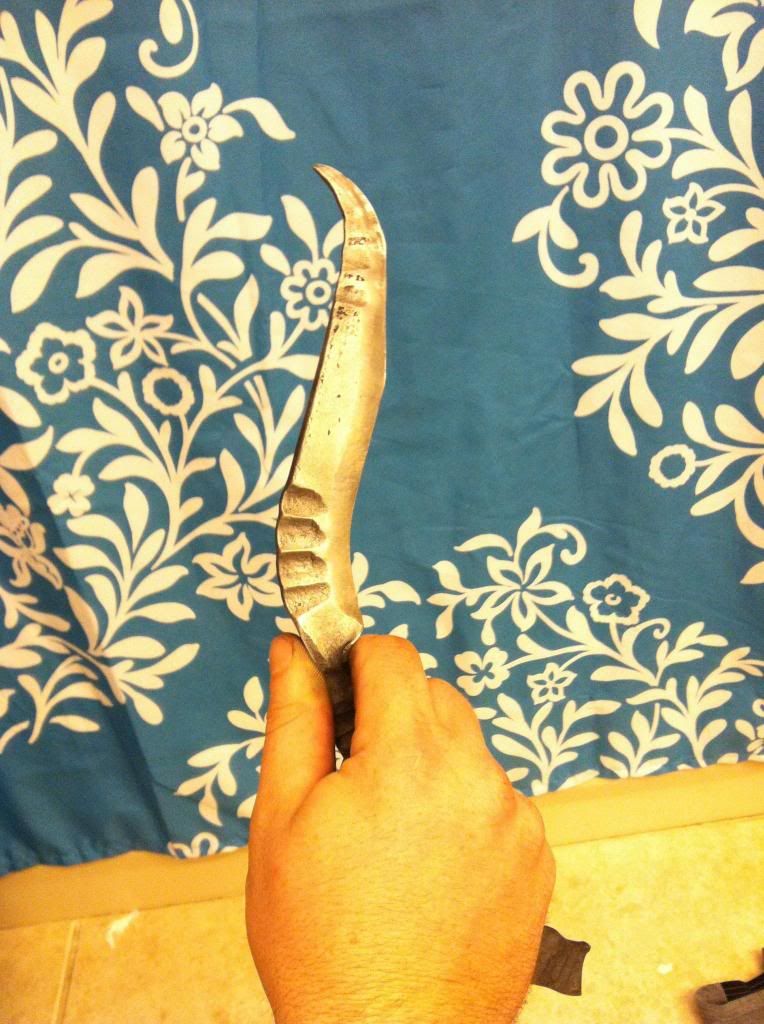

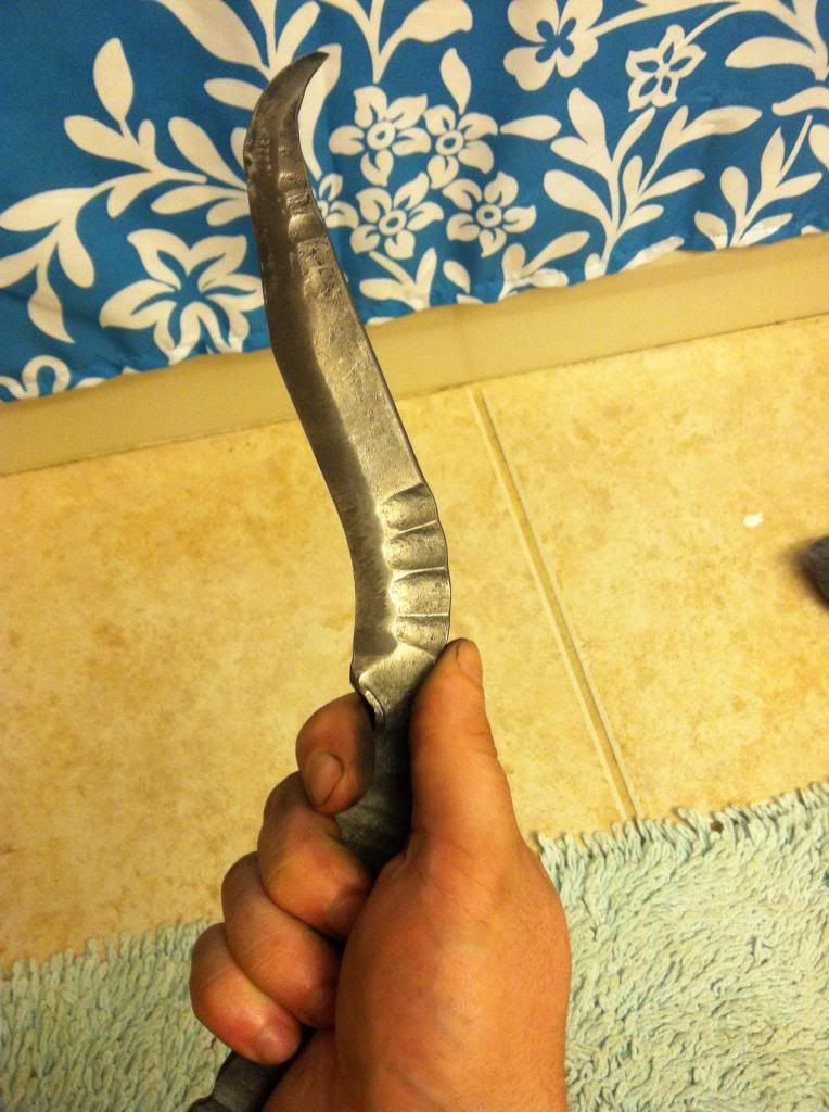

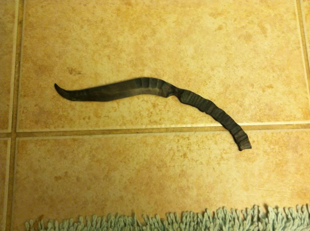

I've recently forged my first 5160 blade. I followed the normalization schedule post forging as follows; heat to nonmagnetic> quench, heat to nonmagnetic> air cool to touch, heat to nonmagnetic- air cool to touch...
Grind; with a flap wheel mind you...
Heat to non-magnetic> quench I had a mix of mineral oil and canola oil @125F.
X2 Temper @ 375F for 2 hours, then cool to touch...
Question;
In my reading/research on 5160, there was some stipulation that stated once it turned black from the oil quench it was safe to quench in water... I understand the severe flaws associated with water quench being a no-go with 5160, as in will most likely "tink"... Obviously that is from the thermal shock of going from critical to -1000F in less than a second... This little stipulation of water-quenching @ black has me thinking all kinds of crazy... Be it that water is more dense than oil, could you "layer" you quench medium? Say a good 4 inches of oil floating atop a few gallons of water?
I hope I'm not speaking crazy as I understand the brine and water quench as being the most stressful quench mediums, but also yielding the hardest result pre temper...?
Nothing spectacular, just freestyle'd it... My first blade; so those taking part aren't bored by a wall of text...
