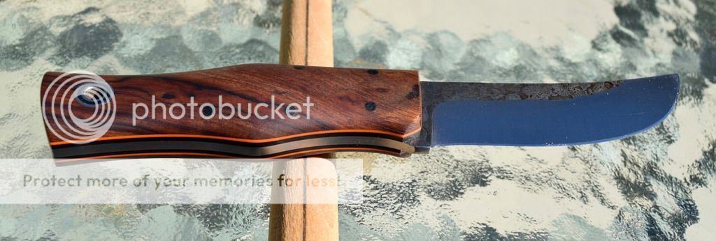

(I am not a huge fan of orange pinstripes, but they do look great with Ironwood.)

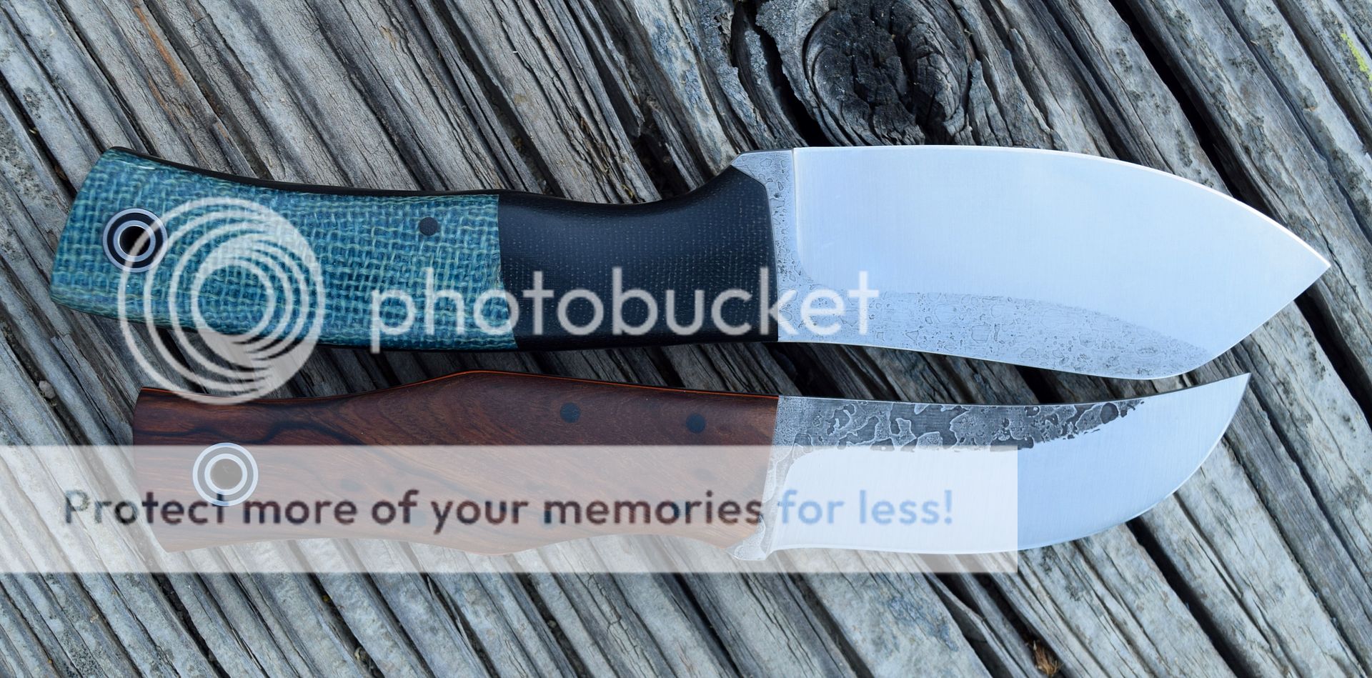

The Maverick handle is taller in the middle and back end vs. the Bushcrafter.

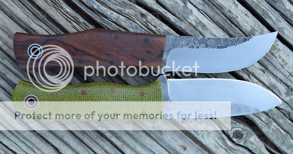

The Maverick handle is slightly longer and taller in the middle than the Sneaky Pete.
The Maverick handle is shorter than the Terassaur, but taller in the front, middle & back. The palm swell on the Maverick sits a little forward of center vs. dead center on the Terrasaur.
The Maverick handle is essentially the same length as the Recluse, but taller in the front, middle & back. The palm swell sits a little forward of center on both knives.
The generous size handle on the Camp Nessie makes it a popular choice for folks with large hands or long fingers. By comparison, the Maverick handle is shorter in length, but taller in the middle.

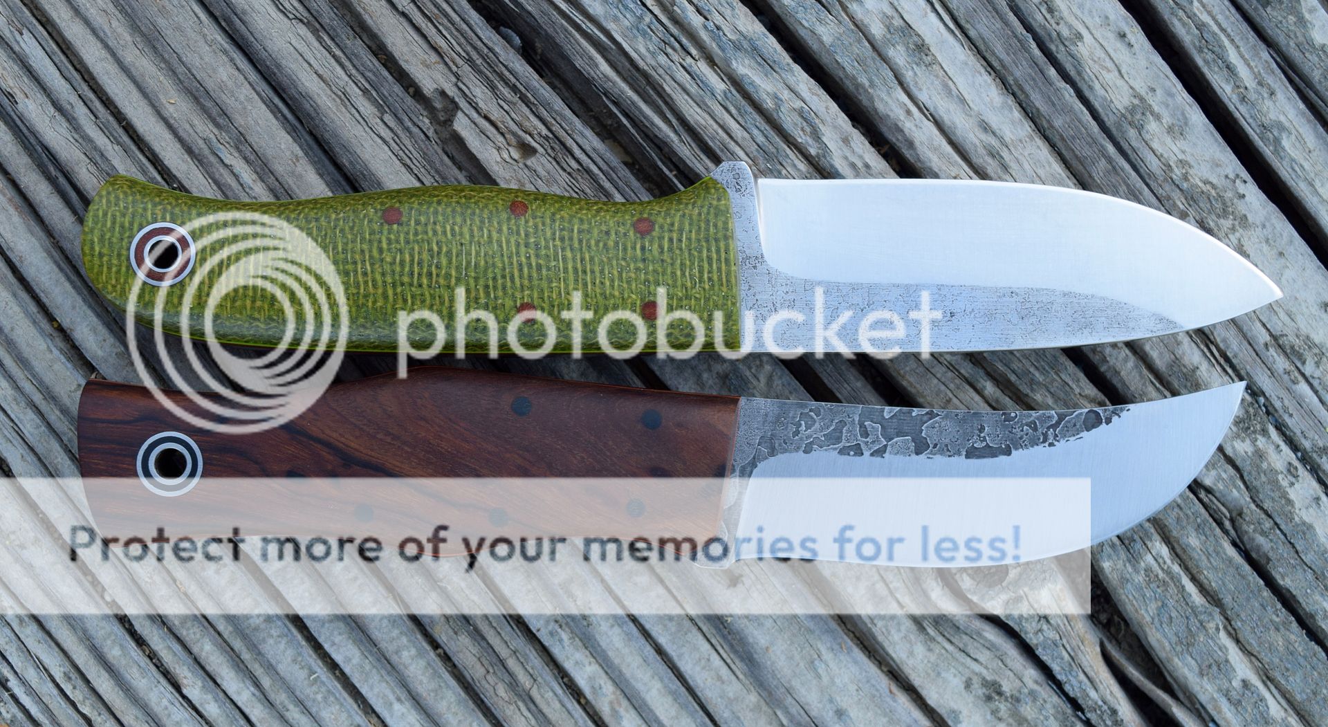

Edge to edge view to compare the bottom of the handles:
The length and shape of the bottom of the handle are important predictors of how comfortable and versatile a knife will be for me. I am pleased to report that the Maverick feels very open and comfortable to me with its shallow “m” curves and a gently curved butt shape that doesn’t shorten the bottom length too much.
Here is a reference photo of the bottom of the handle. This is the measurement that my friend Jim (“joarthur”) calls effective handle length or “EHL.”
The overall shape, length, and palm swell positions on the bottom of the handles are very similar between the Bushcrafter and Maverick.
The bottom of the Maverick’s handle is longer than the Sneaky Pete.
Note the difference in handle length, height, and palm swell positions between the Maverick & Terrasaur.
The Maverick & Recluse share similar bottom handle lengths, shapes, and palm swell positions. The main difference being that the Maverick handle is much taller and beefier feeling due to the top & bottom palm swells.

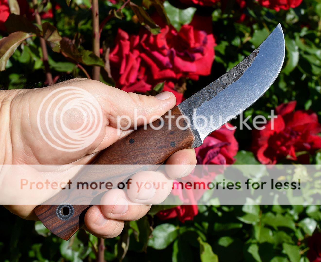

For reference, my hand measures 4” wide across the palm and 6-3/4” from the base of my base to the tip of my middle finger.
The top point of the palm swell rests perfectly in the center of my hand.
The same is true for the bottom of the palm swell.
In the standard hammer grip, the top and bottom middle swells lock in very comfortably between the palm and the middle fingers.
It feels the same in the reverse grip.
Note the gap between my fingertips and palm in a tight chest lever grip. The relatively large circumference of this handle (front to back) should make this model a great option for you folks with long fingers.
The handle remained comfortable to me after sliding back to a lower grip.

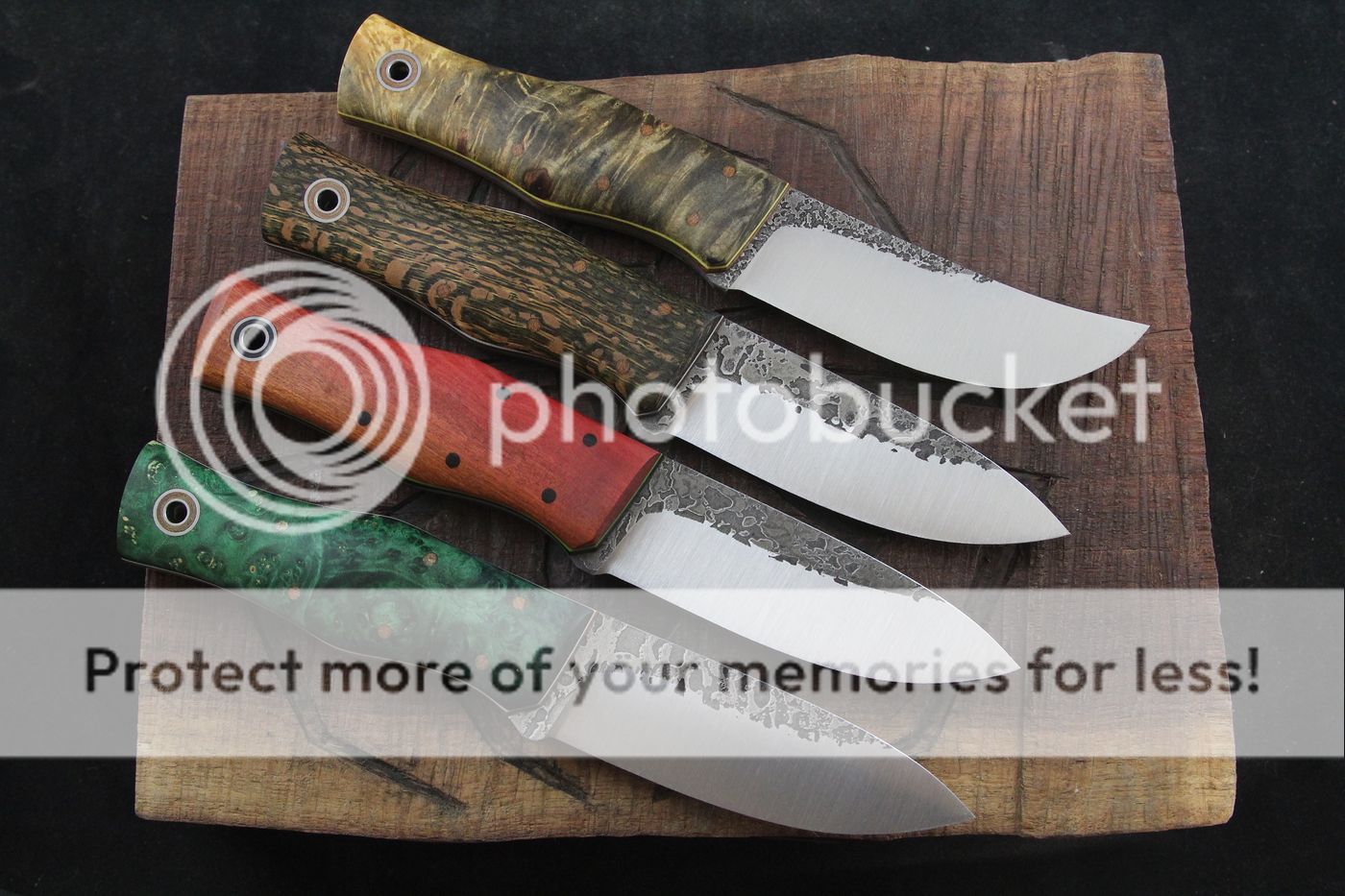

Up to this point, I have not talked about the blade design at all. Trailing point blades are generally not my thing. I see them as a specialty blade primarily intended for hunters to process game animals. While I wouldn’t hesitate to recommend this model to hunters, that is a smaller niche market in our increasingly urbanized society. Luckily for the rest of us, Andy offers a variation of this model called the Drop Point Maverick or “DPM” for short. The DPM has the same handle with more of a bushcrafter-type spear point blade. I think that variation will prove the more popular of the two.
Here is one of VANCE’s photos showing both variations.
Getting back to the handle design, I will admit that my original skepticism has been replaced by a new respect for this model. It is hand-filling, secure feeling, and comfortable in a number of grips. I think the inherently larger grip will appeal to a number of buyers who want or need a larger circumference handle.
