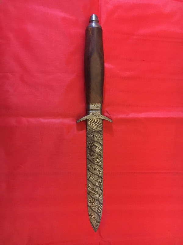

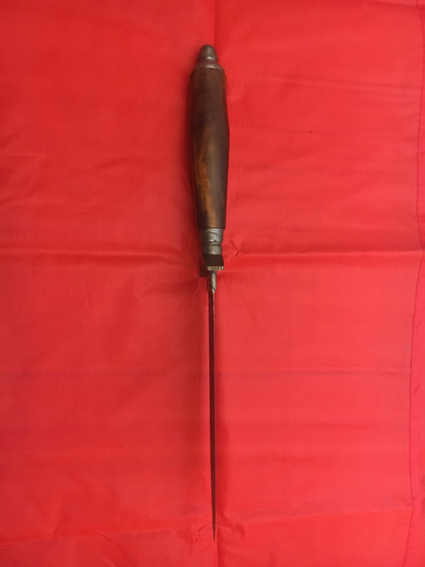

This is a replica of a knife a friend carried in Vietnam and Iraq, a Gerber Mark II. I didn't want to make an exact copy, so he let me add my own twists to it.

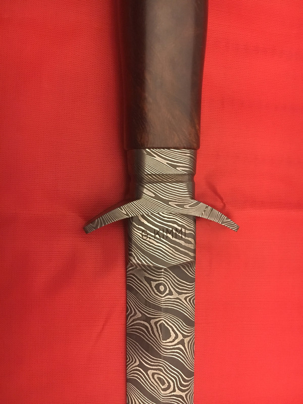

The blade is 39 layers of 1084 and 15N20 that has been twisted. I forged to shape, then ground the bevels in to not distort the pattern. It was etched in ferric chloride then strong instant coffee.

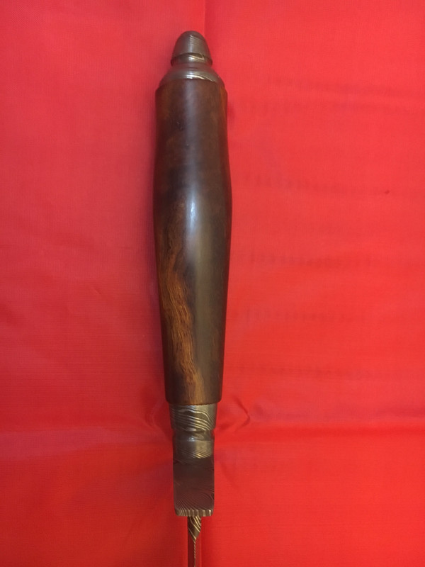

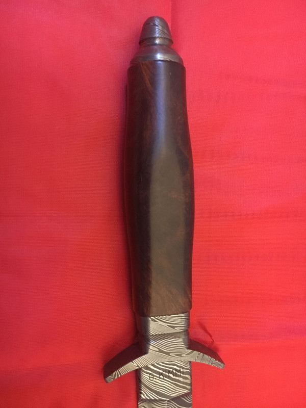

The guard and pommel were forged from a 55 layer billet that was also twisted. They both have a filed flute.
The handle is desert ironwood burl.
Thanks for looking!

Very nice! The way the pattern lines up at the guard, it almost looks integral:thumbsup:

Thanks everyone. This knife was a big challenge with a lot of firsts for me. First dagger, first threaded pommel, first time I've fluted anything, and this is the 2nd guard I've made from scratch. Hopefully, this will be the last damascus I make by hand. I've got a Coal Iron Works press ordered that should be here this month.
