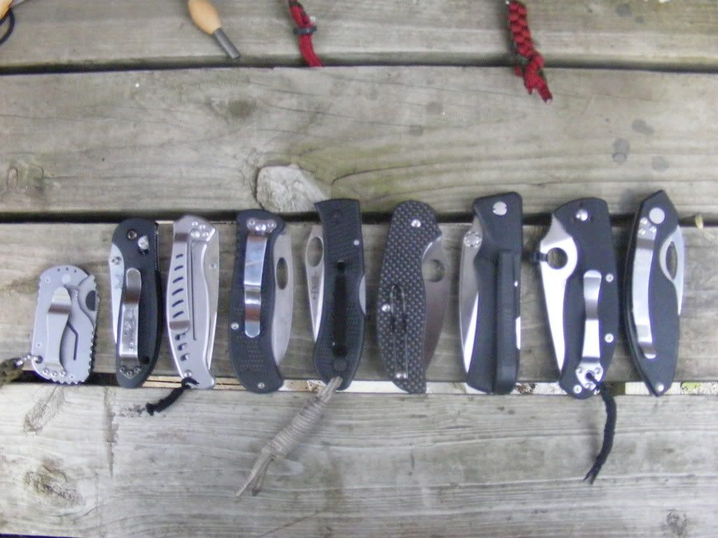

I thought it would be good to show my EDC blades, and to compare them side-by-side to see what's what and what's the best for my tasks. These aren't full reviews, but I've provided them where available. Maybe you have some of these and would like to give your impressions.
CRKT Edgie Model 6442, China-made, self-sharpening knife. It costs between $15 and $25. Blade is 2-7/8" long and made of 420J2 stainless. It has a sheepsfoot shape and a thumb oval. It's sharpened on one side only; a chisel grind. No lock; it's a slipjoint. The knife is 4-1/8" closed and has stainless steel liners under black Zytel handles. A stainless steel pocket clip is mounted in the right-hand tip-down position, and is removable but not reversible. The self-sharpening mechanism produces a rough burr that won't cut anything finer than cardboard. I really dislike this knife, and it's now my loaner. Avoid it if you can.
