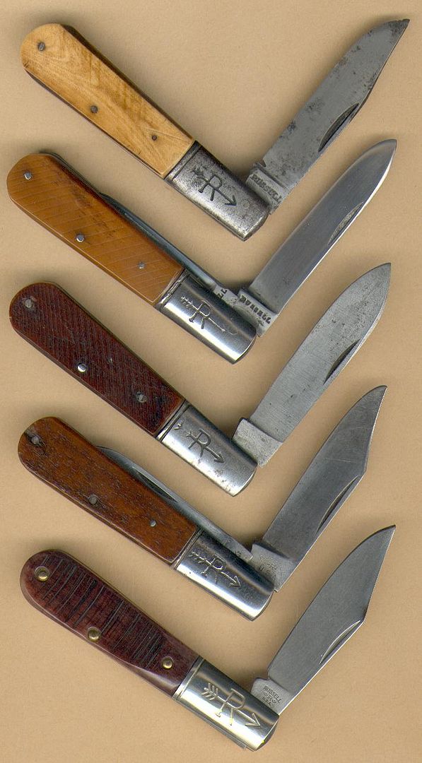

I would look for a better one, IIWY. You will be disappointed in coming years, when you find a better one for less money.
Someone has polished the handle down. You want to find better blades, and a more original handle condition. You can then appreciate what the original knife was from the factory.
These old Russells all cost less than you suggest. They just took hunting and perseverence.
(The bottom one is a modern reproduction.)
Waynorth thank you for that sound advice. I passed on the other. Thanks for pointing out the handles. I am trying to develop that eye of discernment that only comes with time and knowledge. Unfortunately, I have spent my knife budget this month. I need to learn more before buying like that. Thanks again
Hey Charlie I know old topic and old pic but I just picked up a Russell, looks like the bottom one in your pic with the tang markings to match, is that carbon steel? Or stainless
Don't know if it's carbon. Give it a good dab with warm cider vinegar and let it sit up to an hour. Wash any oil off first. It'll clean off later but it will tell you!
