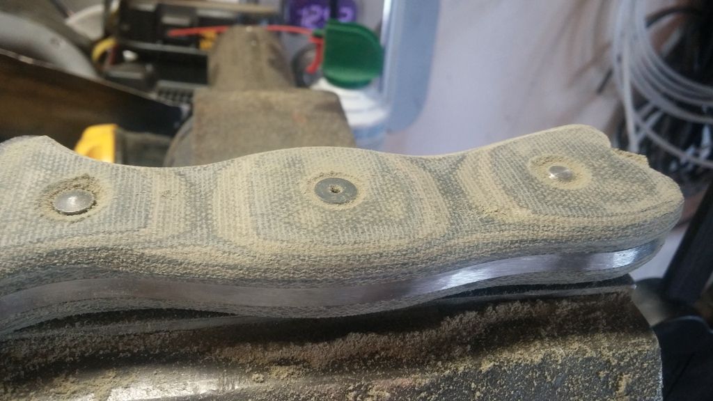

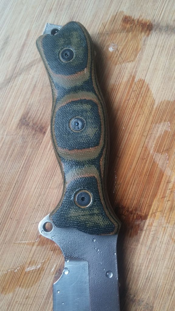

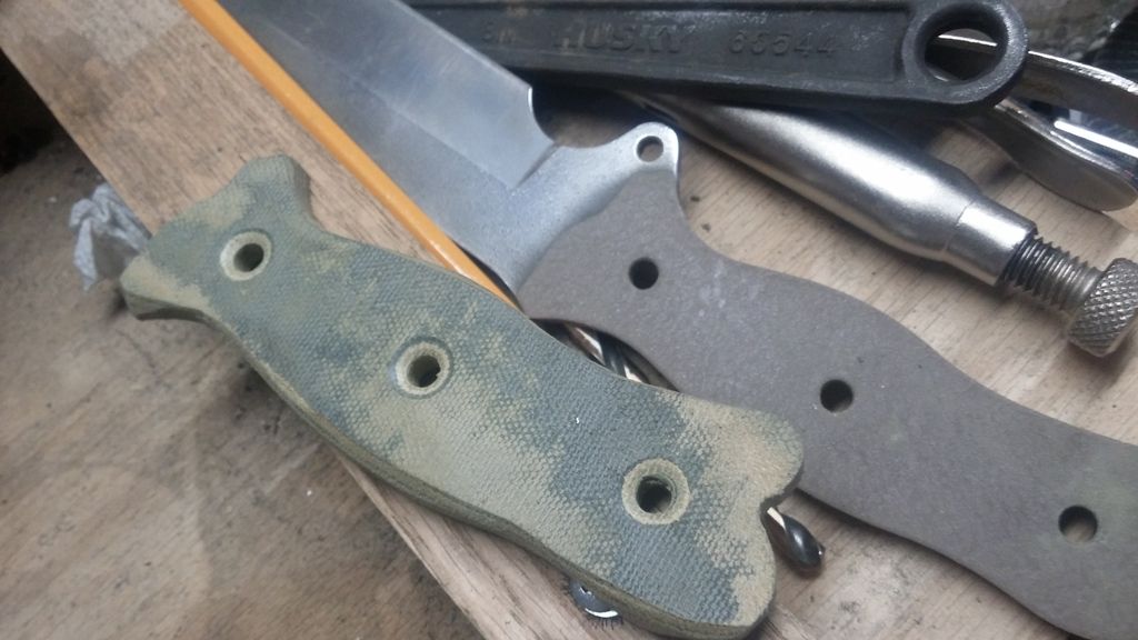

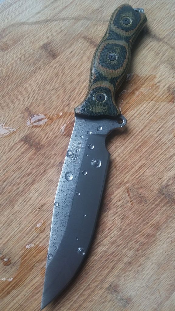

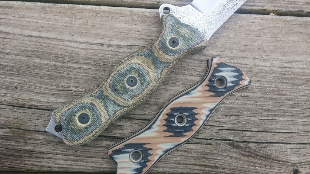

My Axe needed new scales.... :)! The Axe Hammer is one of my favorite all around user blade however, it only come with G10 handles. So this Memorial day weekend I set out to rescale my beast! When it's all said and done it will have red liners and tube fasteners. Let me know what you guys think.
Micarta just has a much warmer feel to it. I wish Busse would do more multi color, layered micarta.
I'll let the pictures do the talking. This is before:
After cutout and initial sanding:
Taking shape:
Just about done:
Dry glamour shot:
Before and after:
Ahhhh...
