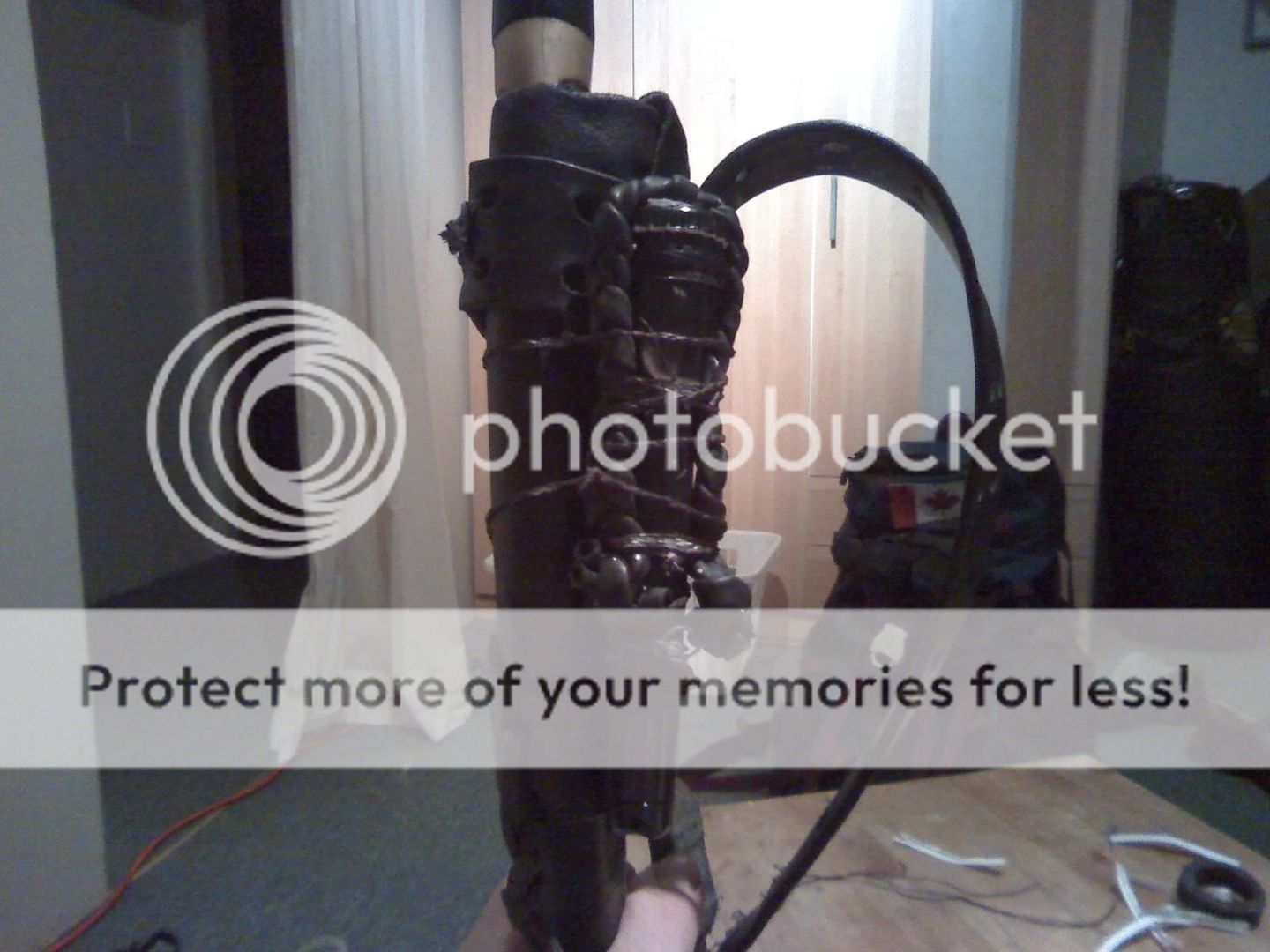

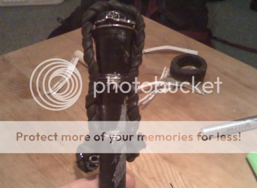

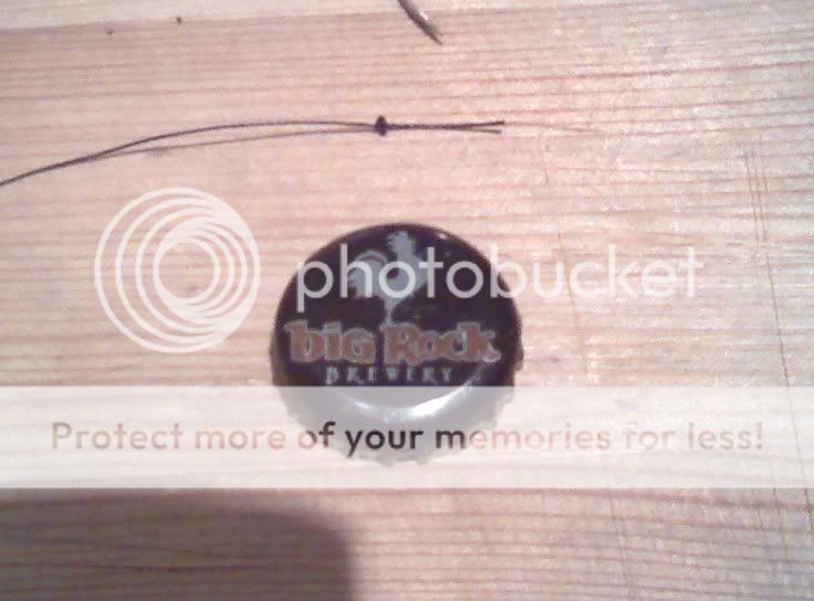

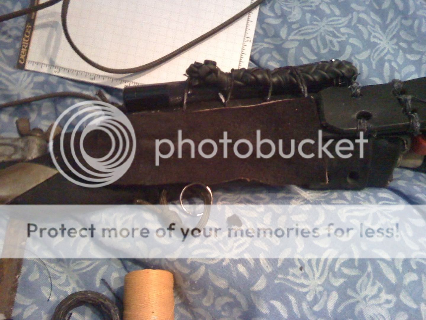

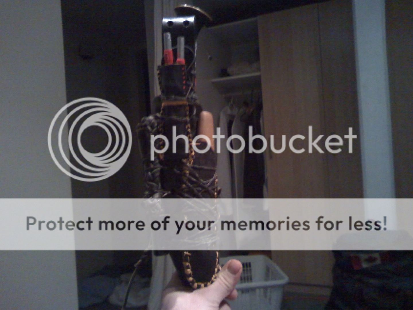

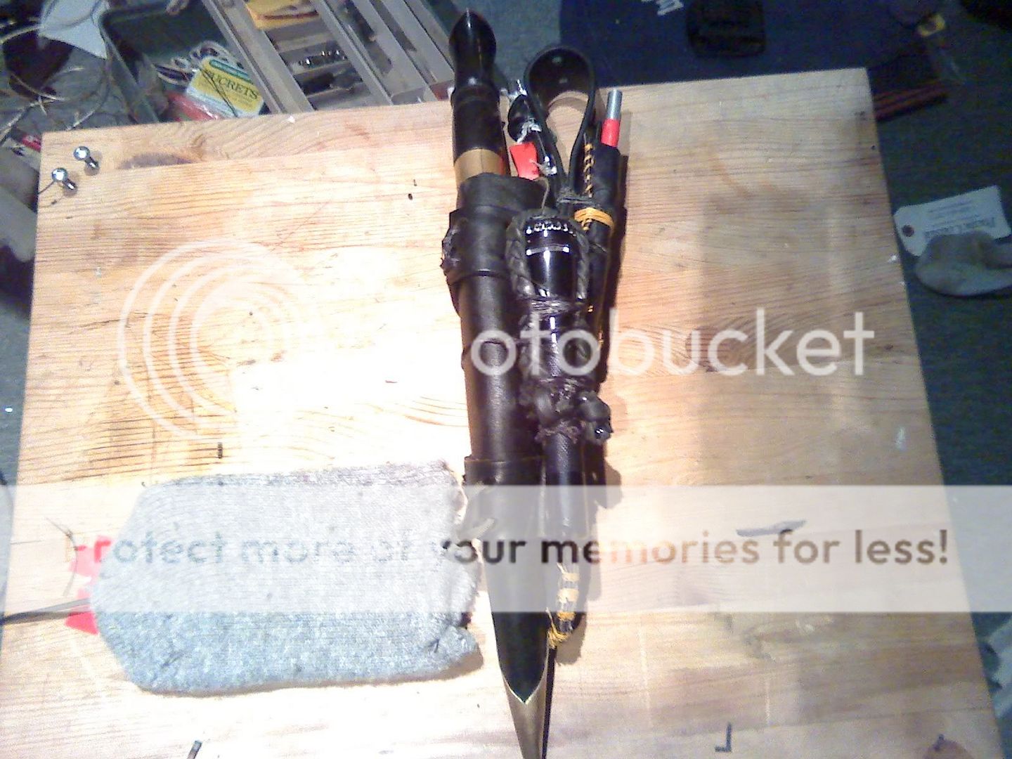

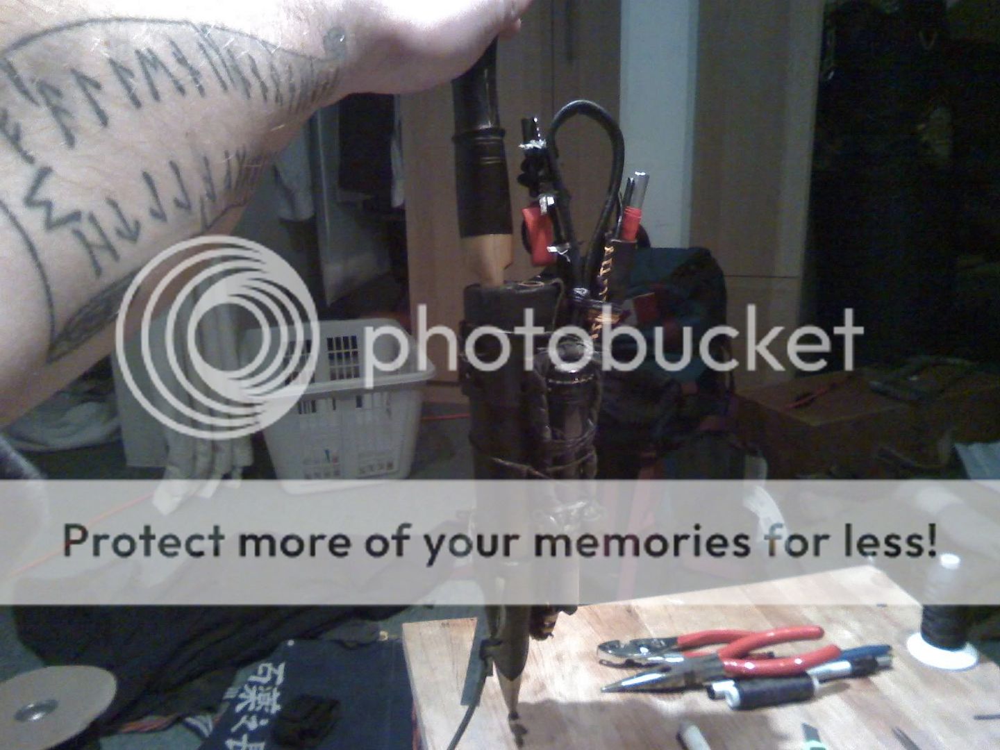

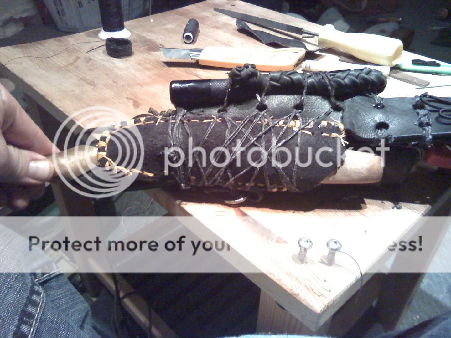

to start, the mini mag light. it has good batteries, with a beer bottle cap on top to protect and seal off the lense. held on with a dab of hot glue. a wingspan worth of ballistic nylon, tailed hot glued on top, the rest wrapped below the car, prethreaded onto the mortitions needle, which fit s almost perfectly around the flashlight. i braided the surgical tube wrapped it over the end and whipped it onto the flash light. i lashed it onto the sheath, as this will only be used in an emergency, four cuts and it falls off, and stays contained.

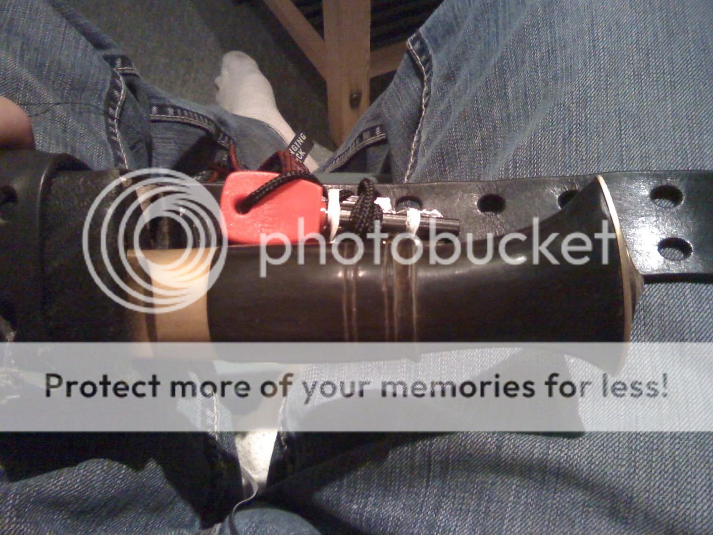

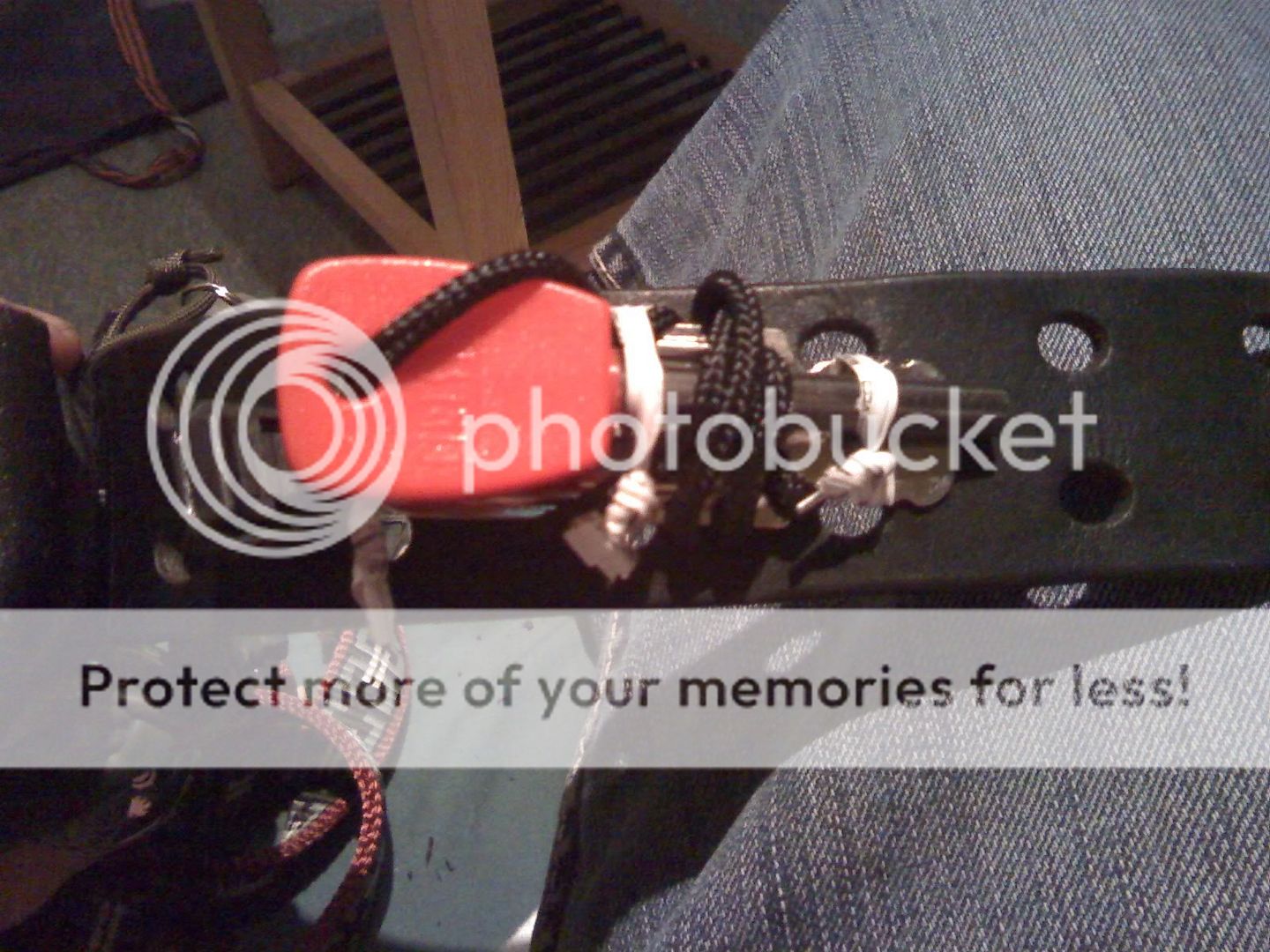

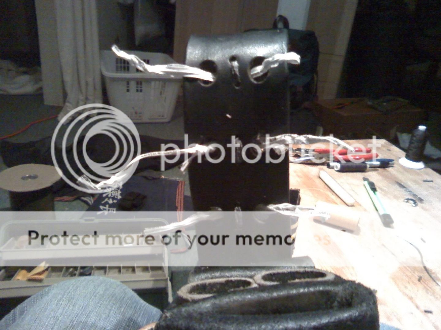

my fire steel is attached using the garbage bag ties, which are whipped and fletch tited onto the belt to keep them from falling off.

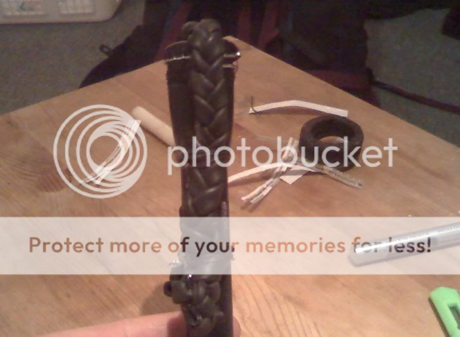

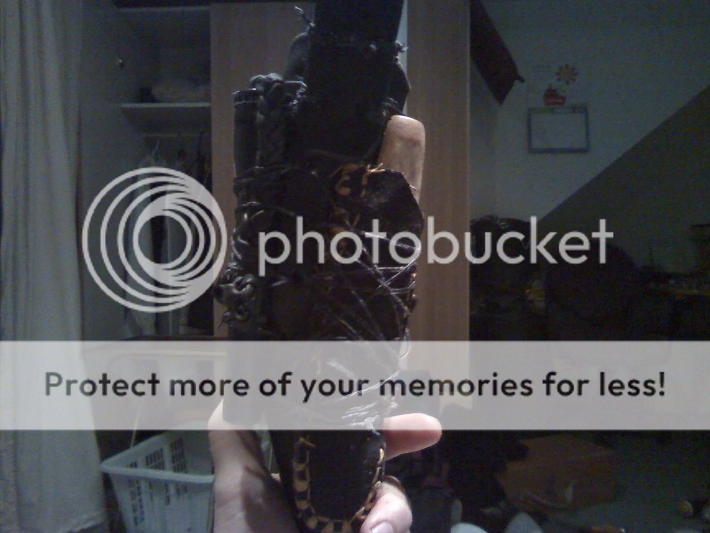

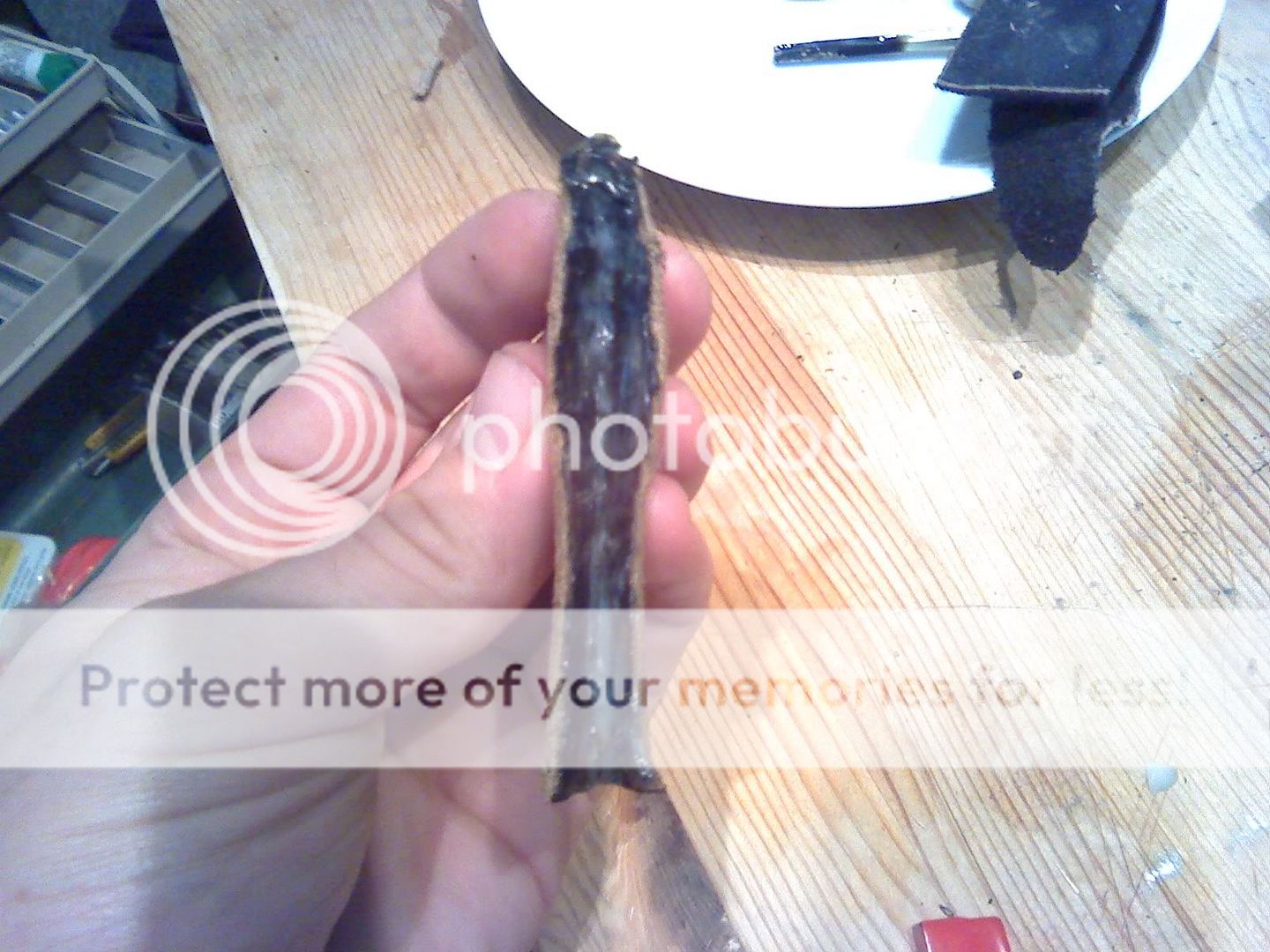

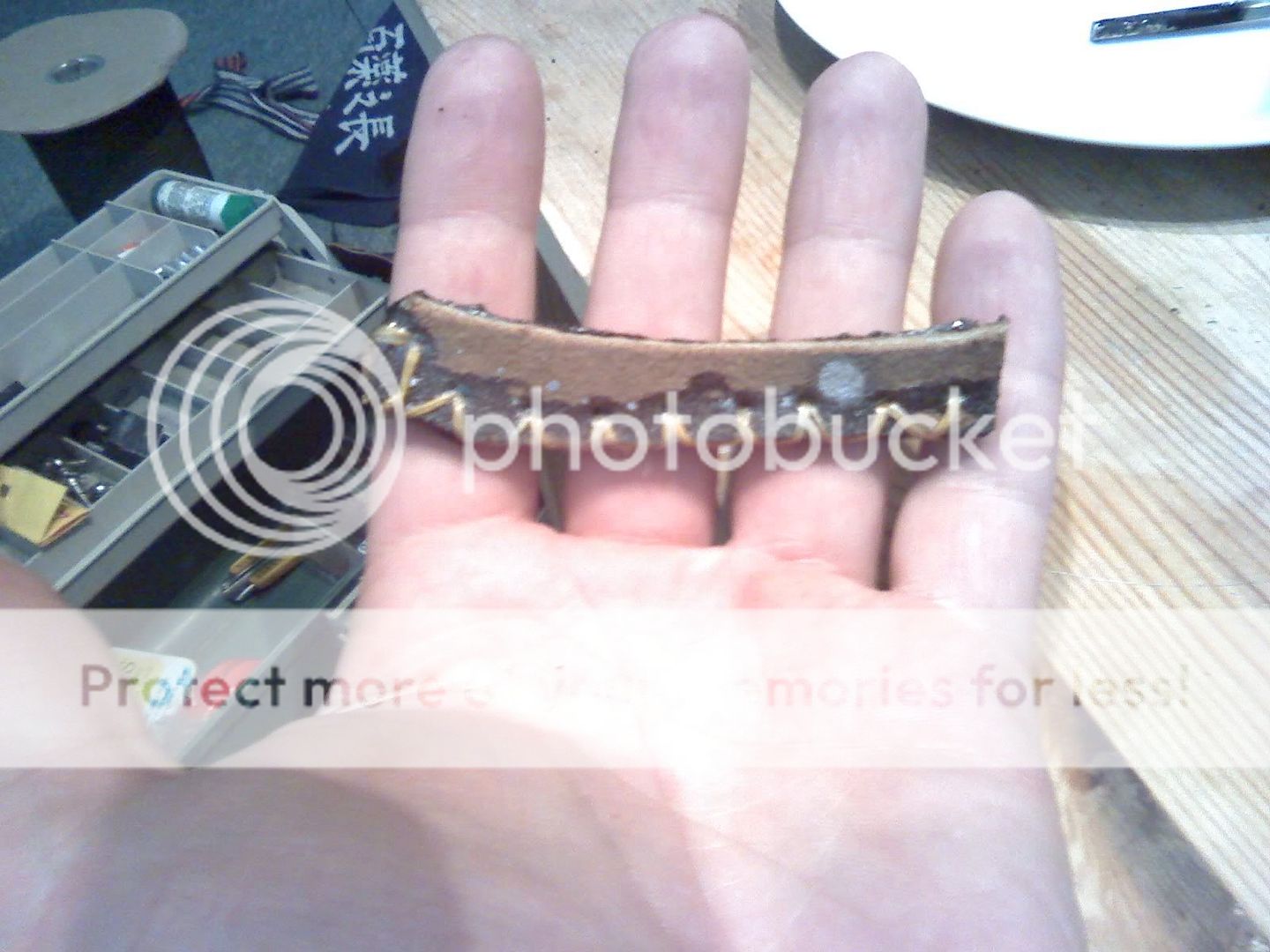

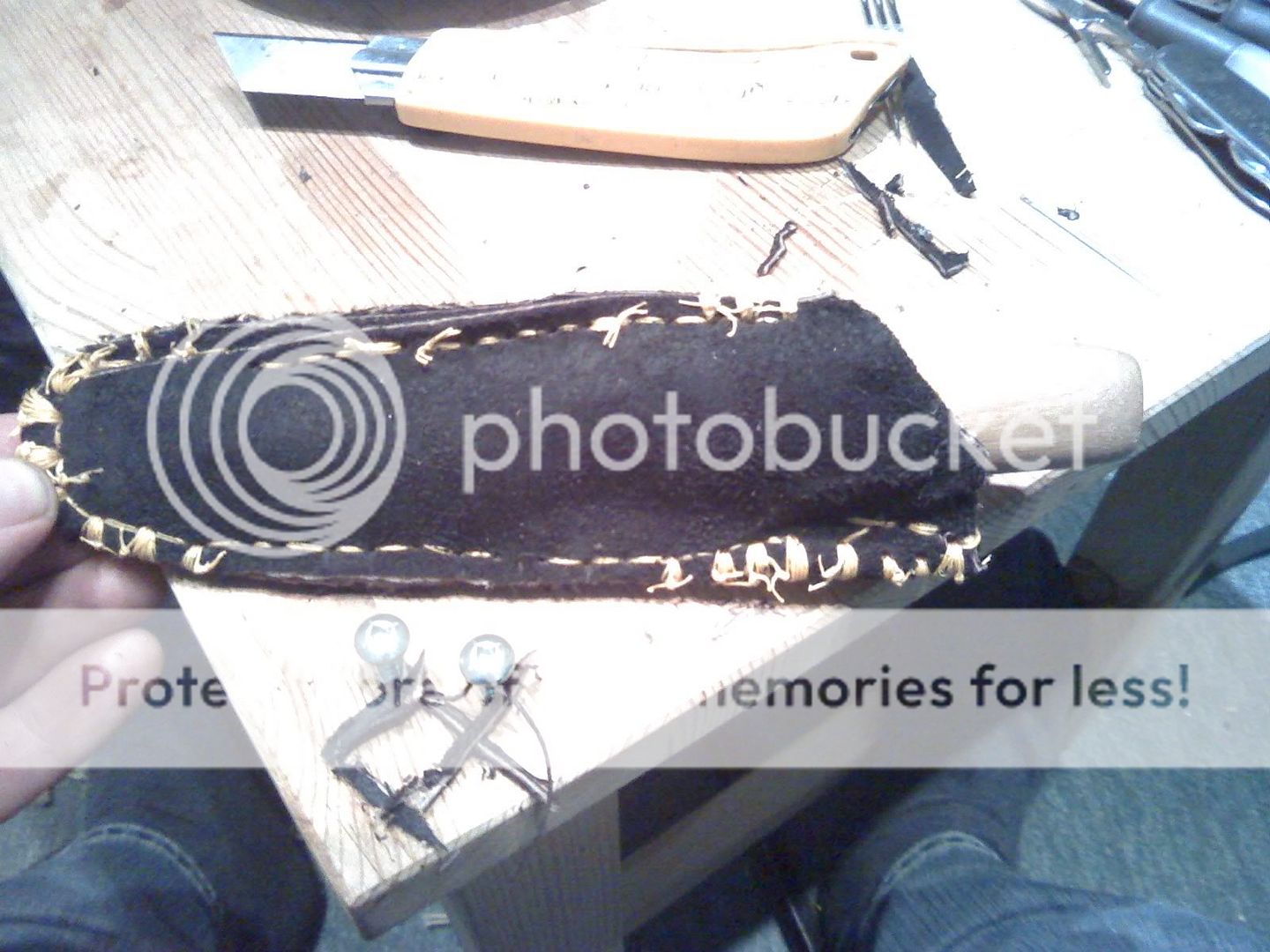

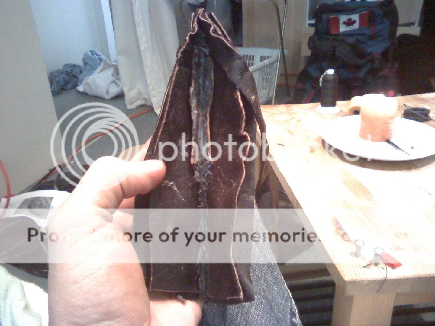

the small knife was originally going to get a carved rubber sheath, but it was a little dangerous working the rubber, and treating this as a survival situation, did not want to hurt myself. if i cut up the new belts my gf fot my, i would not survive either, so , the leaky goose got cooked. i put some time into the sheath, five layers with the knive outline cut out of the center one. i made a 'canoe' with no tail, flethc tited the threads, then sealed the inside with hot glue. i stitched the bottom and front, tucked the knive inside and stitched the top. i also whipped the stress points on the sheath as well, and lashed it to the harness using holes in the belt.

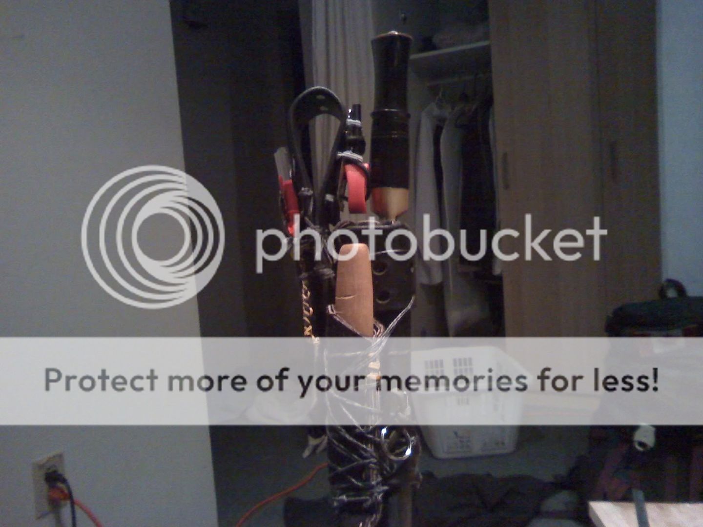

i made a pouch for the aluminum handles and the bow string on the back, and whipped it on.

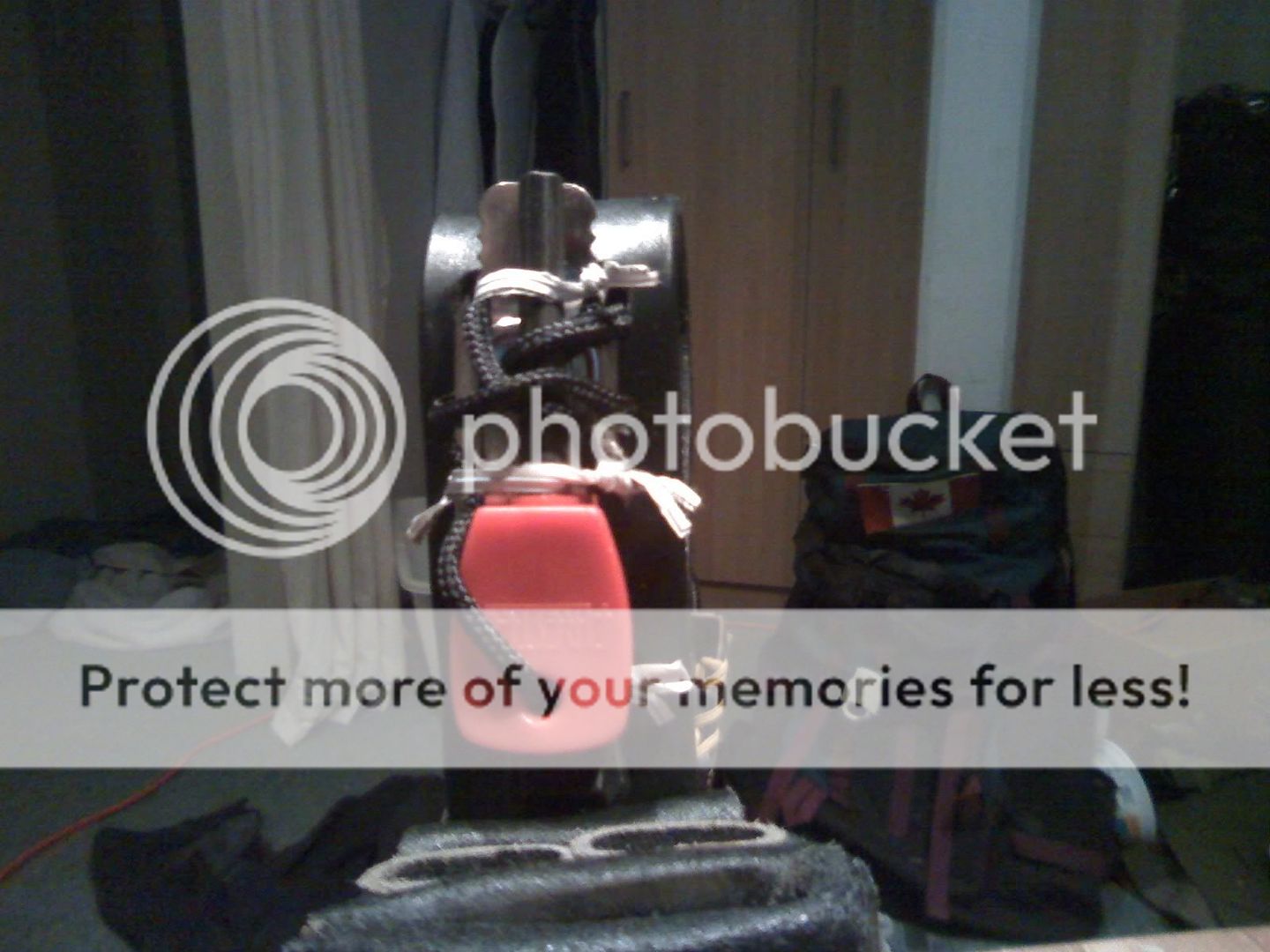

to spread the weight out, i used the bottom of the tupperware container and ran my leg strap through for comfort.
it is not the prettiest thing, but, it is what i came up with, it would have brought a tool back into order, and it would have gave me time to see what is happening out there.
