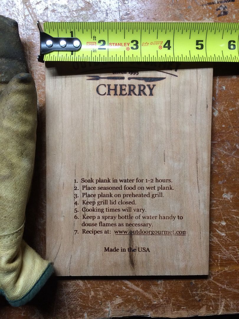

Cooking boards can do if you find them cheap:
You can choose your flavor as well - poplar, cherry, alder, etc.
I'll second making your own and Agent_H's comments about cutting/cooking boards. Sometimes you can also go to your local lumbar yard or building supply and they will let you pick through the ends & trash heap.
