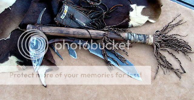

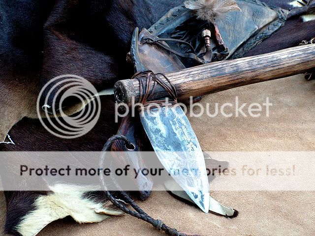

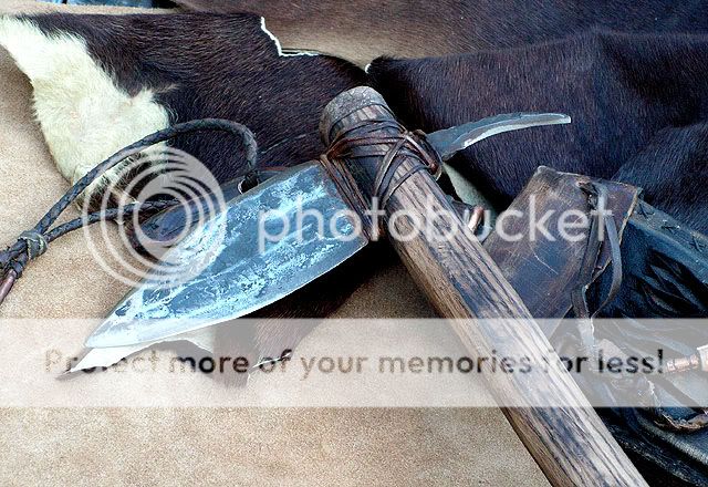

Spontoon’s are pure weapons, I can’t think of any other practical uses, although later
they were used as ceremonial ‘hawks. This thing is SCARY. 9 and 1/2″ across from the
point to the “belly ripper” sharpened spike.

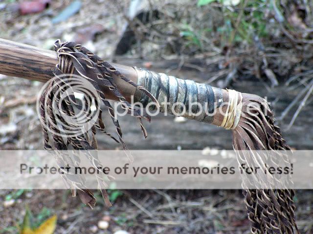

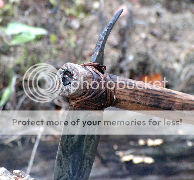

Forged from a at least 100 yr. old plow point on charcoal , hot cut, hot filed, quenched in brine
water, all hand work. Haft is 20″ Oak split from firewood, drawknifed, oiled and toasted. No dye.
The head is burned threw in the old Celtic way, stuffed with pine pitch glue and wrapped with rawhide. The hand grip is garment
leather from a bag and wrapped with deer rawhide.
I'm stitching on a rawhide/fringed blade cover now.
This is my first weapon that I can’t call a tool of some sort and I’m kinda on the fence as to make
more but it was a fun and a very unusual experience…..Randy
