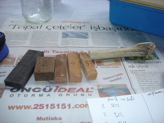

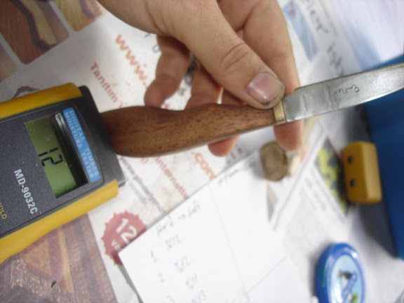

I found a pound of silica gel my mom uses to dry flowers. It is non toxic blue indicator type of silica (I guess it has cobalt oxides in it).
To test the effect of it I selected 5 different undried woods. These found in a carpenter scraps pile. First is the ebony (or maybe African Blackwood), then another hard wood, it goes softer and softer to the 5th sample - the softest (I dont know their wood types), tested with a hygrometer I bought for 80$ recently. I also added an antler piece to test...
Pics are surface readings:

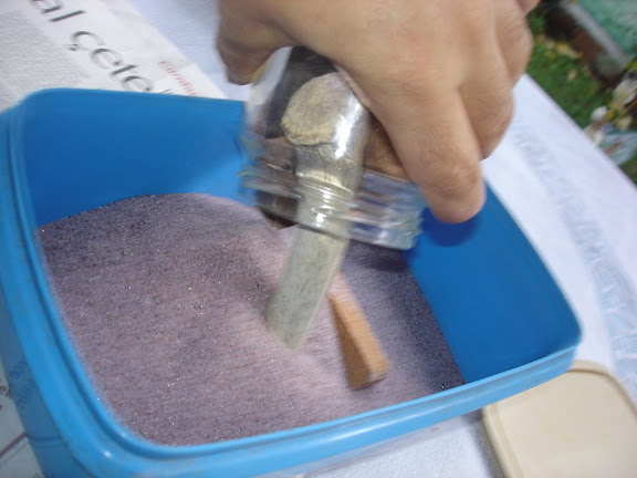

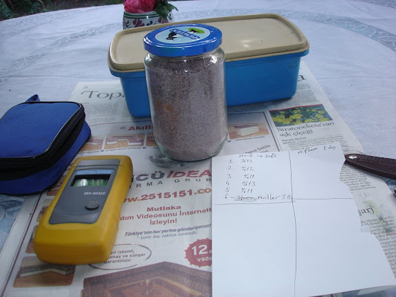

Then I put the samples in a jar and covered under silica gel.
Lets hope we can gain some experience here :rolleyes::D
I'll check&update the daily readings and also I'll bake the silica everyday to keep it dry...
Here is the initial readings:
#1 - Ebony : 12%
#2 - Another hardwood - a little bit softer than sample 1 but more oily wood - 12 %
#3 - Medium hard - softer than #2 - 11%
#4 - Soft wood - 13%
#5 - Very soft, light wood - 11%
#6 - Antler - 11% (I'm afraid to test moisture of antler with this gadget is nonsense but here we go :))
I guess if samples were known wood types it would be much more beneficial but all the handle material I have is dried...
Other than that I would appreciate the recommendations and comments on this test...

A quick update:
After 1 hour silica quickly sucks the moisture from wood pieces. The color change is matching the pieces :
I had to shake the jar because the silica particles around the pieces were almost filled up with moisture (turned to pink in color)...

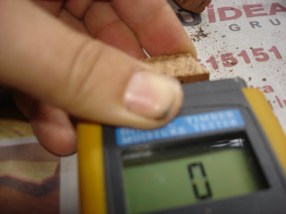

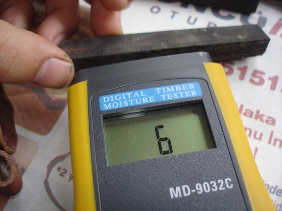

I decided to finish the test now. After 18 Hours lets see if they are dried good?
Here is our samples, sit for 18 hours in silica gel:

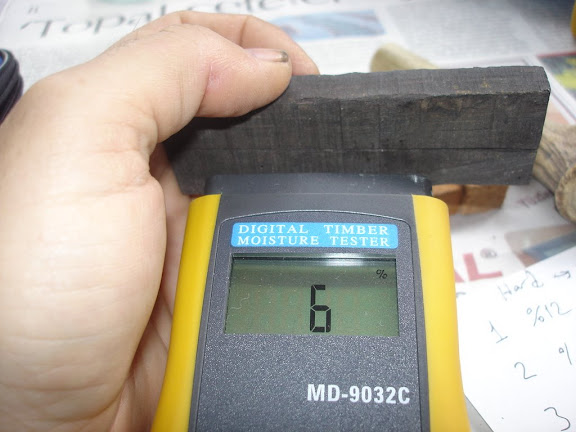

First lets measure the surface of the sample #1- ebony , Remember the surface measurement was 12%;
Now it is 6%. I measure from everywhere on the scale and I post the maximum reading...

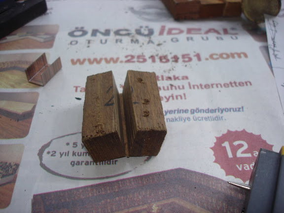

There was a crack on the ebony originally, I broke that scale length-wise and did some test at the core:
Wow it has dried to the core... Ok that was ebony, not so oily and scale was thin (about : 0.3")...

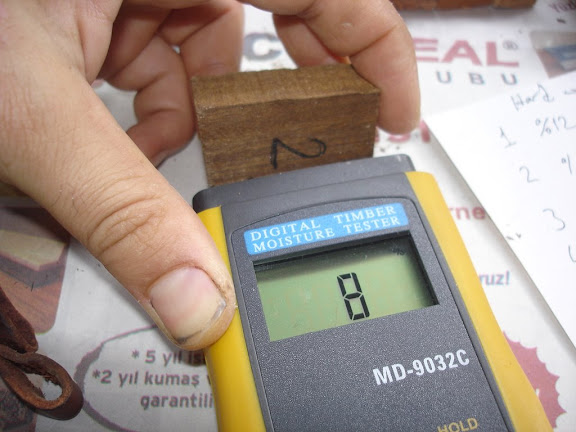

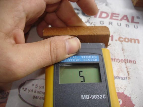

Lets look to sample #2. This is oily and hard wood, I'll ask what is it to the carpenter but the structure is similar to rosewood... The initial surface reading was %12 as ebony:
It is now dry enough to use, but since it is thick (1/2") and oily I suspect the core wasn't dried enough. Lets cut it then :D :
And the core test:
Dried all the way.

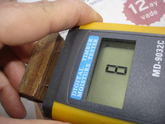

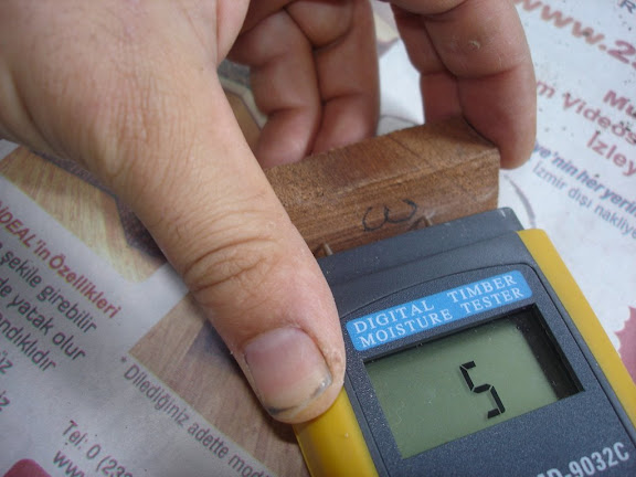

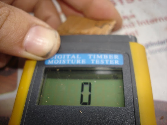

Lets continue to the sample #3, initially it was 11%:
http://lh5.ggpht.com/_VE2vabU9iTc/SR7BfsCkrPI/AAAAAAAAA9A/Zq0khxjWUHg/s576/DSC02033.JPG
Softer wood dried better normally:
And I couldnt manage to read any moisture at the core of that .3" thick soft wood...

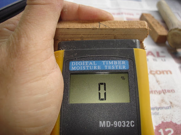

The #4 was 13% before going in the silica. Now it is:
And the core :
No reading available....

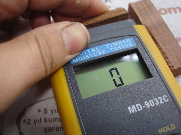

#5 was very soft - light wood initially 11%. I wasnt able to read any moisture in it after drying:
Core:
I was afraid the tester was broke, I tested my shop knife handle :D
Ok, it is working as I didnt dry that wood at all...

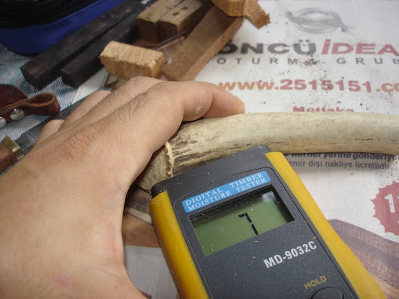

Lets look to antler (initially 11%):
In conclusion:
Silica gel is very quick and possibly a reliable way to dry our scales. I'll repeat the test for known woods and they will be scales and bowie blocks. I'm waiting for my 3 pound silica order to arrive, a pound costs only 5$ :thumbup:
Hope you enjoyed my unreliable test :p I enjoyed a lot...
